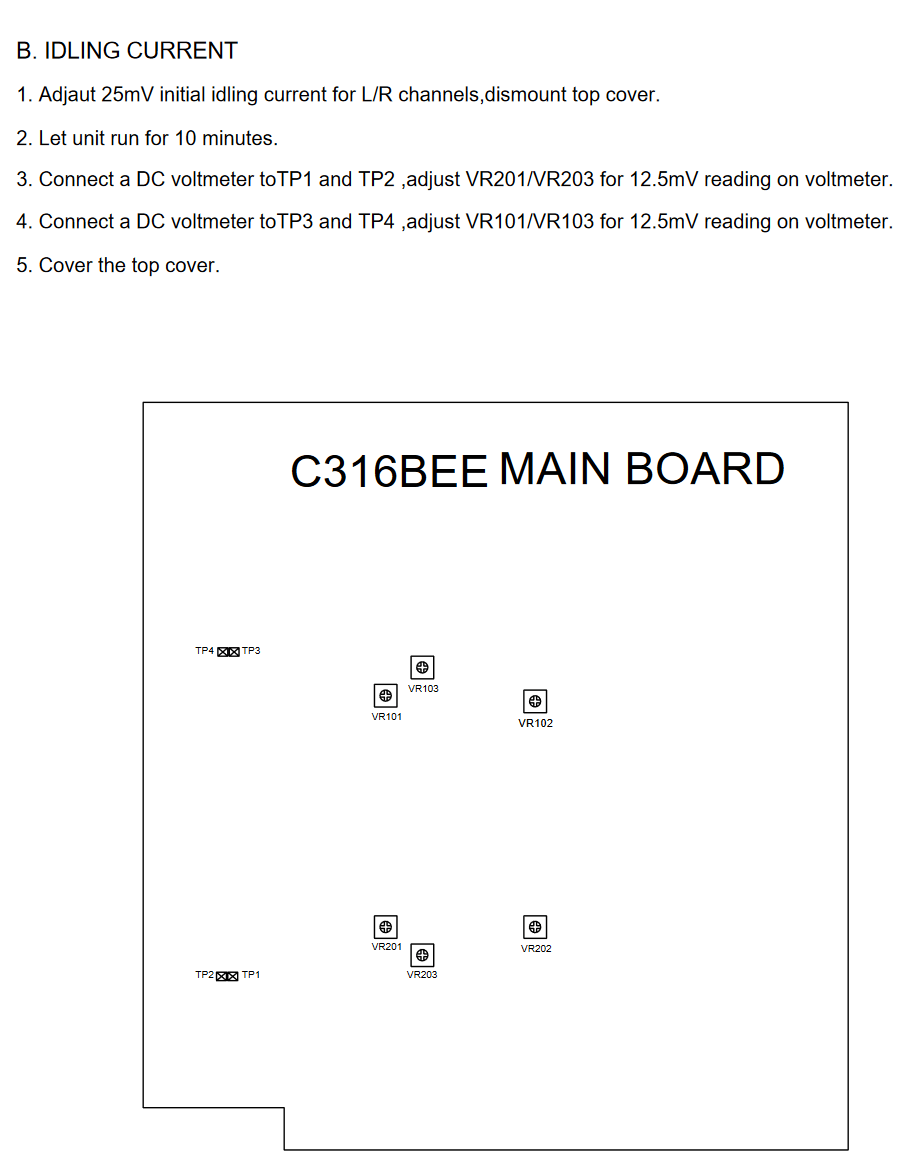

But before you close the case there's still the simple matter of checking the idle current (and adjusting if necessary).

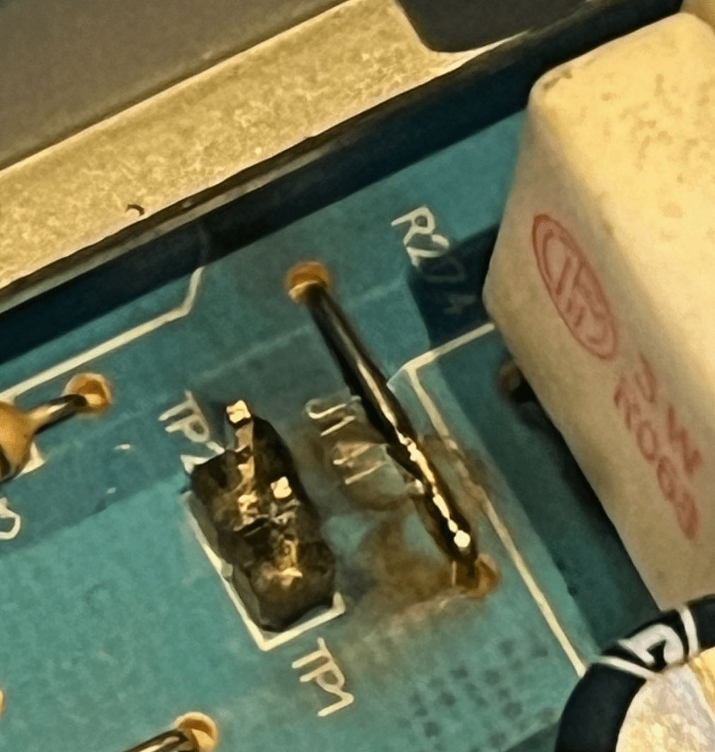

Well that was as fun as a kick in the ****. I managed the blow the Jumper wire next to TP1/2. Now the AMP in down and out. So I now need to replace that.
However, I did take some readings before it went. TP1 - TP2 was reading around 5mV and TP3 - TP4 was reading around 7 so they certainly need some adjusting once I replace the wire.

Yep I was assuming the same thing.
I’ll replace it and then see if it’s still not working and go from there.
Looking at these jumper wires I see that there are different thicknesses. Is there a way of telling what voltage wire I need? I can’t see it from the part number.
For now, I wouldn't worry too much about the thickness, you have some fault finding to do. For that you could bridge the gap in the jumper wire with a bit of excess lead from a new resistor soldered on, if its actually burnt through, in the photo it doesn't look like it is, but I can't be sure.
What happened? Did you slip with the meterprobe?
You could already go ahead and measure some parts in the circuit around TP1 like you did the in the beginning of this thread and get an idea of the consequential damage that short caused.
Ye thats correct, one of the probes slipped off the T1 part and onto the jumper. Nice bang and a white spark. So now the amp wont turn on.
I gave the area around the jumper a little clean with a dry ear bud and there is certainly some damage to the jumper. Not sure if its snapped. I will remove it anyway and replace with resistor wire as you suggest.

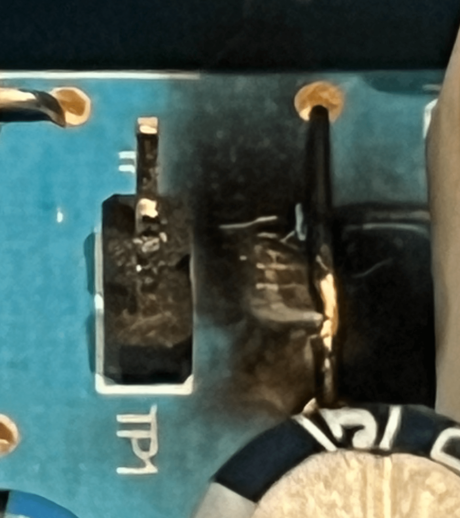

Case NOT closed.

Have now changed the fuse. Also changed the jumper wire to some resistor wire. The original wire hadnt broken all the way through but the mild explosion had eaten into it
But anyhow, so the amp now powers on to standby mode (orange light) from the rear mains switch. To turn it on one needs to press the standby button on the front. When this is pressed, it flicks to the TUNER (blue light) but then back to stand by mode. So thinking has something to do with power supply somewhere.
You will need to make measurements, starting with the power supplies. You will need to study the service manual and know how to make the right measurements. This also requires some understanding of the schematics.
At this stage and on this side of the keyboard it has now become hard to think along, especially since you lack basic knowledge. Maybe you know someone who can help you with it?

Just to let you know that I have success. I turned out that I had blown one of the other transitros so on replacement everything worked perfectly. I even managed to adjust the trimpots without blowing it up again. A friend of mine gave me some jumper wire so I could stay steer clear of everything. So all adjusted to 12.5mV and i am now enjoying music through my Q Acoustics 3010i.
