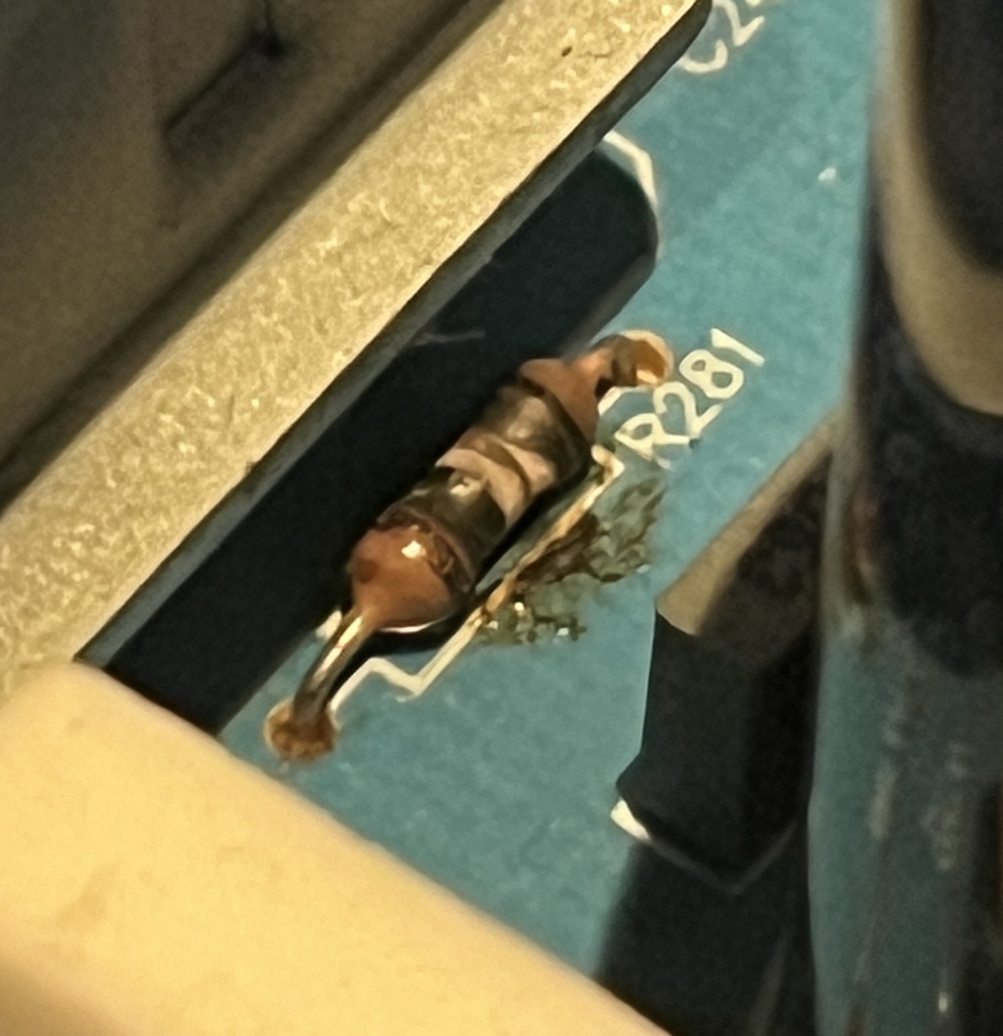

HI there, I have taken some readings across some of my transistors, specifically the ones connected to the blown resistor. I have attacehd a pdf of the results. Looking at the schematics it seems that the connecting Transistors are Q115 and Q114 and then looking at my results these two transistors are showing some very unusual activity. I can take these two transistors out and replace them both. but should I also be looking somewhere else for what is causing the unusual readings. Or is it that these just blow sometimes?
Those values really don't mean that much when measured in-circuit, besides it's R281 that's burnt, so the problem would be more likely with Q214 and/or Q215 than with Q114 and/or Q114.

There's certainly something going on in the circuit behind R281, and is probably the reason why it is burnt. However, I expect there to be more than one thing to be broken and that will affect your readings in-circuit, e.g. the B-E voltage on Q215. On Q115 it reads 57 mV, but as you can see R181 is connected between its B and E pins. Since it's only 51 Ohms, it takes that reading down when compared to the same measurements done on a desoldered component. On Q215 the B-E voltage reads O-L, Over Limit, so that means R281 must be open or gone really high. It seems likely that Q215 has gone short and taken R281 with it. Q214 may or may not be broken too.

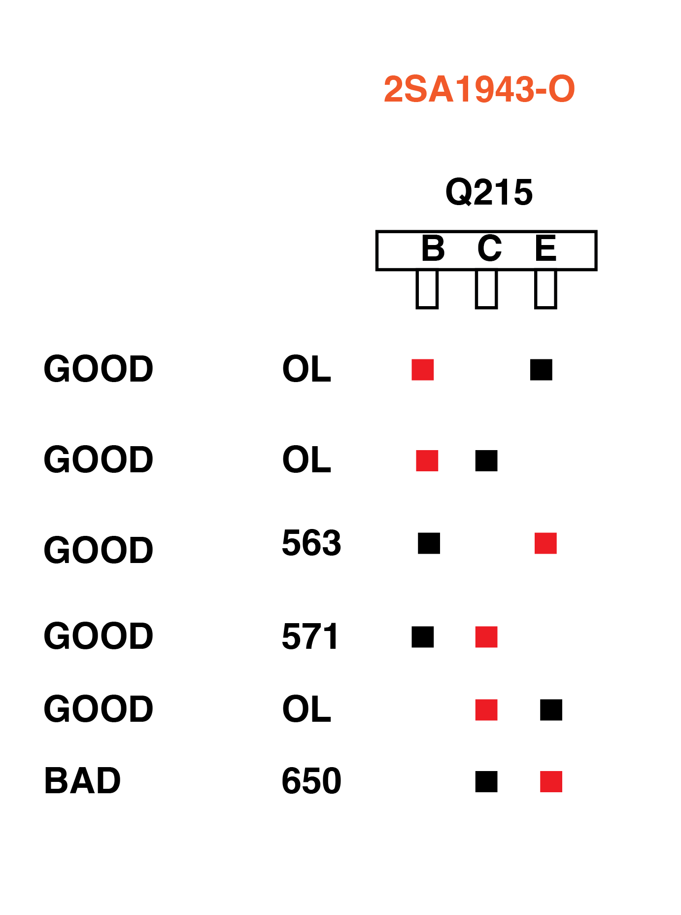

Hi there. Thanks for the info. I did some more thorough measurements of Q215 in circuit. As shown by the image it shows that the E-C reading is wrong which would suggest its gone bad. However. I removed this transistor and measured out of circuit and I got an E-C reading of OL. Which suggests that it isnt broken.

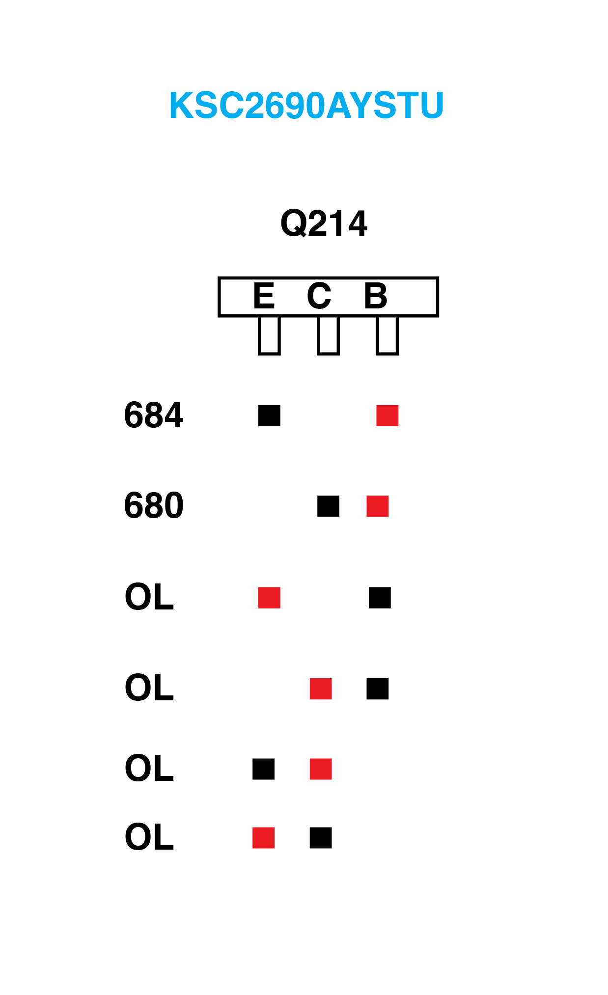

I also removed Q214 and all the readings for that seemed ok as well. So I am not really sure whats going on.

I agree that Q215 seems to be broken. Other than that and the fact that R281 has burnt, I cannot draw any conclusions based on these measurements.
It doesn't tell us anything about why it happened which means the actual cause of those components blowing up might still be present.
You could try and replace only those components, but if the cause is still present, they will blow up too.
More measurements are needed, but if you are unsure of how to take them, please get somebody with more experience to help you. If you are unaware of the dangers of working on live mains powered equipment, please have a qualified technician do the repair.

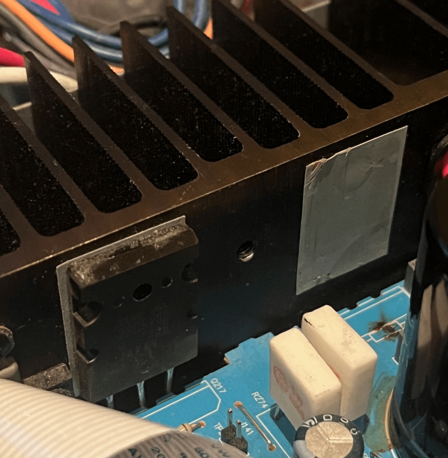

Hi there. I have now received all the new parts so I will be installing them soon. One quick question. it looks like NAD used a thermal pad inbetween the transistor and the Heatsink. (See image.) When I took the transistor off it was stuck to this however I am guessing that over time thats just what happens.
This pad is easily removable and I have bought some Thermal Arctic Cooling MX-4 to use instead. or do you think I should just keep this pad in place? I presume I dont need to bond the transistor to this in any way.
The thermal pad is vital from an insulation point of view. Without it, the collector of the transistor will create a short circuit to the heatsink as it is connected to the metal backside of that transistor. Make sure the pad is in good shape and after mounting measure continuity between the centre pin and the heatsink. There should be none. If there is and you power it on anyway, the magic smoke will escape.
