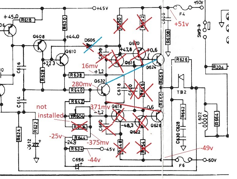

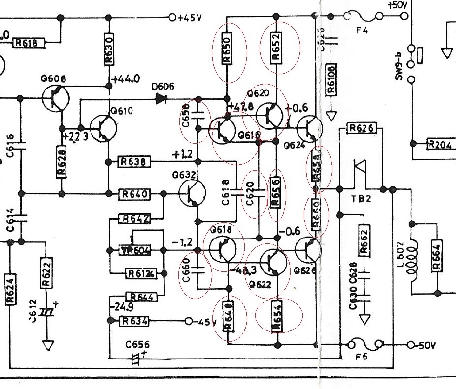

this is what has been done, and i couldnt see why it should have been an issue, and i have triple checked this is as it is

Those voltages are quite high and will turn on the lateral FET's quite hard.
So all those parts circled are removed? Try lifting R642 which should make the gate/source voltages close to zero. See what happens when you do that.
no it still has noise on the right, not as much, a tiny bit if you turn it up on the left
but thats at practicaly no bias
If you increase the good(left channel to 7mv(what it would be with BJT'S fitted) the lamp is REALY bright
the bad channel you cannot get below 30+mv and thats plugged into the lamp, with a mains voltage of 220ac
i dare not try that at the moment without the lamp
And is that with R642 still lifted? In other words do you still have zero gate voltage and yet still have 30mv across the 0.22 ohm?
If so then a probably reason for the good channel lighting the bulb is simply that it pushes the bulb current over the edge where the bulb suddenly increases its filament resistance and lights.
If it is all as described above then look with the scope on the gates of each FET but do this on the bias generator end of the gate resistor rather than on the gates. Is the noise/oscillation still present?

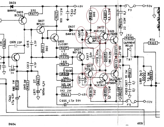

What was the resistor value you were measuring across to get 7mv for the BJT and is it the same value resistor you are using for the FET's.
The BJT 3140 uses 0.22 ohm emitter resistors as I recall but for the FET's we don't those and they are better linked out
I removed these early on as per your instruction. Do you want me to put the 0.22's back?
Its perhaps not a bad idea while we try and see what is going on.
(how are you determining the bias current without those fitted, remind me... I know I ask a lot of questions and some might be repetitive but its hard keeping it all together sometimes along with everything else on here 🙂)

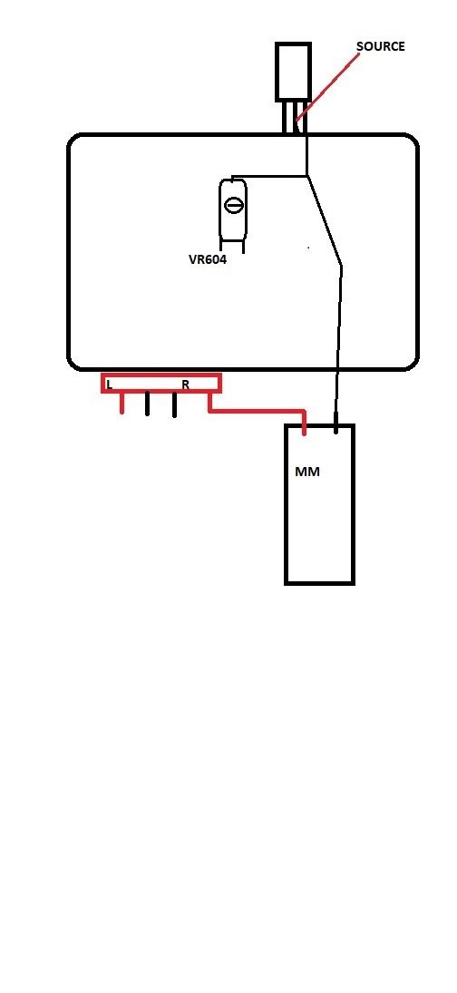

So how do you get 30mv across a piece of wire. Do you see 🙂 ?
the 0.22 resistors have been removed and have jumpers. If I plug in full mains I can't even get the good channel below 30mv
You should not see any voltage at all under any condition if they are linked or are you thinking of DC offset rather than the voltage across the 0.22 ohm?
no not the offset
vr603/4 are and have always been connected directly to the drain or what would have been the emmiter on the BJT
the only difference is that the 0.22ohm has been removed
This is the original test point location, it was just located on top of the resistor
this is how i am taking the readings, and did the same on all the others without issue
