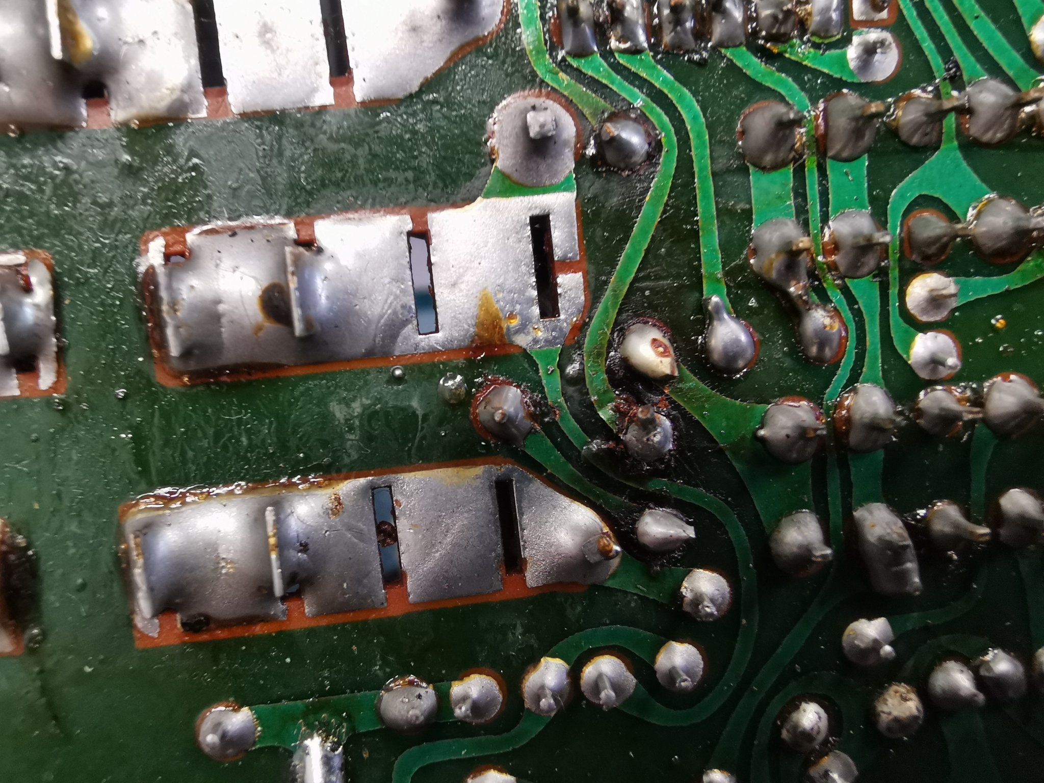

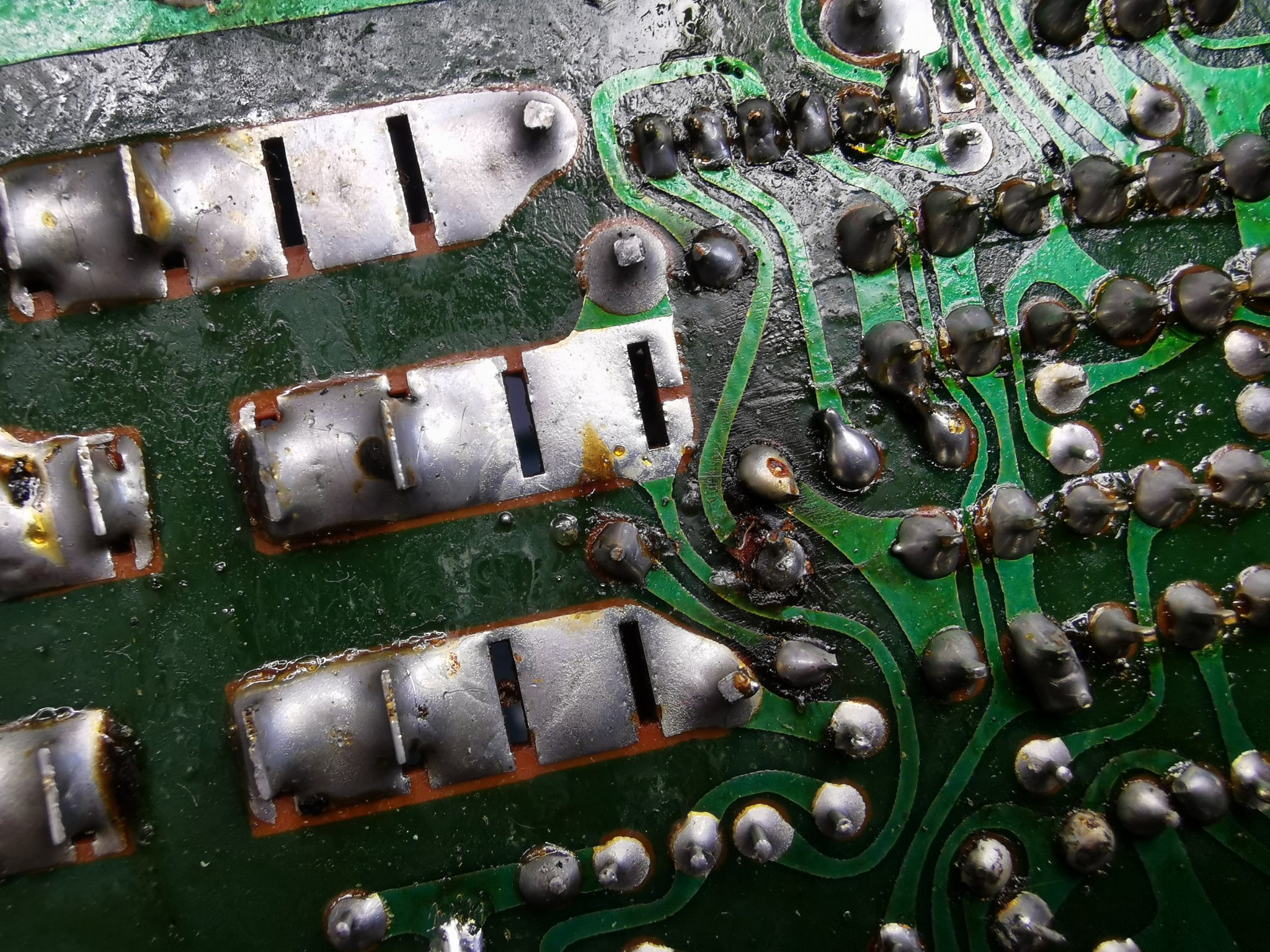

Cracked print around the pad? It also looks like the solder hasn't taken to the component lead. Hitachi were bad for that kind of thing.
The noise/lead issue does sound a bit like a floating or missing ground.

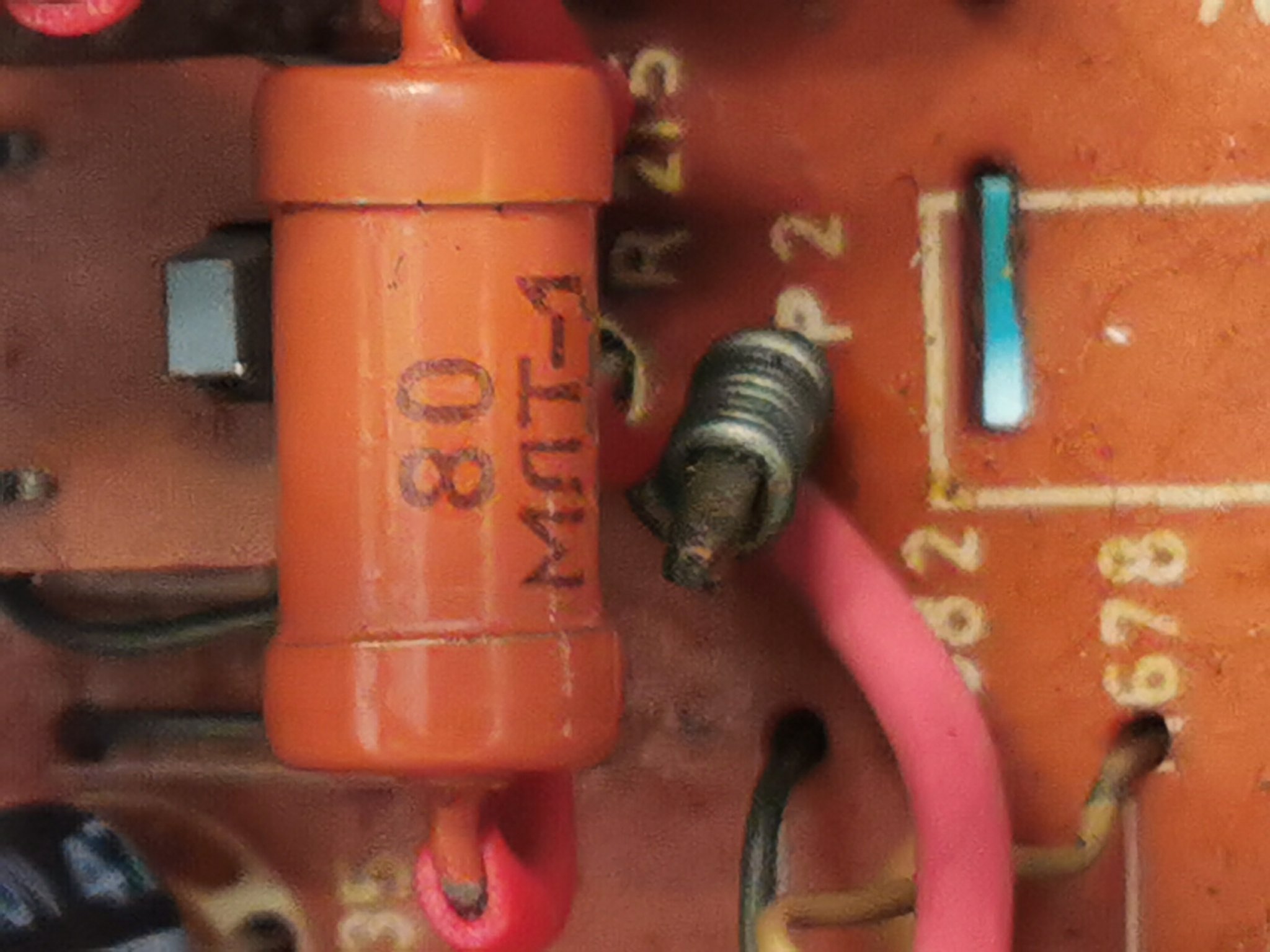

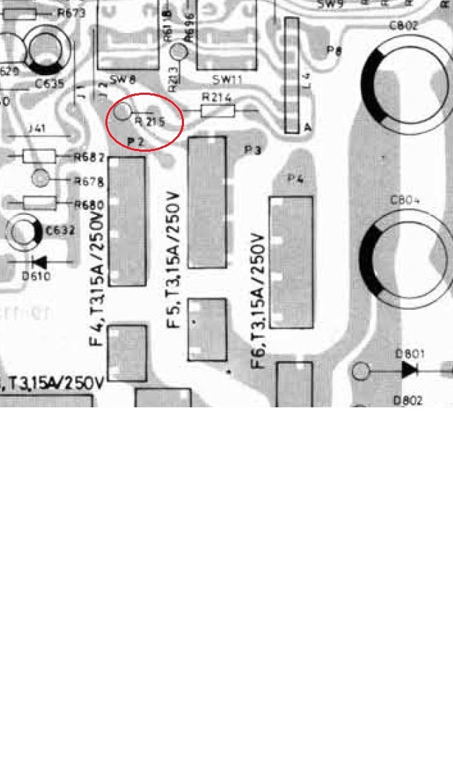

The manual shows a 50 volt rail and a 2k2 feeding the LED and the parts list shows a 1/4 watt part, the update says increase to 4k7 at 1/2 watt. That is potentially still over 1/2 watt dissipation while the original worked out at over 1 watt in a 1/4 part.
This kind of thing was NAD's downfall imo, so much stuff is marginal in its safety margins.
That looks pretty substantial. Haven't seen resistors like that in years although I do have a Belco signal generator that is full of them in all wattage sizes.
Belco Generator
Belco Generator
It is very easy to overload an amp with many generators. To much signal and to high a frequency (at a high level) and many amps will object. Look and learn the output levels from the generator and always use the correct attenuator settings. That little Belco puts out 8 volts pk/pk from memory but from a high and variable source impedance (amplitude pot wiper) while my Tenma function generator does 20 volts pk/pk from 50 ohms at anywhere from sub 1 Hz to a couple of Mhz.
I have a bucket full if one day you need it, an old technician gave it to me about thirty years ago.That looks pretty substantial. Haven't seen resistors like that in years although I do have a Belco signal generator that is full of them in all wattage sizes.
Belco Generator
it tends to oxidize and split at the incerts which are fitted on either side of the resistance.
