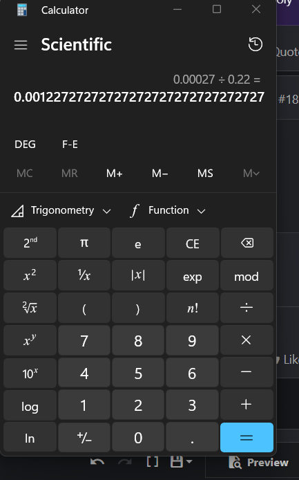

ive just been looking at this again, and im sure my calculations are right, which must mean it isnt 1.22ma, but 1.2AIf the lamp brightens at 1.22ma bias current then something else unseen is going on I think. That level of current would barely light an LED let alone cause a filament lamp to glow.

0.27mv/0.22 would be 1.2A not ma
the origianl spec with BJT's only called for 0.06/0.22 =27ma, so no wonder the lamp was glowing with 1.2a (that is right isnt it?)
If you 0.27 mv then the current in 0.22 ohm is just 1.2ma which certainly would not light the bulb. That is why I think there is something else going on.

6mv across the 0.22 ohm is 27mathat means the original bias current with BJT's would have been 1.22ma 6mv/0.22
i can see whats wrong here, ithought i was doing it wrong, but i wasnt, i was using the reading i set it at (27mv)
so 27mv/0.22, but i had the decimal point in the wrong place 0.27/0.22 instead of 0.027/0.22
so the reading would have been 0.122ma, so the lamp would be bright at that right?

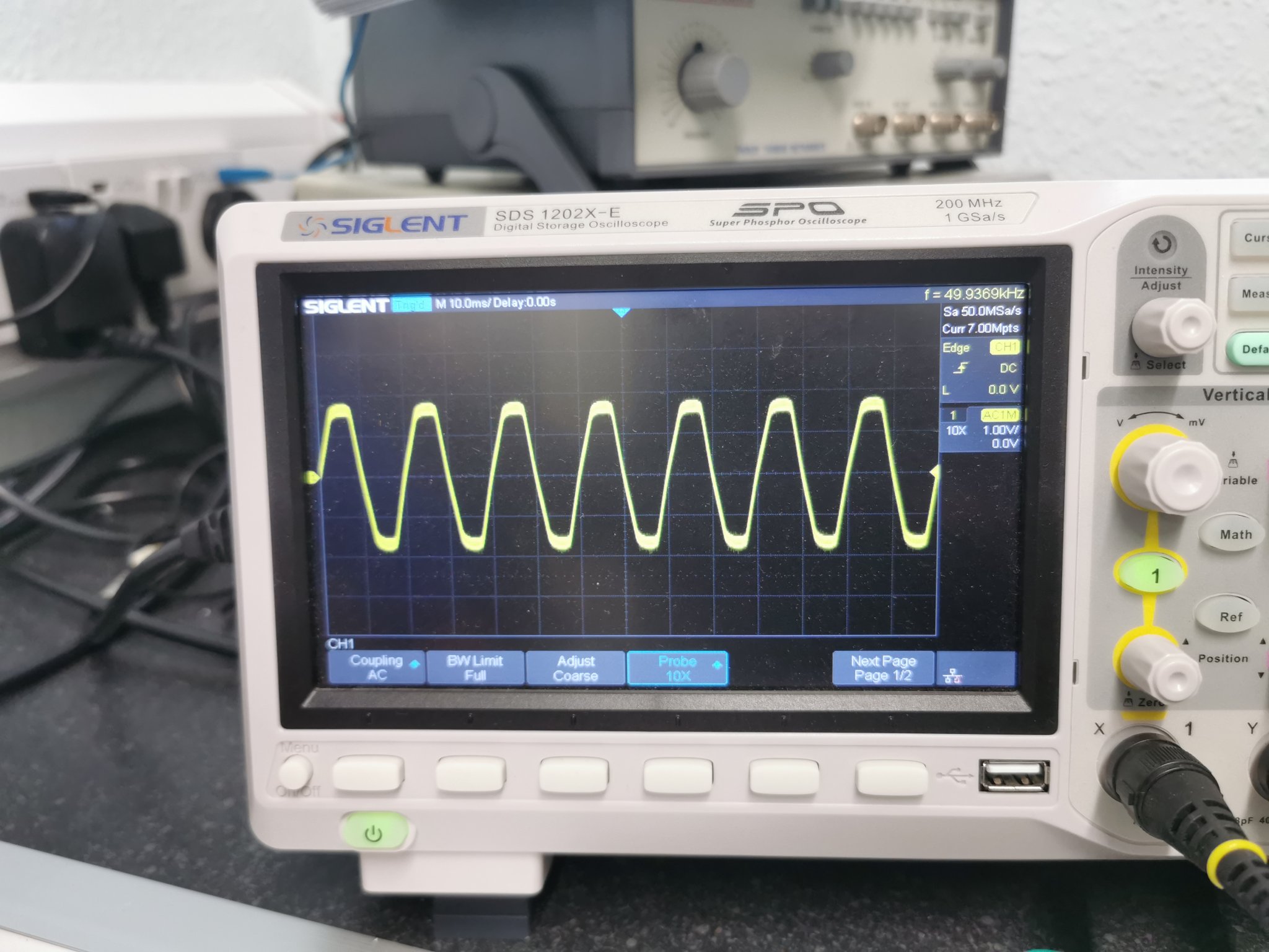

so im kind of confused now as the attached sine is the same on the good, as well as the bad channel

The scope trace looks a bit 'furry' unless its just the image. I wouldn't advise disconnecting the gate stoppers because the FET's have a near infinite input resistance and the gate will just pick up and float to any random voltage.
Any noise you are hearing in the speaker will be very very low amplitude indeed, perhaps only a few millivolts peak to peak and you would only see that with no signal.
Why is sine clipped at the top and bottom? Is the input waveform clipped like that?
