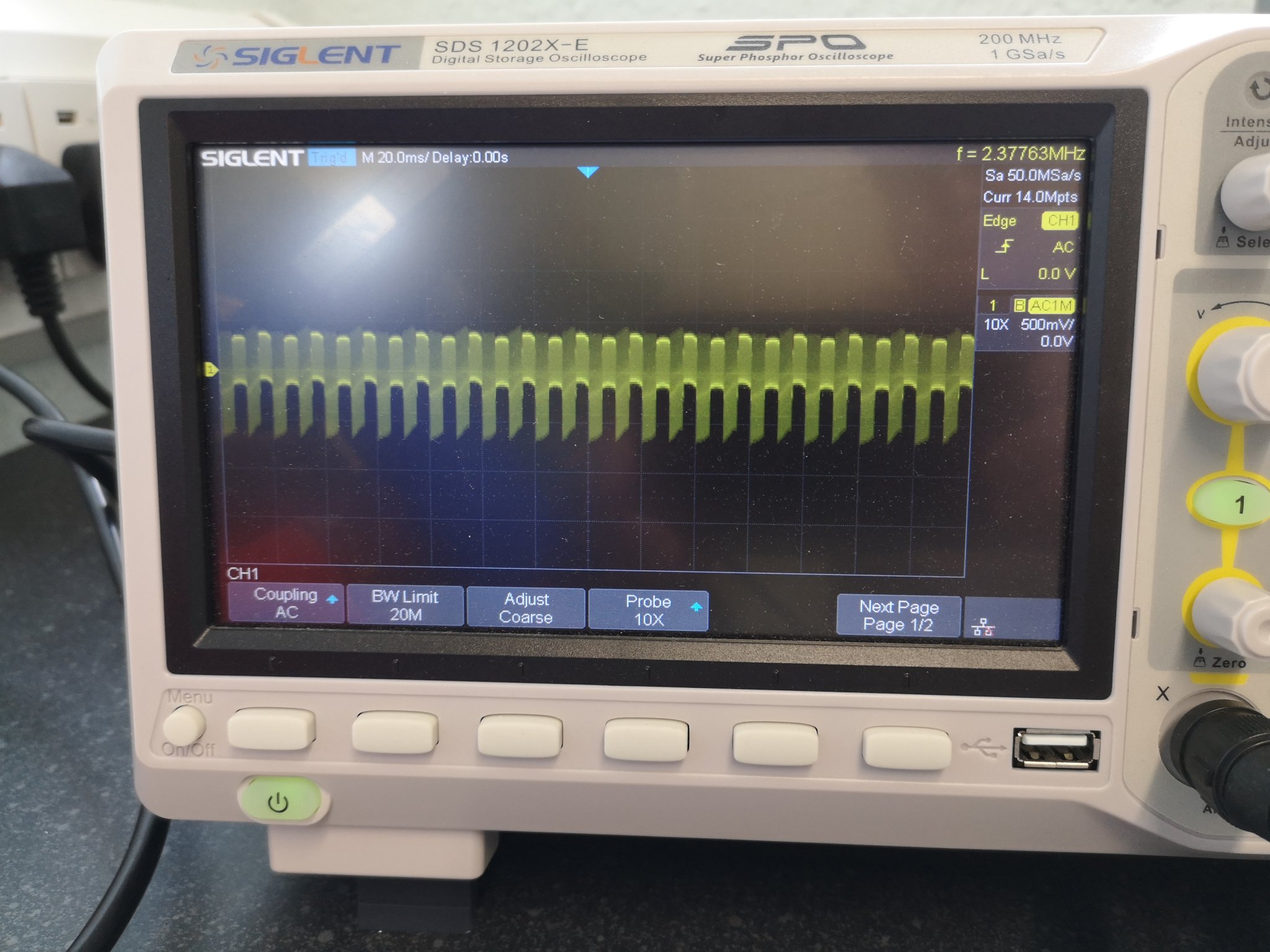

so here is something strange, maybe you guys can enliten me
This is what it looks like at the speaker terminals(all 8) with all 6 fuses removed
so it is noise, but not audible with the fuses out inc the mains fuse

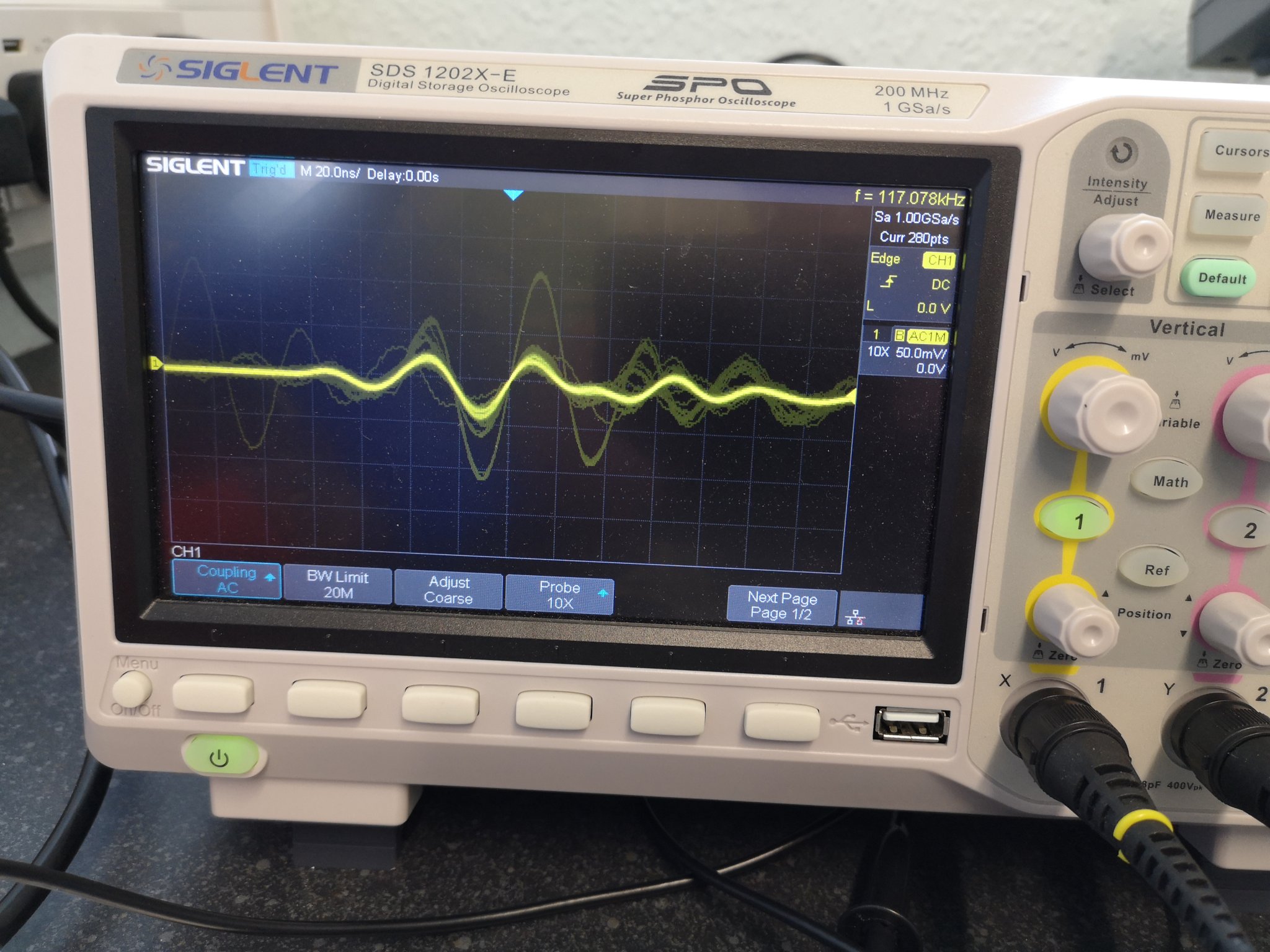

right so i have learned somethinghere today.
this noise is as a result of the long ground lead i had on the probe
if i remove it and use the standard length there is no noise
so where so i go from here as i cant check things across the board with the standard ground that comes clipped to the probe.
If there is no load on the output then you will likely see all sorts of stray pickup. Its all just floating. Even adding something a like 1k or 100 ohm as a load should remove that.

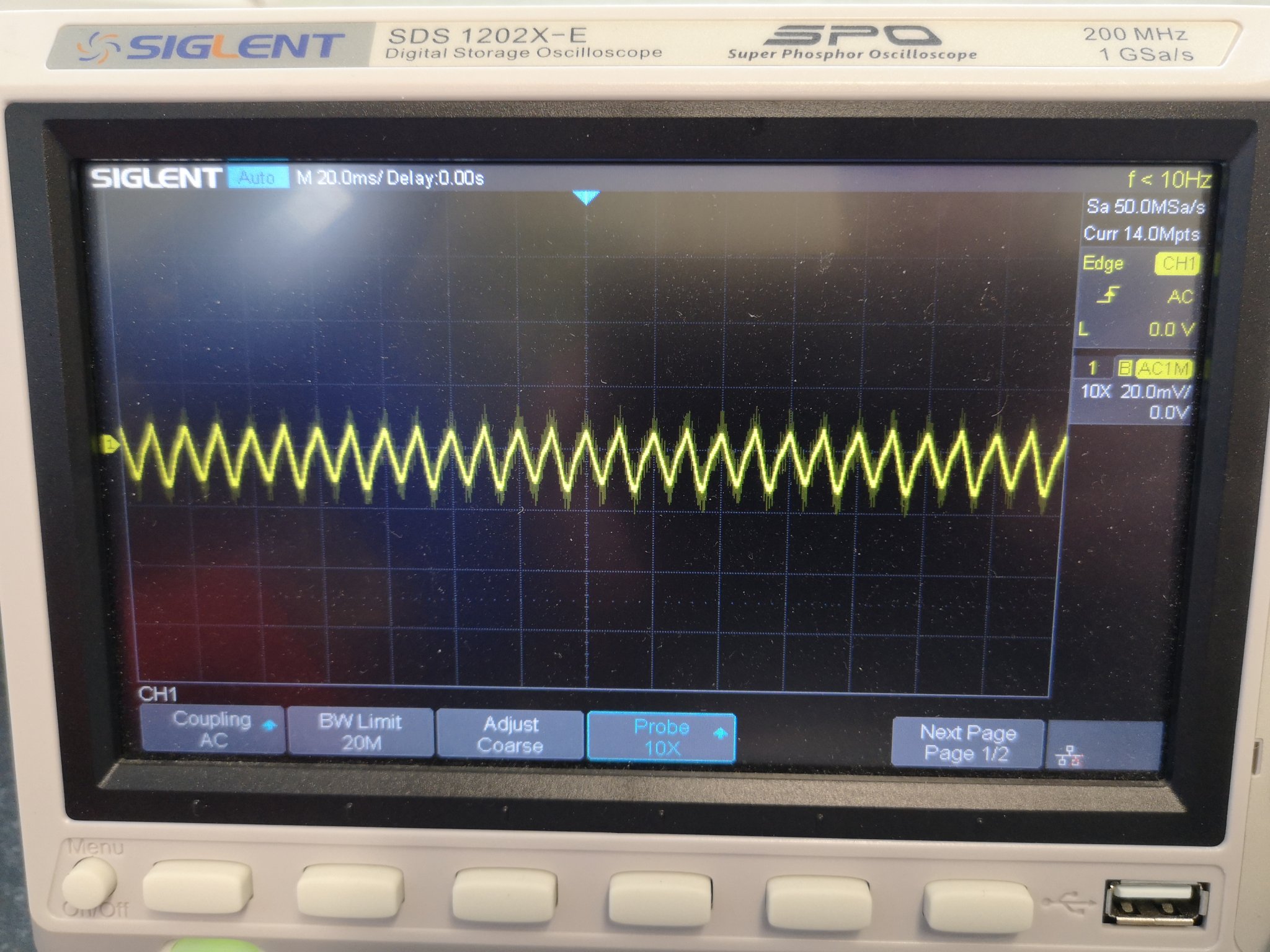

That does look more like ripple because it has the characteristic sawtooth shape of typical ripple. If you look at the frequency it should be 100Hz and not 50Hz. That means there should be10ms between any two similar points on the waveform.so this is what it realy looks like
ripple right?
That does look like instability made up of different components.
You need to look at the frequency of the low frequency repetition. There are two cycles of that per division so look at the timebase speed and calculate the frequency. I'm guessing it will be 100Hz. Then increase the timebase speed and expand the other parts which will be high frequency.
https://www.analog.com/en/technical-articles/short-ground-leads-make-better-scope-photos.html
Jim Williams (RIP) wrote this great application note "high speed amplifier techniques", discussing proper probing/ Well worth sitting back and reading:
https://www.analog.com/media/en/technical-documentation/application-notes/an47fa.pdf
