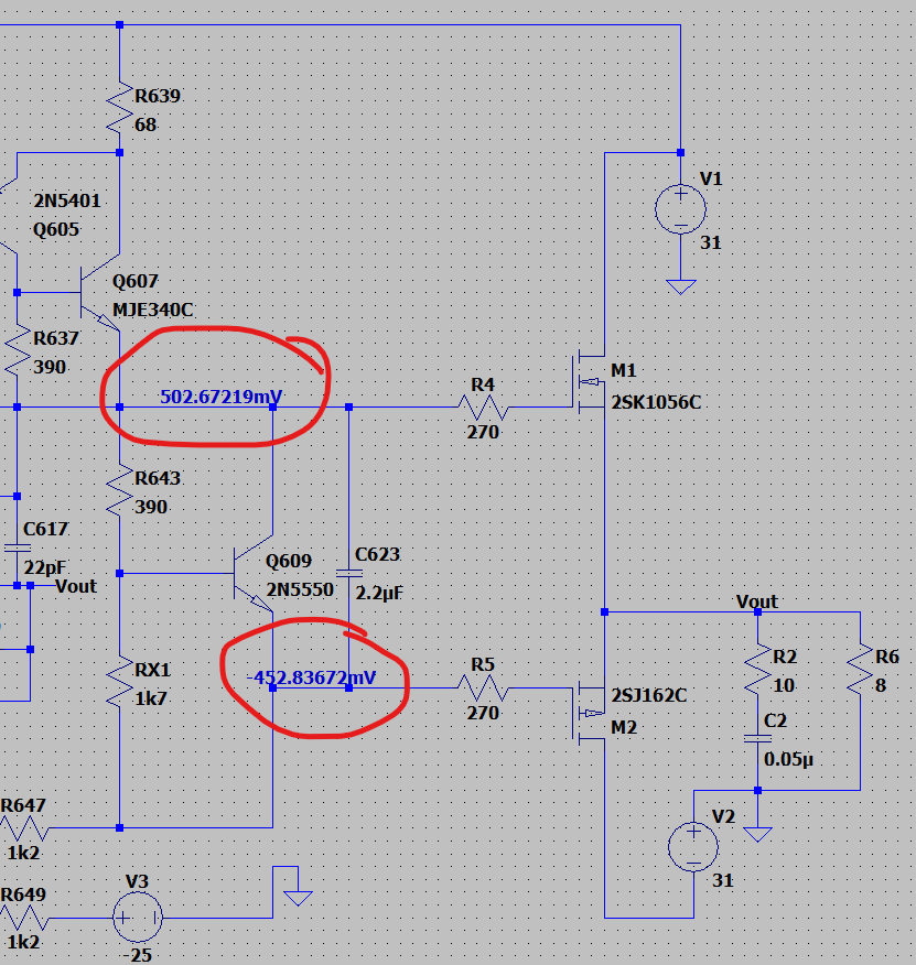

NAD 3140 Conversion to lateral FETS
Scoping it is a good idea. You can also look for crossover distortion if you turn the bias to zero (if it will go that low). You would need a pure high frequency sine at low amplitude (say 1 volt pk/pk) and an 8 ohm or lower load.
Make sure you use a bulb tester at this point.
You need to see the voltage across the vbe multiplier increase to turn the FET's on but remember the FET's need only a couple of hundred millivolts per FET to begin to conduct.

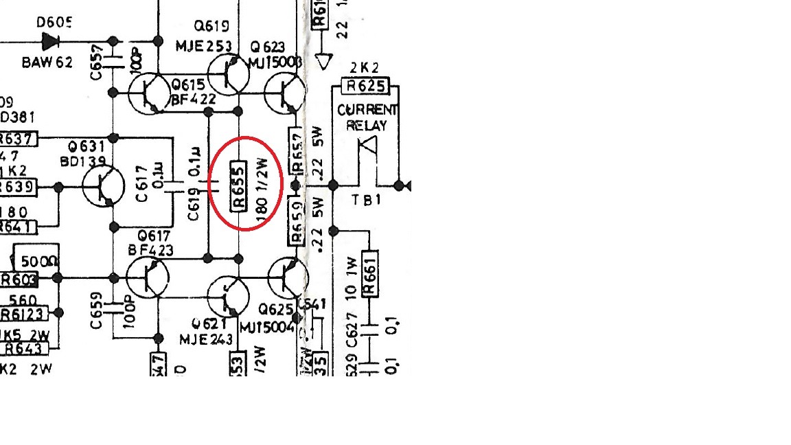

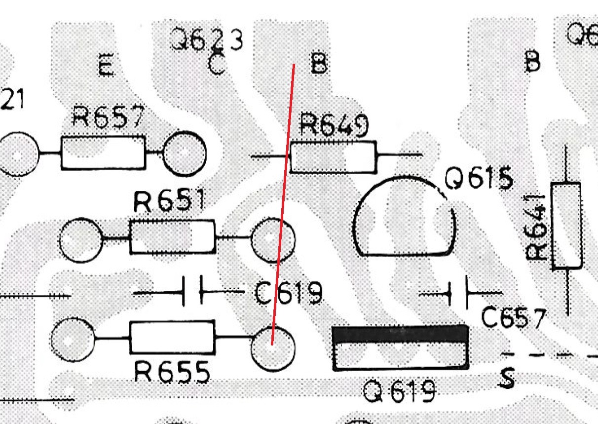

Ive just realised ive left R655 in thinking it wouldn't make any difference with the transistors removed, but ill have to check later as if it is still in circuit with both the gates, this could cause an issue?

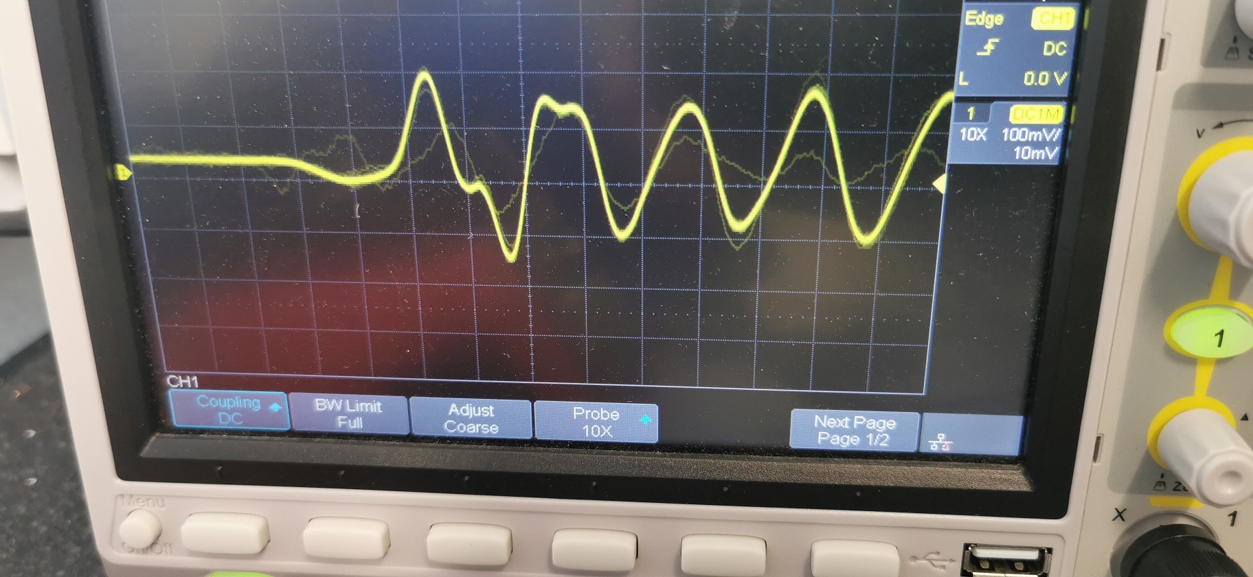

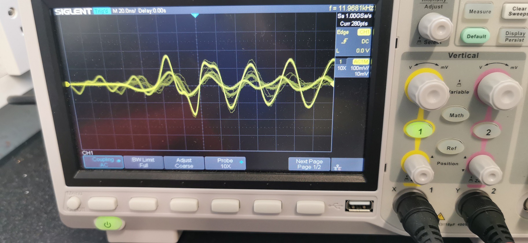

Make certain the FET's are connected correctly first of all. Make sure the Source of each FET goes to the output line and make sure the feedback take off point is connected. 15 volt on both the gates suggests a massive DC offset issue as much as anything else.
We know the mods work because we've done them before.
That sounds like a missing ground somewhere. Scope will show if it is pure hum/buzz or whether there is something else going on like instability. Could be something like a missing screw maybe grounding some print to the chassis.
