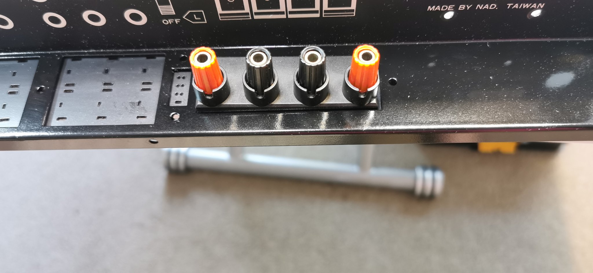

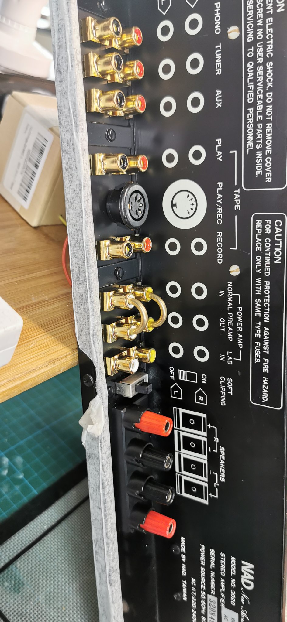

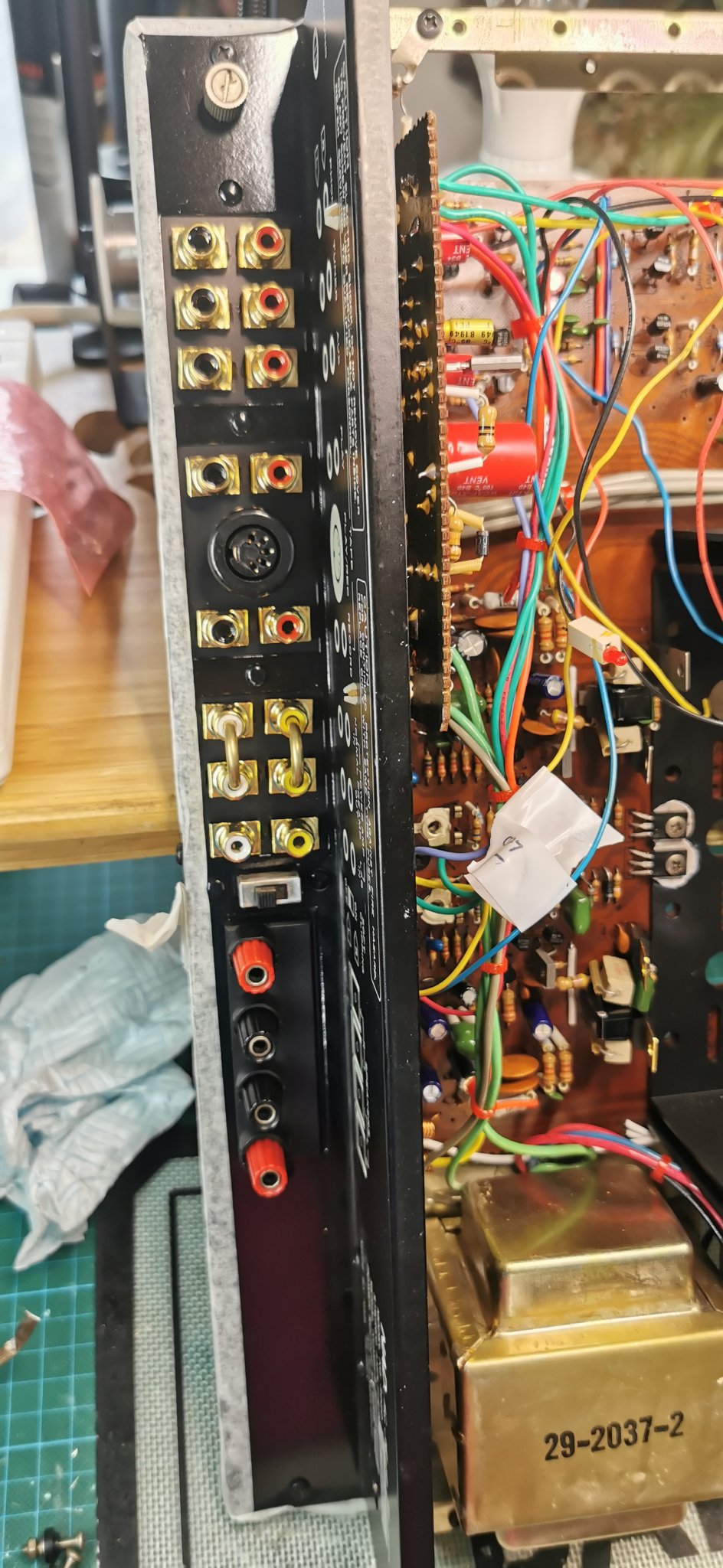

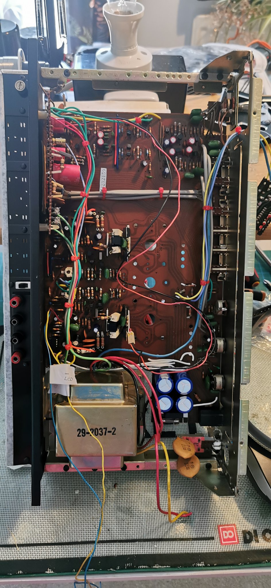

ok so nearly time to start re assembling.Hopefully have it up and working this weekend, although the amp did have a small fault, and hopefully it wont take alot to get that sorted out👍
At least it isn’t so hot now I might make some progresssounds like a plan.

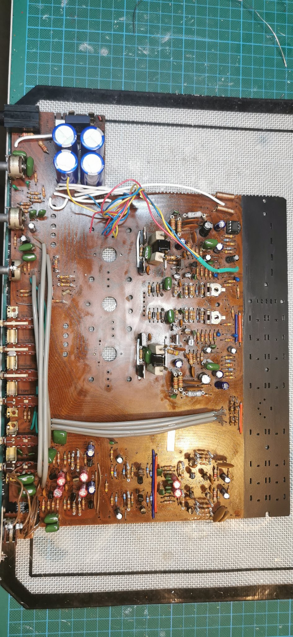

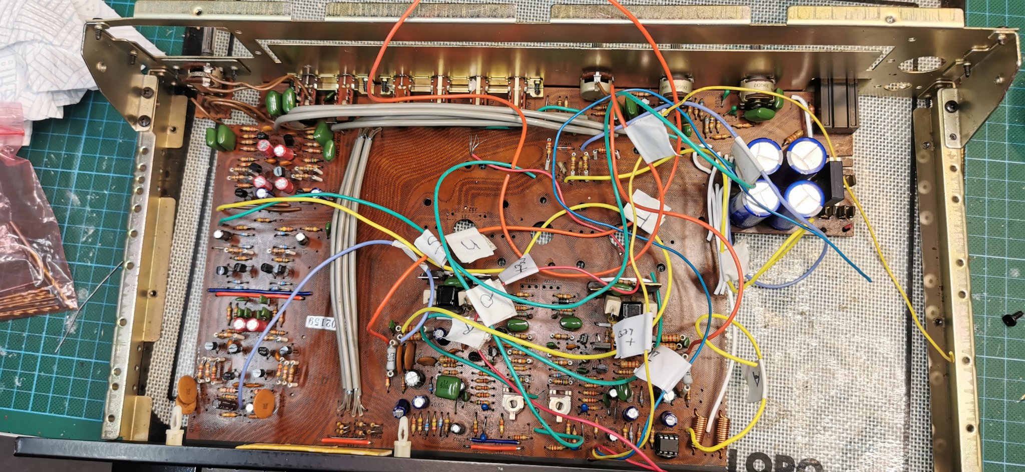

About as clean as I can get it......
Well it certainly looks clean 🙂 You've put a lot of work and effort into this one.
Cheers for that. It certainly has. Has become a labour of love this, way beyond what I originally anticipated but I'm looking forward now to seeing it finished. I was going to start assembling, but I recon it's time for ☕ and tv

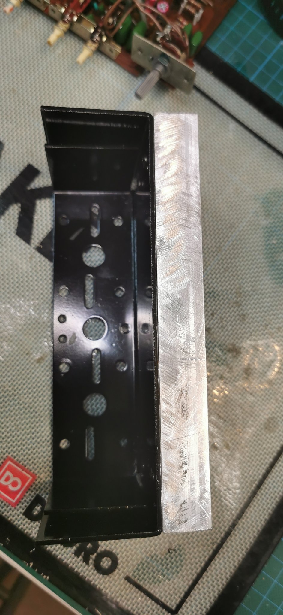

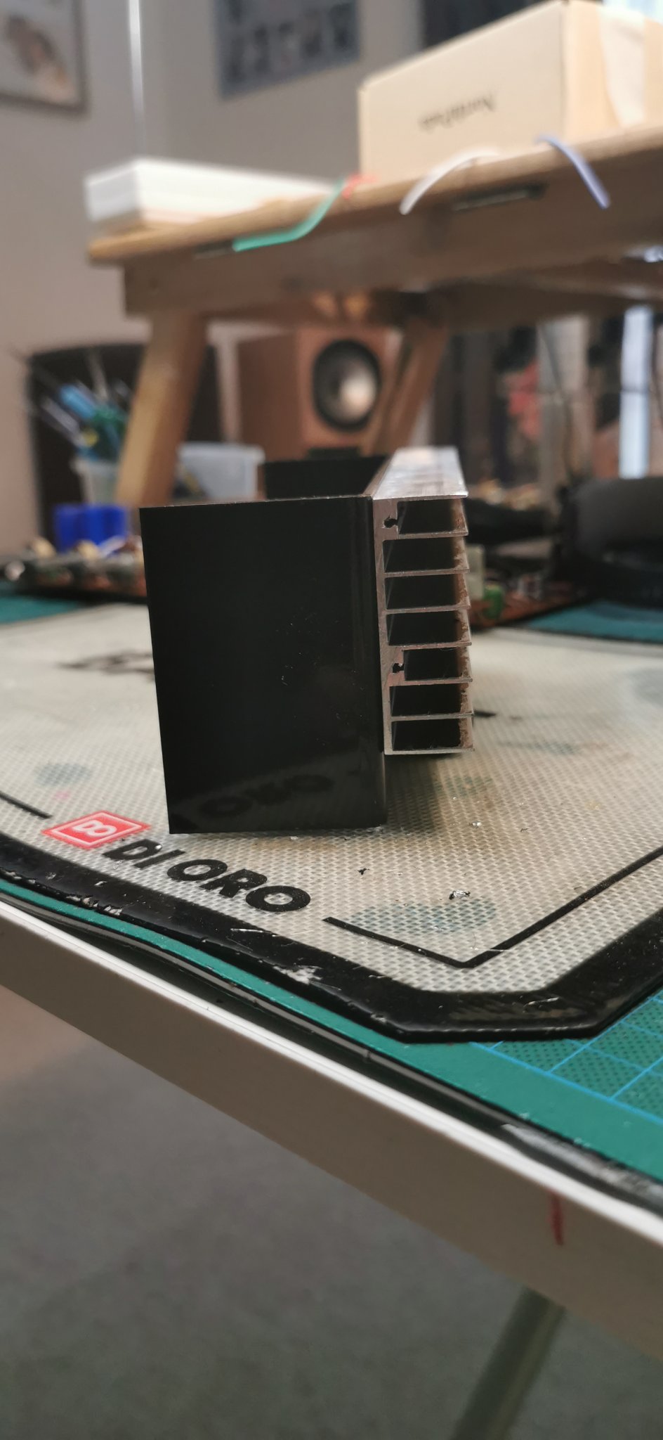

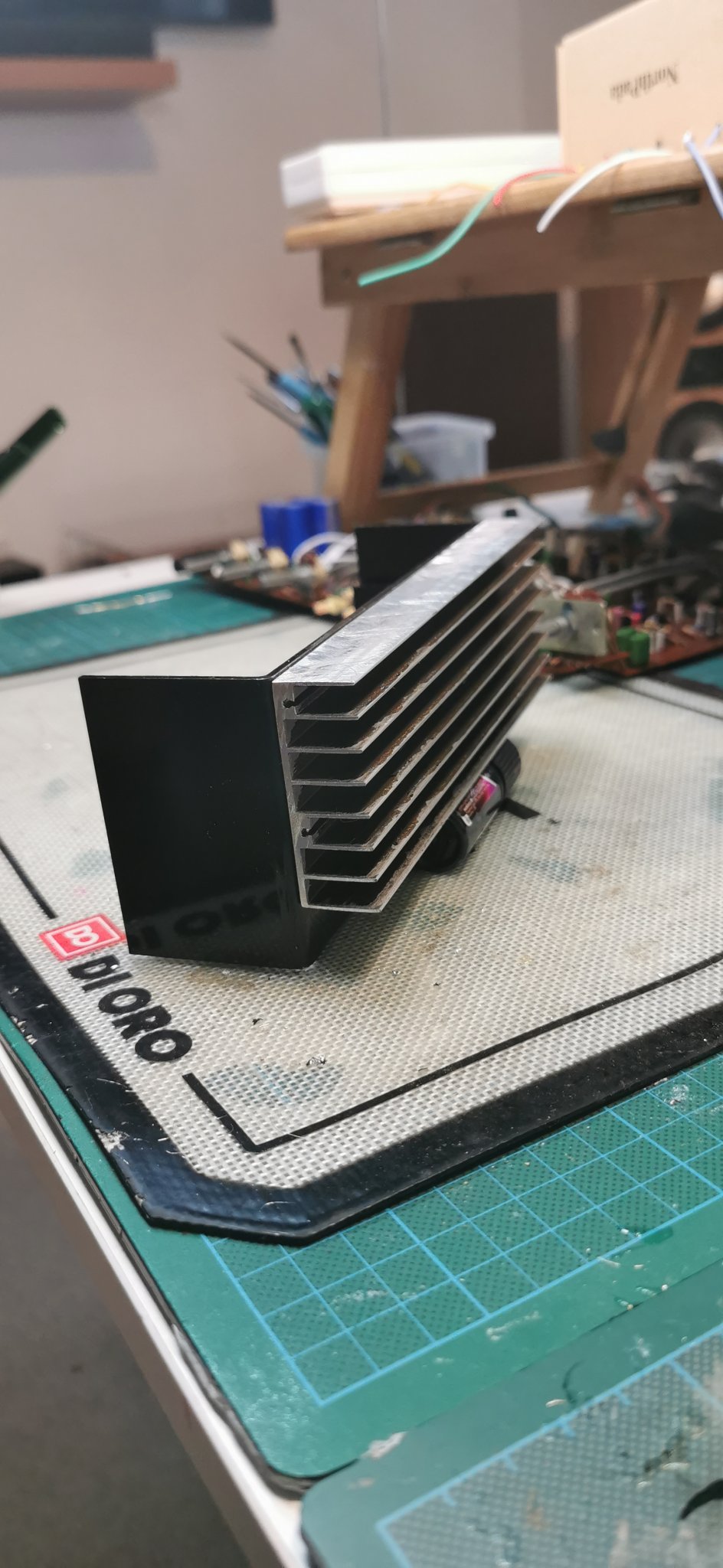

So I've finished the modified heatsink. Though of and tried a few approaches and went for the simple realy, at least this time around. It's simply removed if required. Just waiting for the etch primer now then I'll give it a very lights spray of gold paint
The original isn't fantastic and in today's increasing average summer average temps it can only help 👍Is so much dissipation necessary for the new transistors ?
