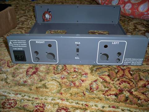

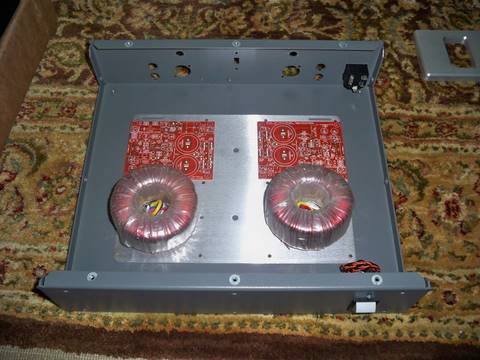

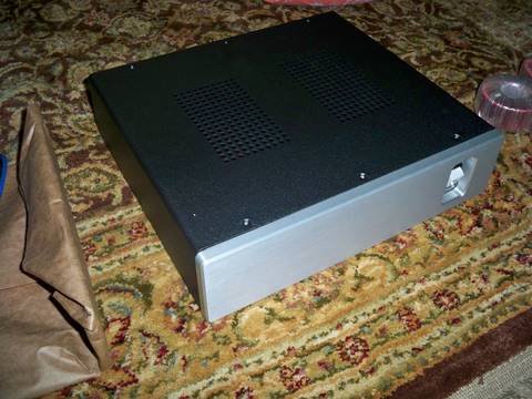

Finally I got what I needed. Remember that Chassis I was talking about a while back? Well, it is a really nice chassis but I wanted it to be perfect for the MyREFC so I got a bottom plate made for it. It perfectly matches the MyREFC boards and the 160VA toroids I have been selling. You can also fit easily a 250VA in the center and if you offset the 300VA about a quarter of an inch it will fit as well. This thing is ready to go. If you guys want them I am asking 165 each plus shipping. I think its safe to say this should remain US or Canada. Elsewhere would be silly for shipping costs, but if you must have one I will try to ship to other countries, just assume shipping will probably be 50+ to countries outside the US.
I only have 10 of these. One for me, one for Sonidos, leaves 8 of them and another half of those have been requested but I need to check and see if those folks are still interested. So 4-8 available.
Dimensions are 14" wide, 12" deep, 3.5" tall.
All screw holes in plate perfectly match the chassis. No drilling needed at all.
I think it will fit a large fllat rate USPS BOX!
That IS a really nice case and I am happy to see that the back was silkscreened and has the balanced input hole stamped already. It looks very professional.
Do you think it possible to additionally purchase the RCA/balanced switch that bolts right in? I am assuming that switch would be of reasonable quality.
Does anyone have a favorite RCA female, XLR plug, or speaker terminals they particularly consider a good value? I want higher end looking stuff that reeks of value not snake oil.
Heat sinks on the side. Barredboss, on ebay, would be a likely candidate for supplying sinks. Any thoughts on dimensions from his offerings? I am a firm believer in cooler is better.
Would additional holes need to be drilled, top and bottom, to allow proper convection across the sinks?
Heat sink on the side eliminates capacitor shielding of the transformers. Will the trafos need to be shielded to keep noise low? They look awfully close to the signal path.
Any recommendations on stand off type and size would be appreciated. Mouser numbers would really rock.
Uriah, do you you plan to stuff one of these cases? It would be comforting to us newbie builders to have an experienced hand/mind evaluating such a completed project.
Regardless of the answers to the above questions, sign me up! Those are some nice looking cases that are just what this build needs.
