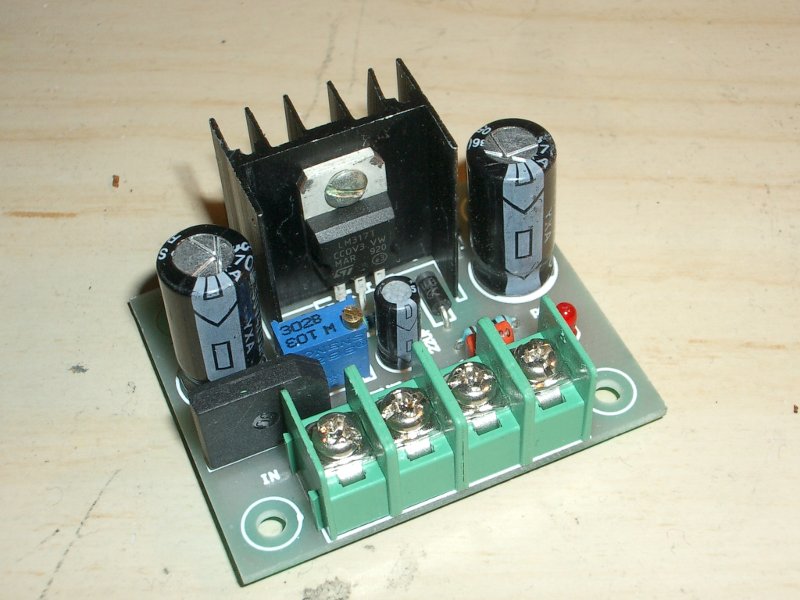

My lightspeed will be in it's own case and I won't have power to tap off of like I would if I made an integrated amp. I am looking for power supply options. I have seen regiregi's schematic in post #540 of this thread. Could I just use that and a 9v wall wart to supply the DC to the circuit? Can 9v from a wall wart be regulated to 5V with this circuit?

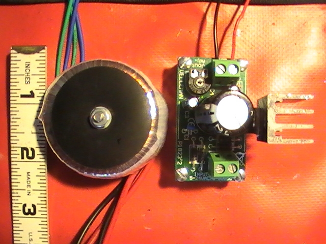

Before I discovered John Ango at Antek - Your reliable source of transformers, power supplies, and more. who built a PSU for me, I bought a Velleman kit and a AN-0012 transformer to power it.
Then he build a PSU board and sized the transformer for my Pass B1 .
He also has a 5 vdc for the LDR project.

A an external wallwart is very convenient. Take a 9v or 12v wallwart and regulate it down to 5v with my regulator. It is easy and cheaper. It will make a bit of noise, but it won't be relevant or measurable.Remember that after the switching PSU there is a regulator, and after that there is an LDR lighted by a diode. So, the switching noise is not on the signal path.My lightspeed will be in it's own case and I won't have power to tap off of like I would if I made an integrated amp. I am looking for power supply options. I have seen regiregi's schematic in post #540 of this thread. Could I just use that and a 9v wall wart to supply the DC to the circuit? Can 9v from a wall wart be regulated to 5V with this circuit?

Great deal that regulator, Dario Very very cheap and nice components.
Regi
I wont harp on this point but I will say I told you so later on. If you use a small transformer and a few diodes before Regi's circuit it will sound much better than a wall wart of the switching kind. The switching noise does in fact get through. You will never notice it however until you compare with just transformer and diodes. So, yeah its nearly insignificant but I think its worth a fully linear supply.

Advice heartily accepted as I don't want to compromise anywhere (beyond those already designed in) on this build. What VA rating would be required for the transformer? Is there a preferred voltage out on the transformer? Would smoothing caps be advantageous before the regulator to ease its function? If so, what value caps are recommended?
