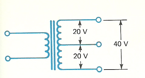

Do we agree that the two AC from the image are AC1 and AC2? (to me it seems so)
I'm saying that the GND from the two secondaries series goes to both PGND on the MyRef and chassis.
If you're sayng that that GND goes to chassis and that PGND goes too to the chassis we're talking about the same thing, it's so?
If not can you precise your point?

The AN-2225 has two Primary and two secondary windings. knowing that,
What gets wired to AC1, AC2 and PGND please?
I use 25V dual secondaries, wired exactly as your diagram you posted earlier. So I have Red+Black and Yellow+Orange pairs on my trafo. I joined Black and Yellow and connected to PGND on the pcb. I will add that I haven't cased my amps up yet (still on a board). Anyway, we are using the same approach, I think. One trafo, one MyRefC board. Classic monobloc.

That is a 115/230Vac dual primary wired to run on 115Vac +-5Vac.
The dual secondary is converted to a centre tapped secondary.
Just to be sure, CliveFreman has posted this diagrem of the Antek AN-2225.
Is this the correct transformer wiring for each MyRefC board?
Gary, yes it is.

How about the transformer that Uriah sold on his site ? I suppose the two whites are the primary, red-yellow are one secondary blue-black are another. I really don't want to power it up until I'm 100% sure. Also if I'm correct would I tie, say, yellow-blue together to to make the center tap?
Doing the continuity measurements madisonears suggested it looks like the black and blue wires are the same and then the red and yellow wires are the same on the transformers Uriah sent. It looks to me like the two white wires should be hooked to the mains, the blue and red wire should be tied together and used as ground, then the black is one AC input and the Yellow is the other.
I'm kind of new at this so you might want to double check with others before you power on.

Connect either pair.Looks like you two agree, does it matter if you connect red and blue to make the center tap or if you instead connect yellow and black?
But you MUST CHECK that the result has the correct voltage. The colours could have been swapped at manufacture.

the final answer posted is CliveFreeman's answer verified by Jon to be a center tapped series connection.
If we need 24/25 vac to each MyRefC board, What Primary voltage transformer
do we select to get the correct output voltage when the secondary’s are wired in series?
My original 12 X 12 wired in series results in 24vac to AC1, 0v to PGND, and 24vac to AC2.
If I am correct the AN-2225 When wired in series will result in 50vac to AC1 and AC2.
What is the correct ac voltage to apply to each MyRefC board?
