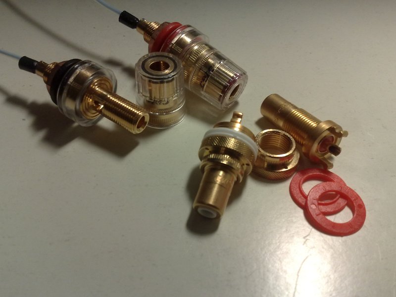

1. I totally agree on both accounts. a) Why XLR's it's a single ended amp? b) Vampire makes some great products at reasonable prices.
2. Consistency and value over a long period. You can count on Neutrik to work as expected.
3. You get what you pay for but some items like RCA's can start off on the cheap side and be "upgraded" as funds allow. Where as PCB components are much more challenging to change out later to improve.

For $20 you could go with top end RCAs...
connectors_rca_cardas
But yes the Neutriks are a GREAT value and will be better than "average" connectors.
EDIT: BTW I got the link on the bottom of THIS page so they are also a DIYAudio supporter!! 🙂

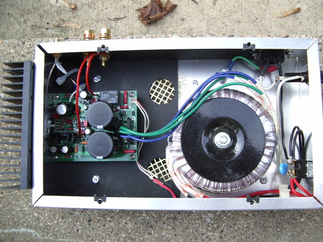

I am just about ready to start laying out the 'bits' in the case for my amp.
I am curious... I saw Lazarus quote above and thought that's a good idea! I'll do that.
Now I am wondering if a big aluminium heat sink actually has more shielding effect than the power supply caps would? In that case I would be better with toroids one side of the heat sink and amp boards the other?
I have a strip of suitable heat sink long enough to take two amp boards comfortably.
Does anyone have any thoughts on this?
I'm just thinking aloud....

radio tells us that the screen must completely enclose the aerial to become effective, in either direction, transmit or receive.
The amplifier would need to be completely enclosed in the screen to attenuate radio signals (electrical radiation).
You are dealing here with magnetic radiation. The rules might be different, certainly the wavelengths are very different. The gaps allowed to stop 50Hz passing are quite enormous compared to the gap allowed to prevent 50MHz passing.
A partial barrier may be quite effective. Are you prepared to build two versions and tell us the results?

you can lay out the trafos and the boards attached to the heatsinks and measure. Then turn them 90º or 180º and measure again. That should be an easy fast operation if you don't screw the boards with bolts
Regi
Regi
I'm not sure what kind of noise you're concerned about shielding against. If it's noise from the traffo and AC, there is no need to take any extraordinary precautions. My amps are mounted only a couple inches away from the traffo, and they are stone silent. All that lies between the amps and their traffo is the power supply caps. You do not need to arrange heatsinks to block anything. In fact, having to route AC around heatsink, past the amplifier to the traffo may cause more noise from cabling than it helps avoid. Use the simplest, most direct routing of ALL internal wiring, especially signal input, and you need take no further precautions.

Re... Shielding
Dear Andrew, Regi and Madisonears, thanks for your posts.
Helpful ideas, and comments! I wish I had the wherewithal two build two amps Andrew... but I can as Regi suggests try a few different layouts and watch for AC noise on a scope at the output.
Madison ears the simple practical advice is very welcome and sounds good. Nice looking amp you built there! Can you ID the cap you appear to be using across the mains switch?
