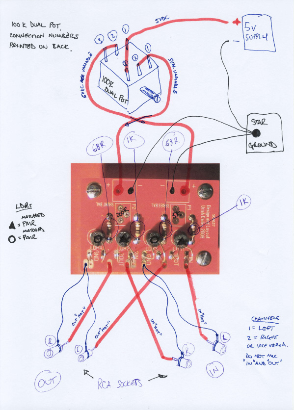

Here is one way
I received this drawing from Jon,
Uriah's way has a balance control and Volume control.
Dual pot is volume, single 5k pot is balance, courtesy of Uriah.
Is there another builder from the GB that has assembled its LDR volume?

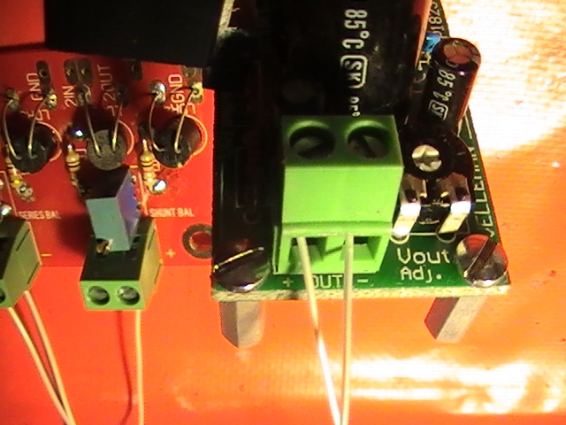

I have seen that drawing and its correct. The dual pot is 100k linear. This will get you going til you buy a dual 100k log. I threw in the linear's for free as I had a bunch of them from Allelectronics, bought on accident and while they will work fine there will be a quick volume increase. The single gang is a 5k. The wiper, middle pin, of the 5k goes to the middle pin hole of the series balance pads on the small LDR board.

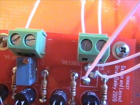

I should mention that in those pics PPCBLASTER posted that power ground is connected under the board. The two terminal block areas each have a + and - area. Just short the two "-" together as sharing ground is fine for the two power areas. Then you only need one wire to the ground on your power supply. Ground in this case is actually just 0V.
"power ground is connected under the board"

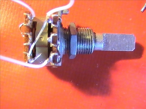

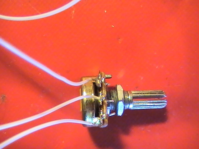

A couple of questions about the '5k balance' pot. Should we go to the trouble of getting a pot with a 'detent' in the middle-if so wouldn't other adjustments be needed to 'center' it; or, is the balance just a way to fine tune the R/L levels??? And, am I correct in assuming that the 'outer' two pins of the '5k balance' pot can go to either other pin on the p1 pad???

No, any old 5k pot will work. There is 1k on either side because of the resistors so you cant use to small of a pot and log or linear. I suggest tuning the center by ear rather than by a center detent or multimeter. When you sit in your favorite spot you want the image in front of you and your gear or room may change the center of the image to the right or left of that spot so just do it by ear, which means we dont care anything about the pot. Even a 2k5 or 3k or 4k pot would be fine if you have something other than 5k. Going to 10k would work to but then you run into problems of the 10k really having an effect on the lowest value the series LDRs can go to.

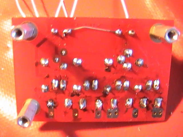

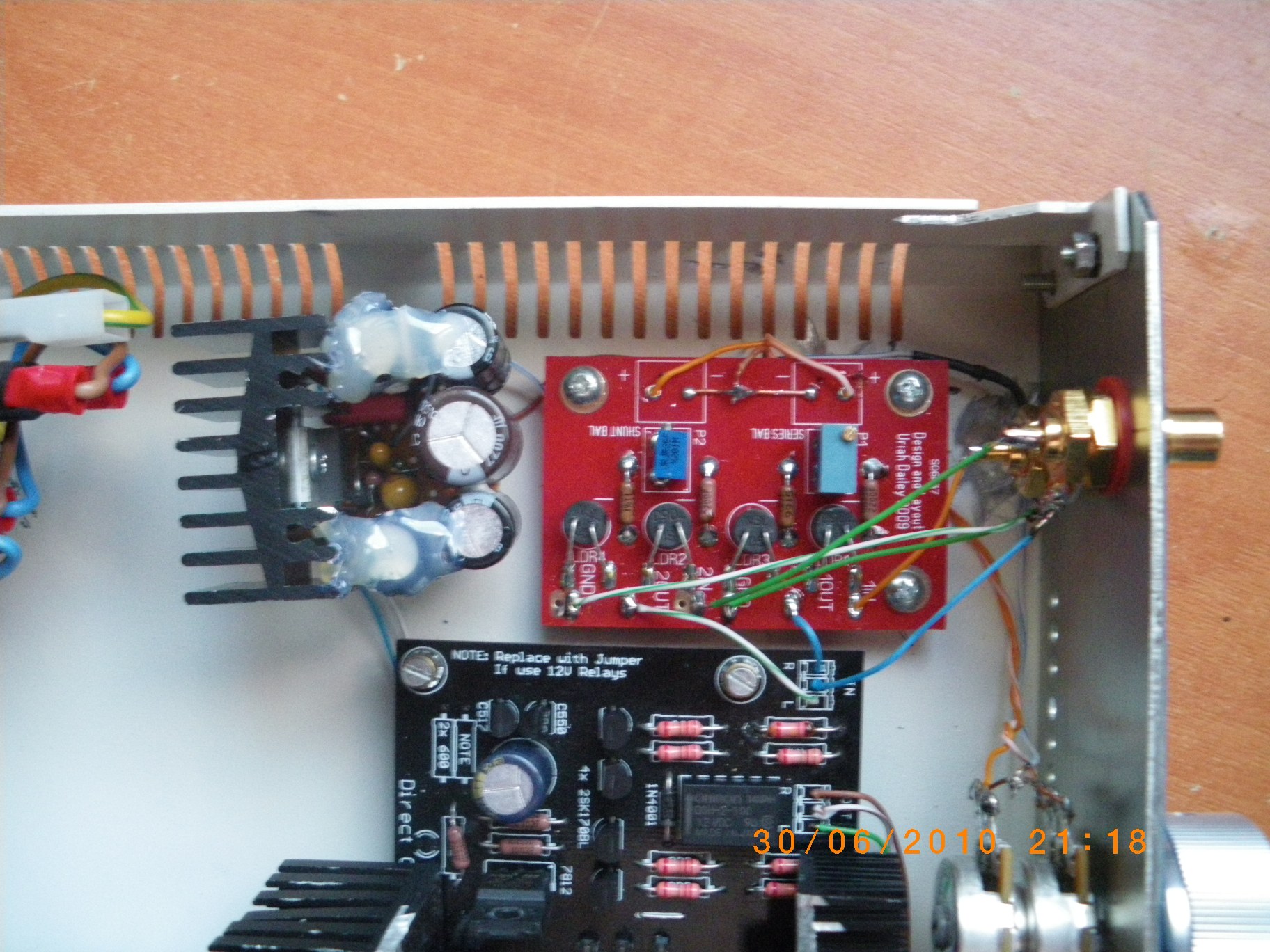

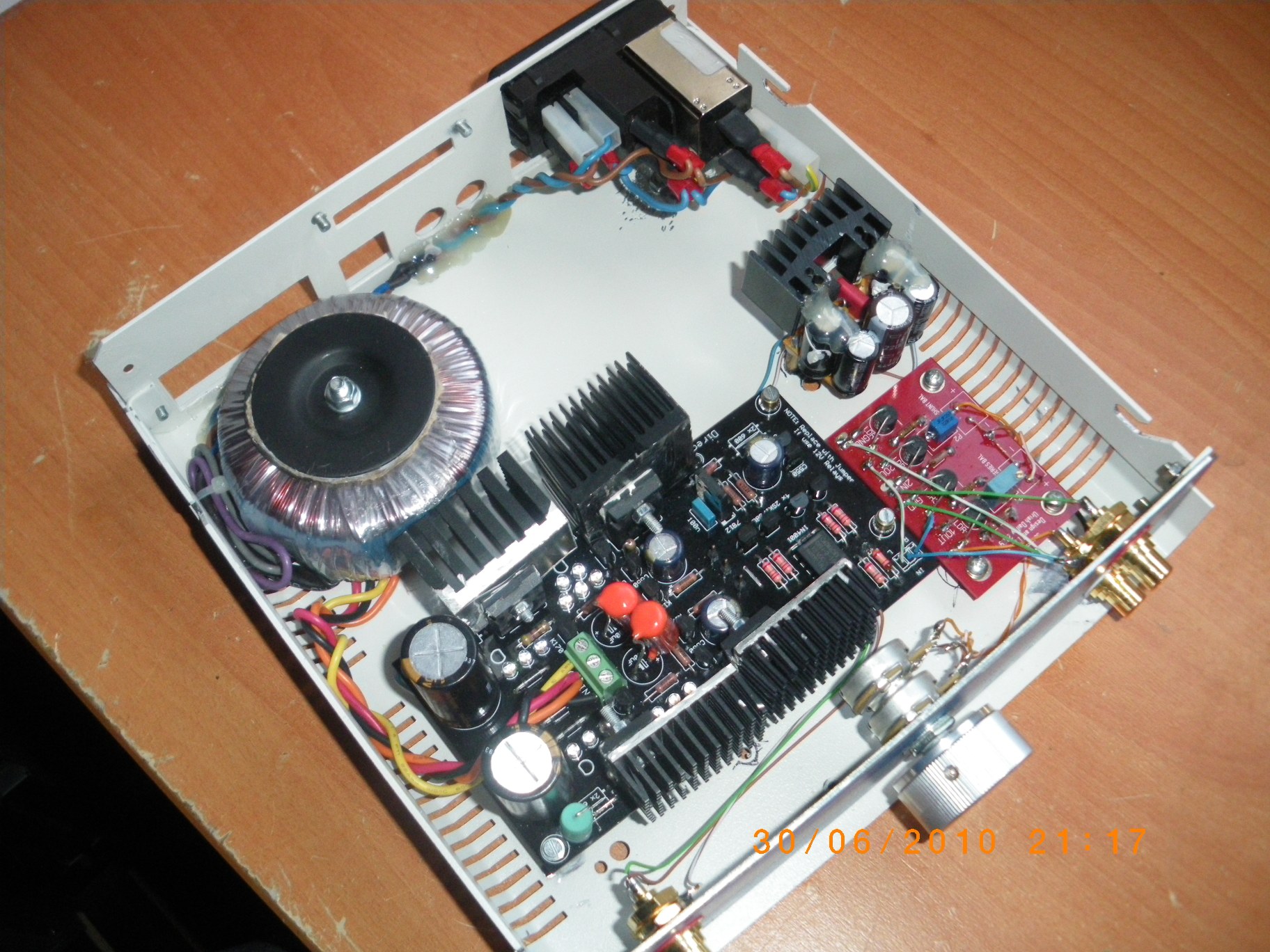

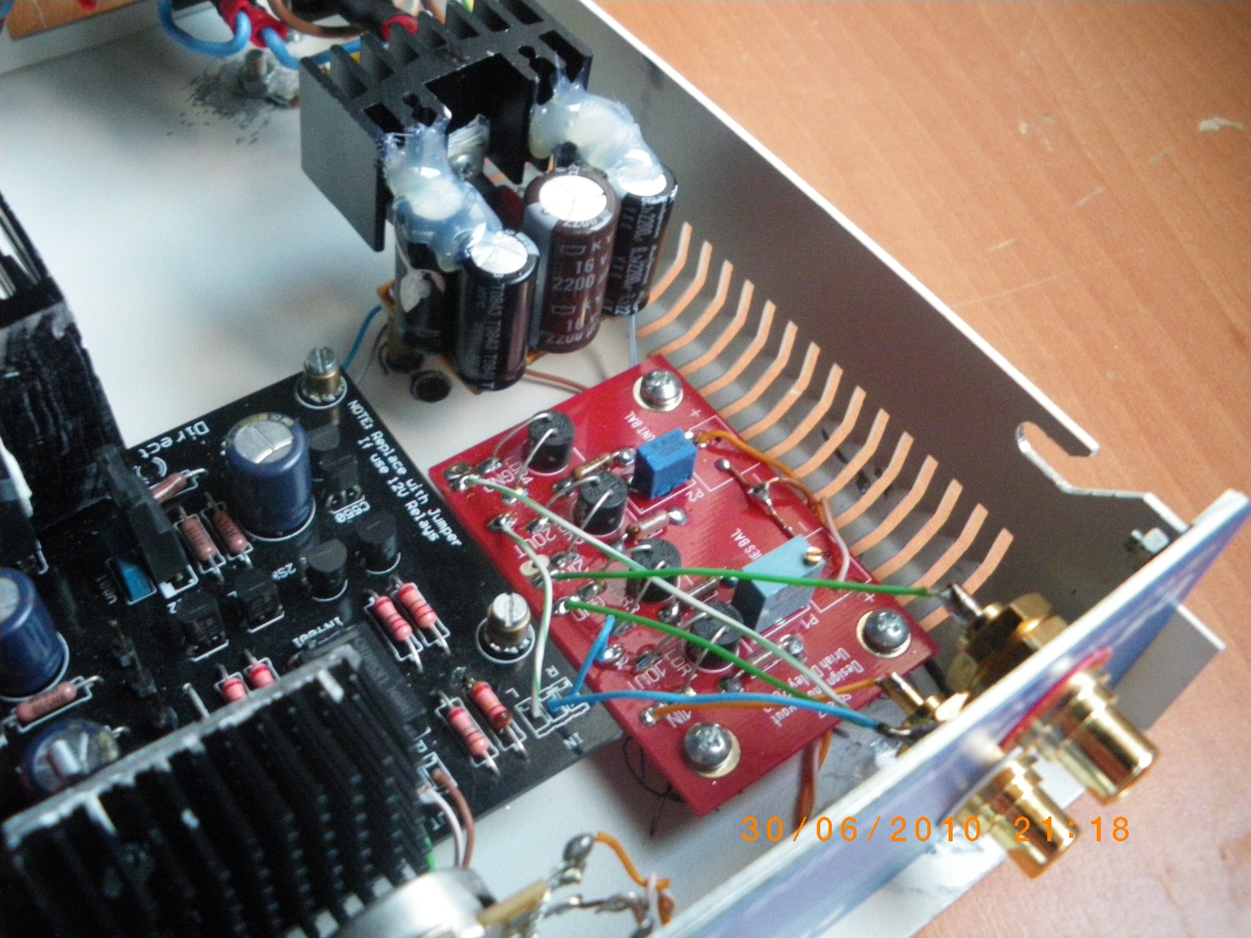

I connected my LDR board grounds the same way, but on top of the board.
Mine ended paired with a DCB1 buffer with the bypass capacitor mod, the CCS current crancked up and Takman resistors. It sounds and measures extremelly well.
In my volume control I havent used the 5k pot, because I don't want a balance control. So i placed another 200ohm trimmer and a pair of 100ohm resistors with them.

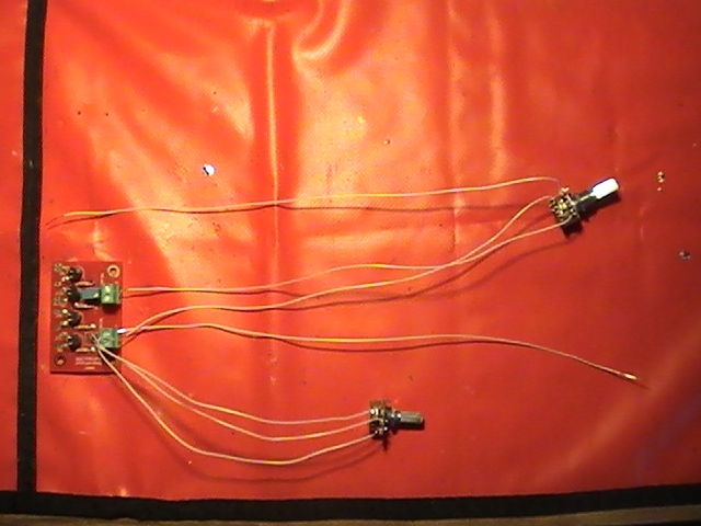

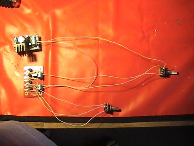

Attached is the LDRs and board from Uriahs kit.
