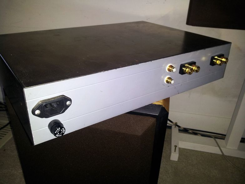

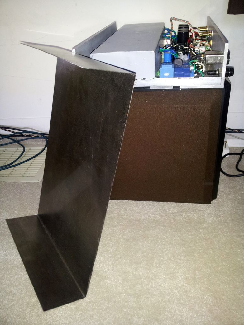

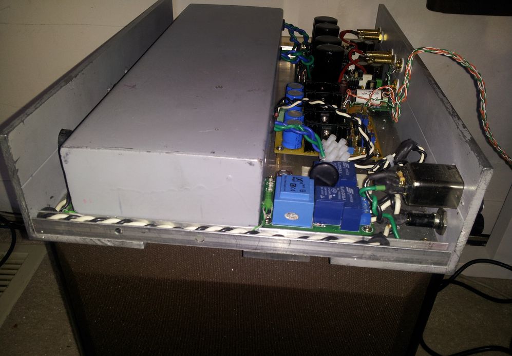

Thanks for the kind words, Bob and Andrew.
One more note on striving for clarity: I have been running my amps "topless" because I've been fiddling with them and the active xovers that are both in the same chassis. I think I'm done with that, so I put the tops on the chassis and it resulted in what I perceive to be a significant improvement in clarity and depth. I guess these amps are susceptible to air borne vibration. I don't think I have a problem with RFI, but perhaps the covers also helped isolate the circuitry from any minor amounts and that contributed, as well. My chassis are nothing special--just thin aluminum. I used some damping material around the PCB mountings on the bottom of the chassis, but nothing special to damp the tops. Just putting them on made the difference.
All you builders with "bare" amps, try closing up your chassis and listen if it makes any improvement in the sound.
I intend to experiment further with isolation from structural vibration, as my amps sit directly on the floor (well, with elastomeric feet on the bottom) near the speakers, and I can detect slight vibration of the floorboards when bass is playing. I was always a skeptic about the need for amp stands, but these little amps might benefit from a combination of isolation and mass loading underneath them.
Peace,
Tom E
lehmanhill and I believe one other builder are doing a speaker mounted placement. It will be interesting to hear what vibration does in that situation.
The integrated build suffers no such problem as it was built with two 3" X 3" X 1/4" aluminum channels and a 1.5" center brace. Not necessarily intended for dampening - just what I had in the shed at the time. The transformer cover is 16 ga. and chassis covers is 20 ga. steel. The whole mess comes in at just over 38 pound.
All my auditioning has also been with the amps on the floor between the speakers, but in my case resting on thick carpet and pad. If I ever get it on a shelf I plan to use speaker spikes and pads for an experiment. I'll do some cover on/cover off tests and post the findings.
If you havn't seen it, Mick Feuerbacher has an interesting approach for the PS CD player in this area.
I can't imagine a worse place to mount any amplifier than on a speaker, inside or out. Every part of a speaker enclosure vibrates almost continuously. What is to be gained? The pros do it only to simplify an active system. I'm sure they use extraordinary means to damp the amp, and it would probably still benefit from being mounted apart.
Seems to me a seriously misguided design decision with zero benefit.
Peace,
Tom E
