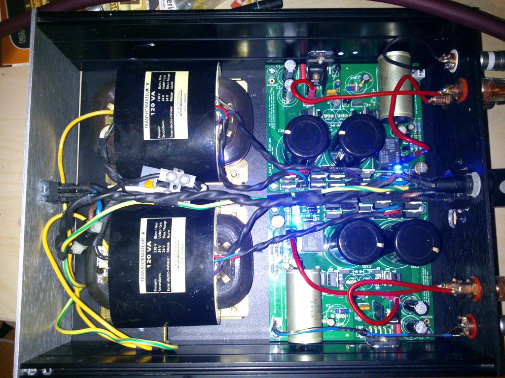

what would be the best option to install FE in this rather small box:
I'm sorry but I really don't think, as I've already said, using that small box for both modules it's a good idea.
I suggest you to buy HiFi 2000 1GX288, it costs 30€ and you can fit all things inside it:
attachment.php

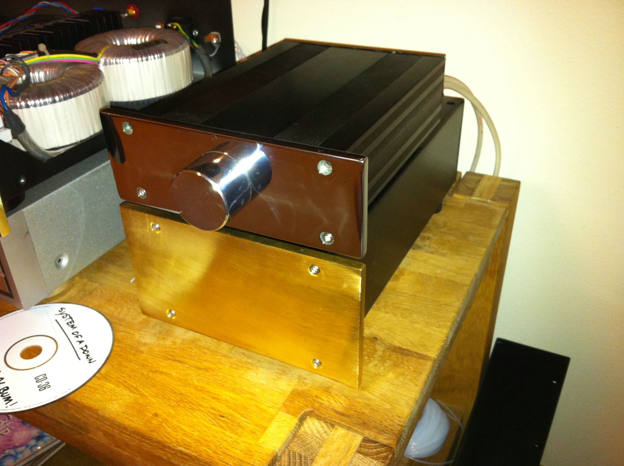

I need this rather small enclosure to match my Preamp/ DAC, otherwise I would have gone for a full size one! Anyway, thanks!
Just being silly again Andrew. 😉

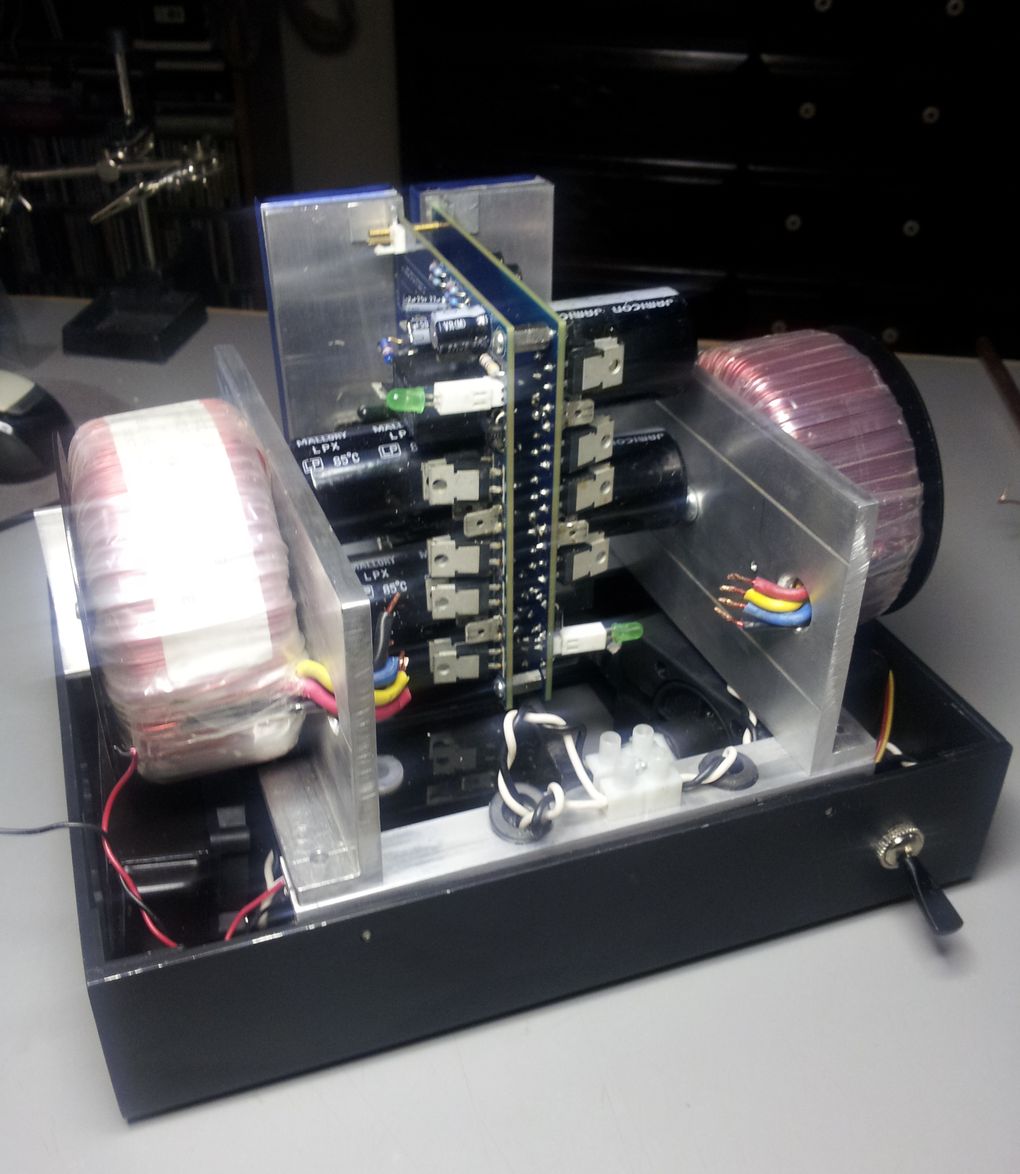

I am however, like dtses also doing the squeeze play on a build for the beta boards. The BLAT should be up and running in a few days and has a 7" x 10" footprint. Hope to have a full build thread/blog up by the weekend.
