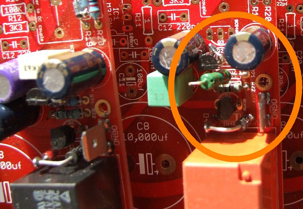

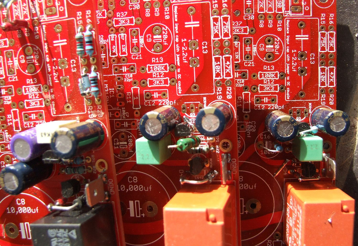

I am trying to attach a pic of three different ways I modified the components & layout for the MyRefC. Don't have the schematics to hand since it was done about 18months ago. Never finished the PCBs after I heard the first one. Discrete wins every time.
finally got Irfanview downloaded to my new PC.
Sorry about the dust, just picked them up off the shelf.
Note the two Zeners for R19 on the left.
All the drivers have a Zener in the circuit to increase the triggering voltage.
The right shows a link below and slightly to the right of C16. This is an extra resistor that comes under the PCB from R23
Note the series Zener and diode across the relay coil for faster release.
How I wish when editing that the Forum software did not lose attachments. I have had to attach again during each edit.

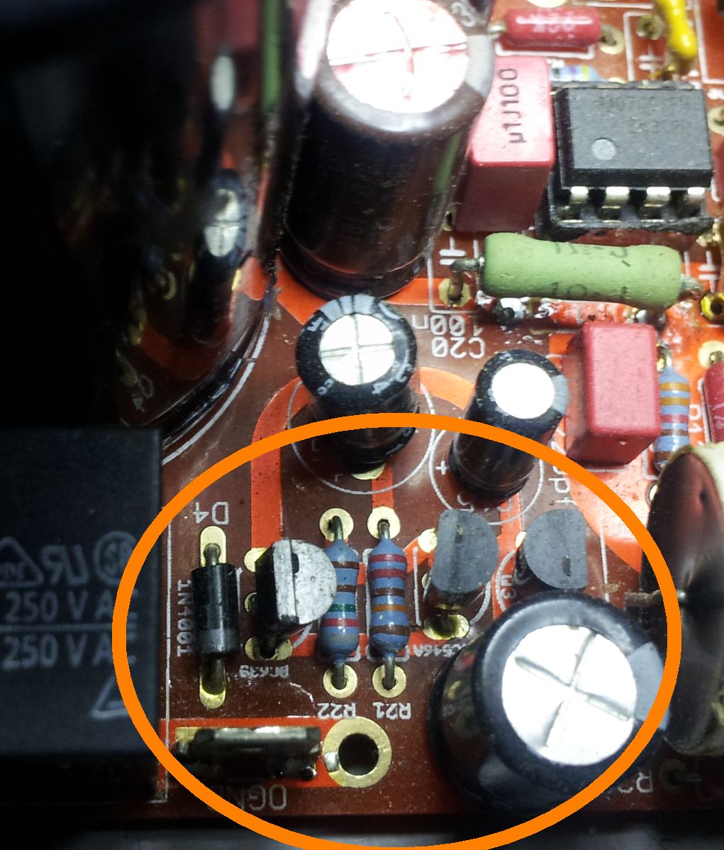

I checked things out again this evening and have the following readings.
Good channel :-across main caps +- 28.5v C102 14.67v C202 -14.38v
across the relay diode 14.98v R14 is dropping approx 6v
With the input shorted ther is 1.5mv.
Bad channel :- across main caps + 28.25v - 28.34v C102 14.32v C202 -14.67v
Whilst checking these the relay starts clicking on and off before staying off;no led and I end up with 11v on the input and 26v on the output. I am at a loss as what to check!
Going to a friends tomorrow who has a good camera system I'll get him to take some high res pics to post maybe someone will spot something I've missed.
Forgot to say things are run from dual 20v secondaries just to check it out.
