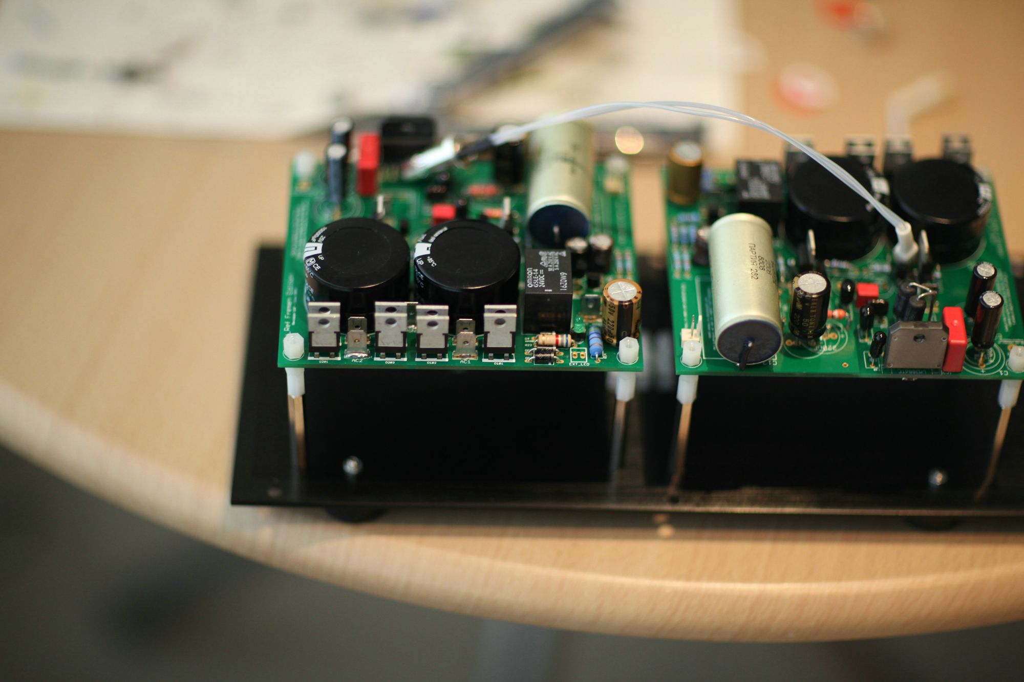

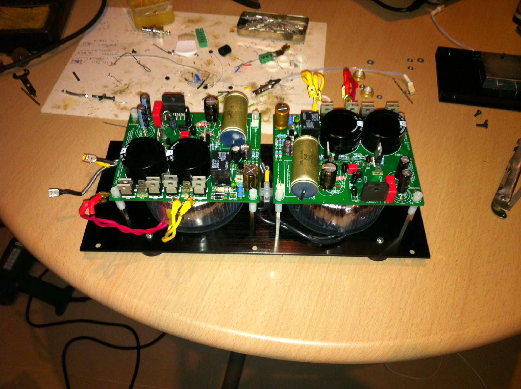

The saga continues.My friend suggested I replace/resolder D1 which was slightly of square which I did this evening and having powered up all voltages appear ok and there is 4.3mv offset and 14.58v across the relay diode.It has been sat on the workbench/dining table for the past 30/40 mins without anything untoward happening.I think it might be good to go 😀

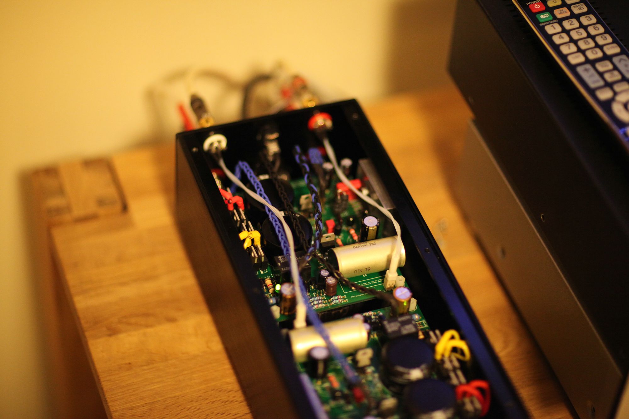

I have great news too, finally got the caps and almost finished the case, only the front panel is left now. Works fine, the case is barely warm (ambient is +27) after an hour of movies on moderate volume with a closed lid.

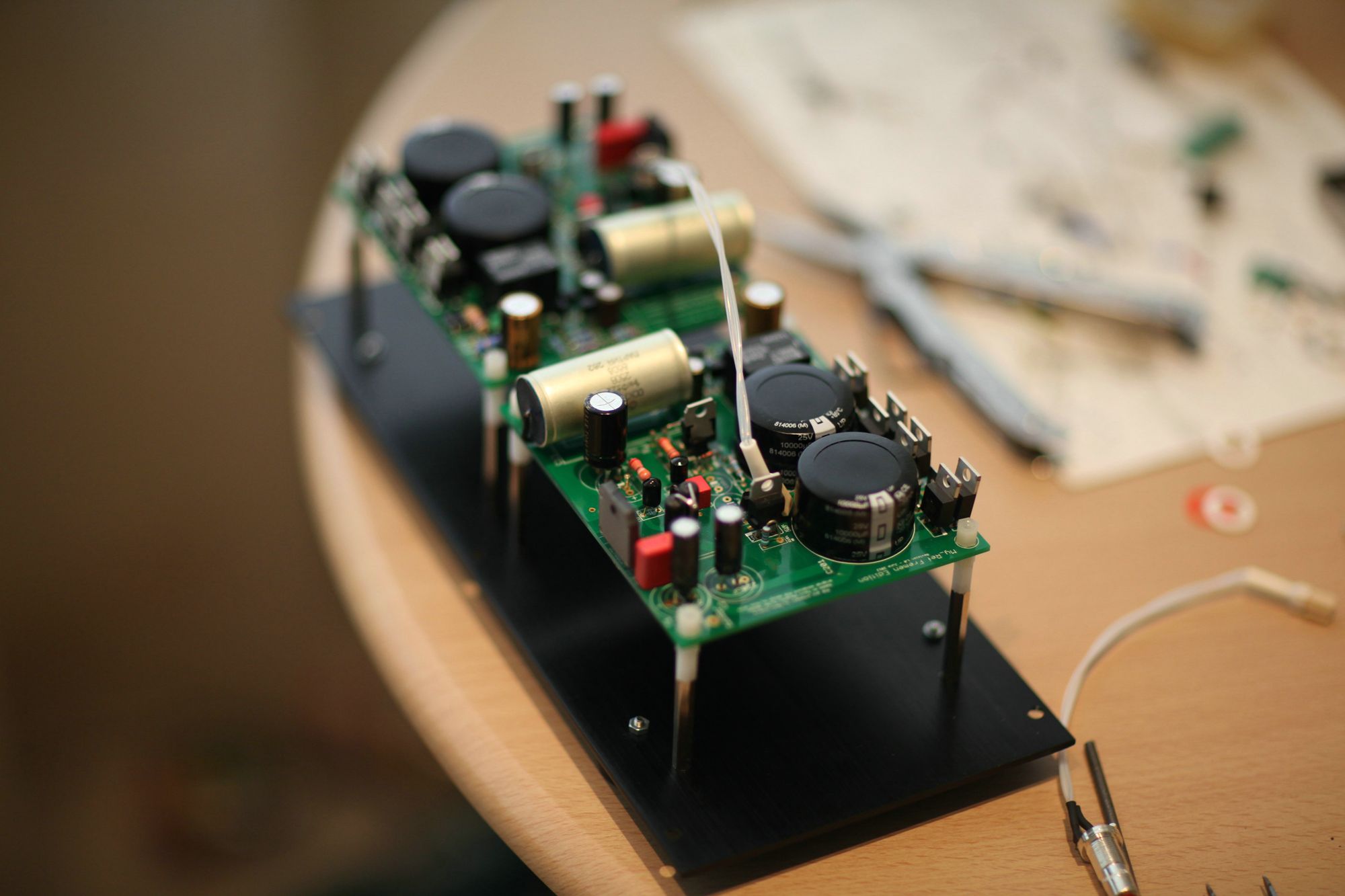

One board is soldered with Tackmans instead of smd part and shows 0.8mv offset. Other uses Vishay smd resistors and cement 0R47 (for testing purposes only) shows 4.5mv offset, still acceptable, though not sure what caused the difference.

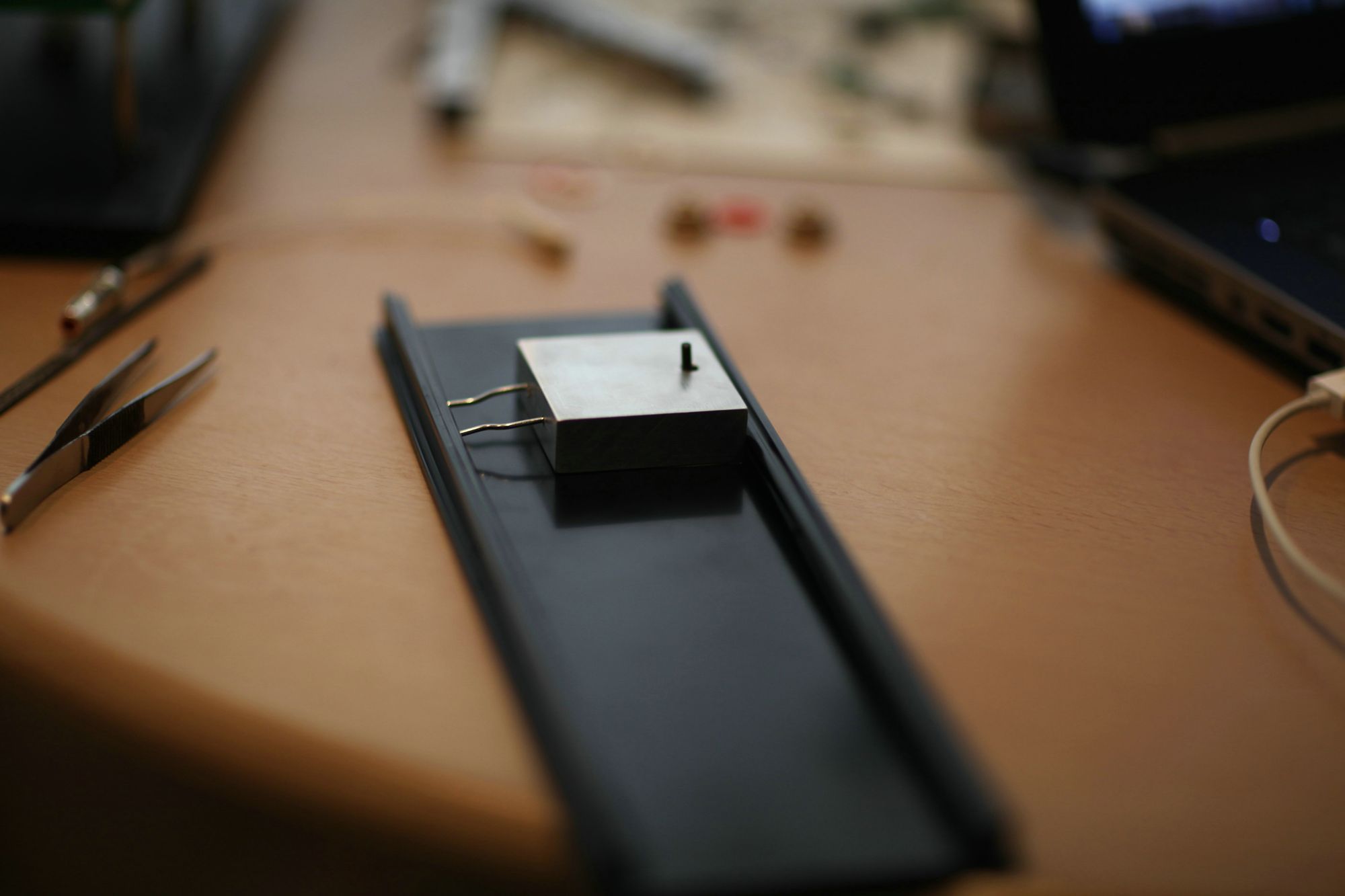

Chip goes to solid aluminum plate 16x50x50 that is tightly attached to the case, thermal grease between them, no bolts used here 🙂

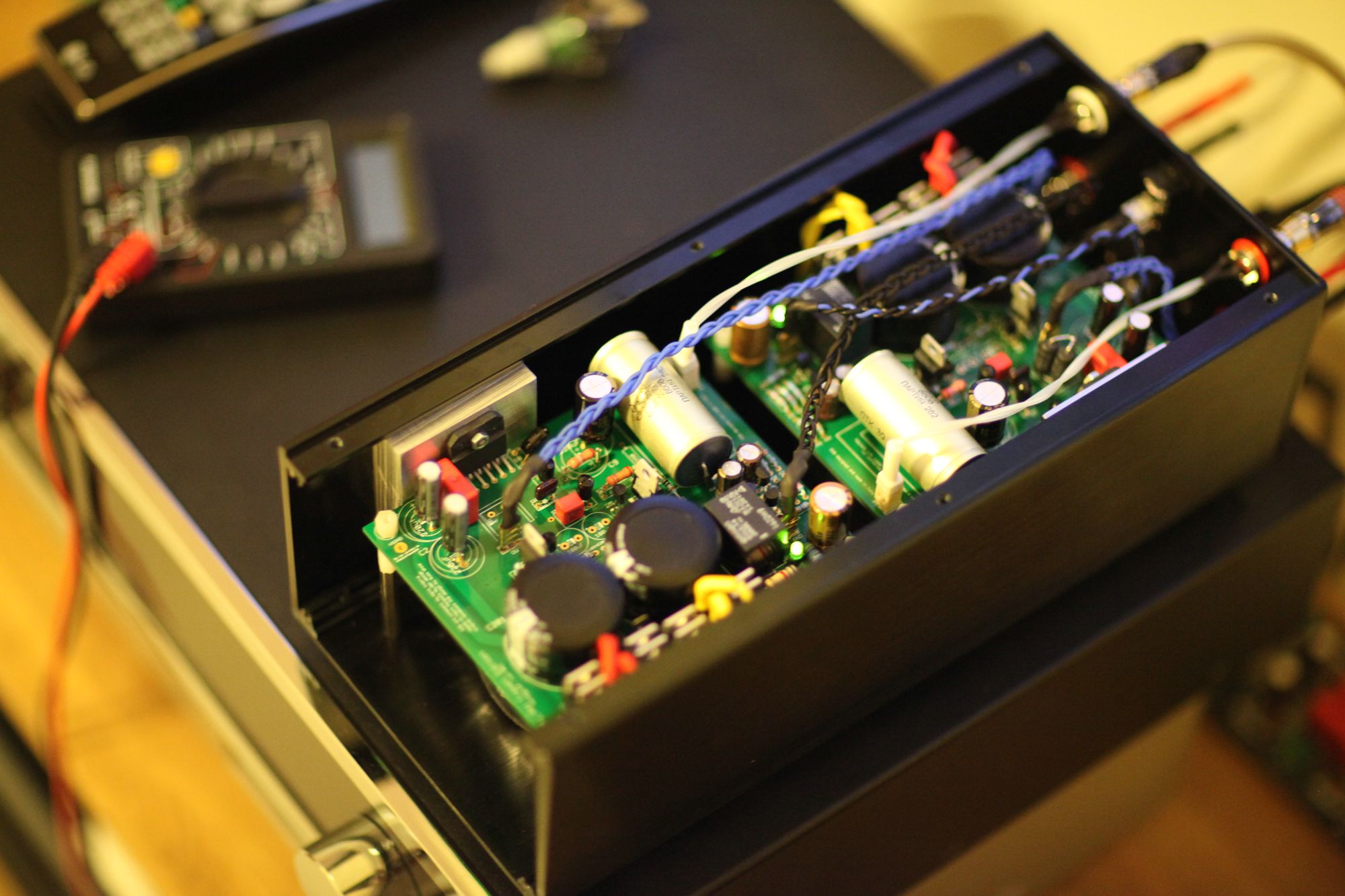

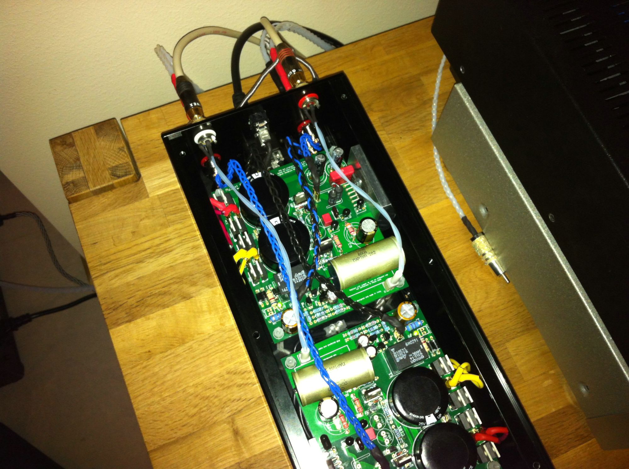

Remains of Kimber 4TC used from the boards to binding posts. Used CMC silver plated RCAs (actually didn't like them) with solid silver 0.3mm wire for the signal.
Will add 0.3-1mm aluminum shielding later between the boards and toroids.
What else to say, amp is dead silent and is my first diy PA! thanks to all guys here for helping me, especially Dario, AndrewT, Bob 🙂

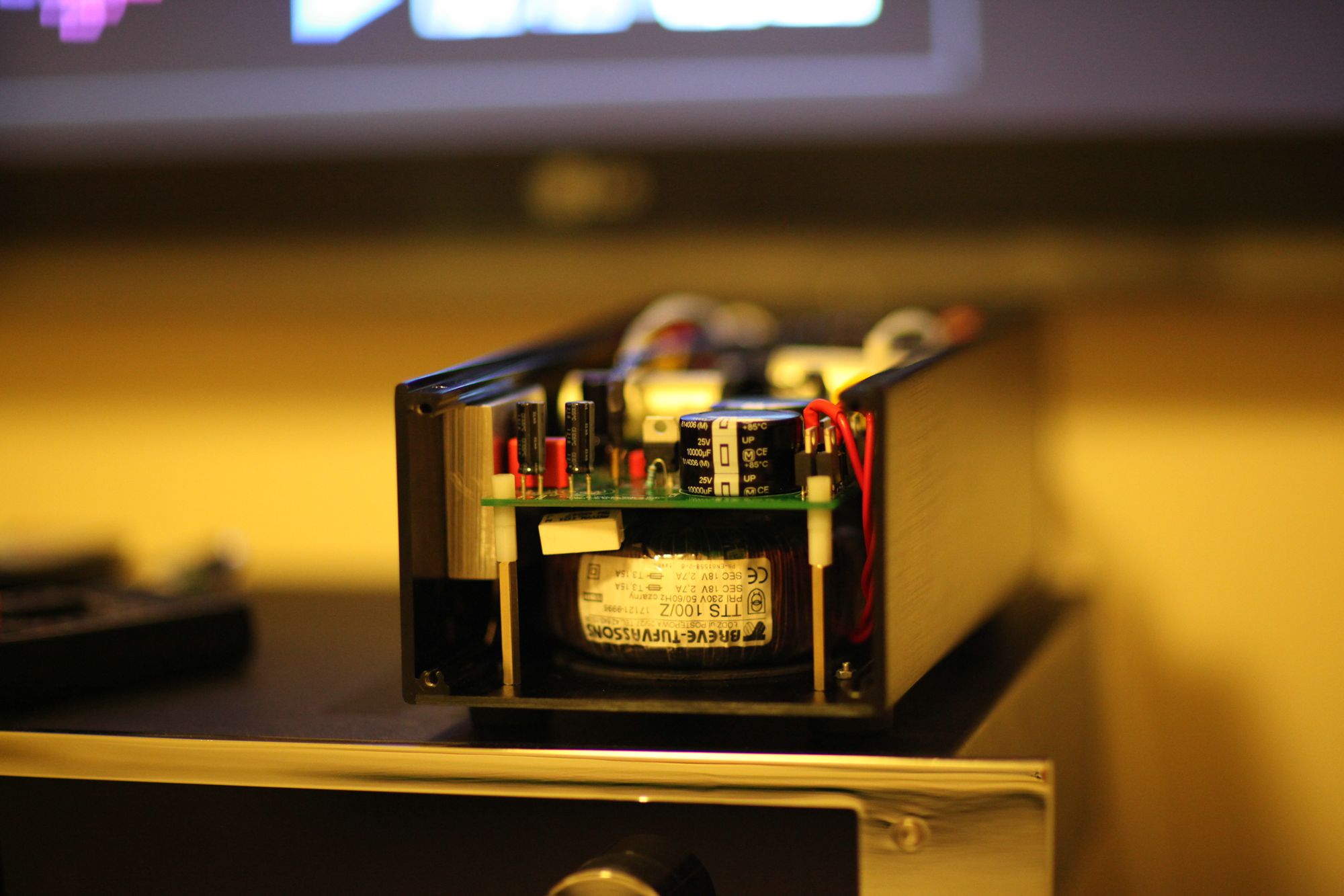

Great to hear that Dtses. You have a nice enclosure and also very pro pictures.
The two large capacitors looks a bit strange to me. What kind they are ?
thanks!
Unfortunately this is the only lens I have now so looks a bit blurred, other pics are made with iphone 🙂
Caps are Panasonic 35x20mm, weird size for me as well, I ordered them from Germany, so hope that these are genuine.
I see you are using 2x18v AC this gives you 25v after rectification theoretically. Dont you think your caps are on the limit on their working voltage ?
I'm always trying to use caps al least 5 v over the voltage.

That's one of the best uses of a small chassis I have seen. Classic simplicity !

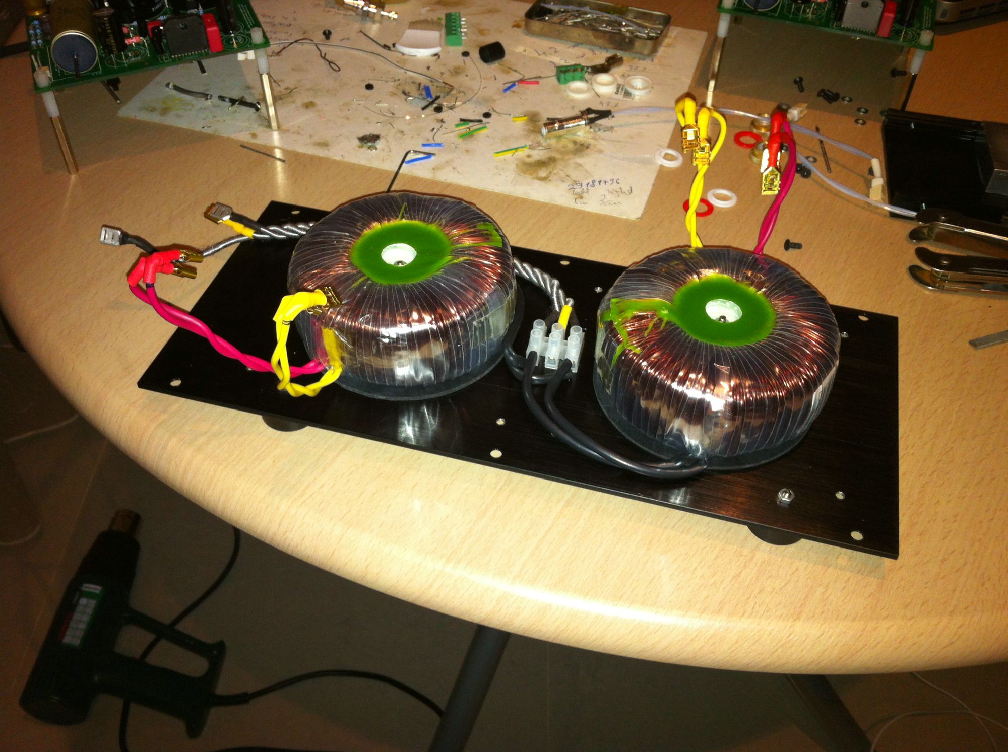

Was interested to see if there was any interference/hum with the toroids being so close and parallel. Sounds like it worked just fine. Of course I think the braided leads are great and you have a super clean and efficient wiring layout.
Are you planning to include some bottom to cover convection ventilation? May not be necessary but wouldn't hurt.
Beautiful build and thanks for sharing.😎

same rule for me. Unfortunately no space here for 40-50v caps. There were several alternatives to these PANAS that also fit the chassis - Elnas and Mallory, though I stayed with Panas more because of the price and that parcels from China should be waited for more than a month.
So I've got very close to 25VDC on them, 24.5-24.9VDC depending on the mains to be precise. Hope they could withstand that voltage for some time, alternatively I could always replace them later as there are options. Btw, I'm not planning to use the amp for many years, perhaps it would be sold later as I've already had an idea of ideal FE where four monos are placed in the same chassis (standard size now) and that would be a wonderful solution for biamping 🙂
there are no ventilation in this case at all! I know it's bad, but it feels hardly warm (chip, solid aluminum plate, both walls of the case) after a movies is played. Of course, I'll need more thorough and loud testing, but I was very surprised with these results. My plan is to add ventilation anyway, it would be done via laser by adding several long holes on both lids.
