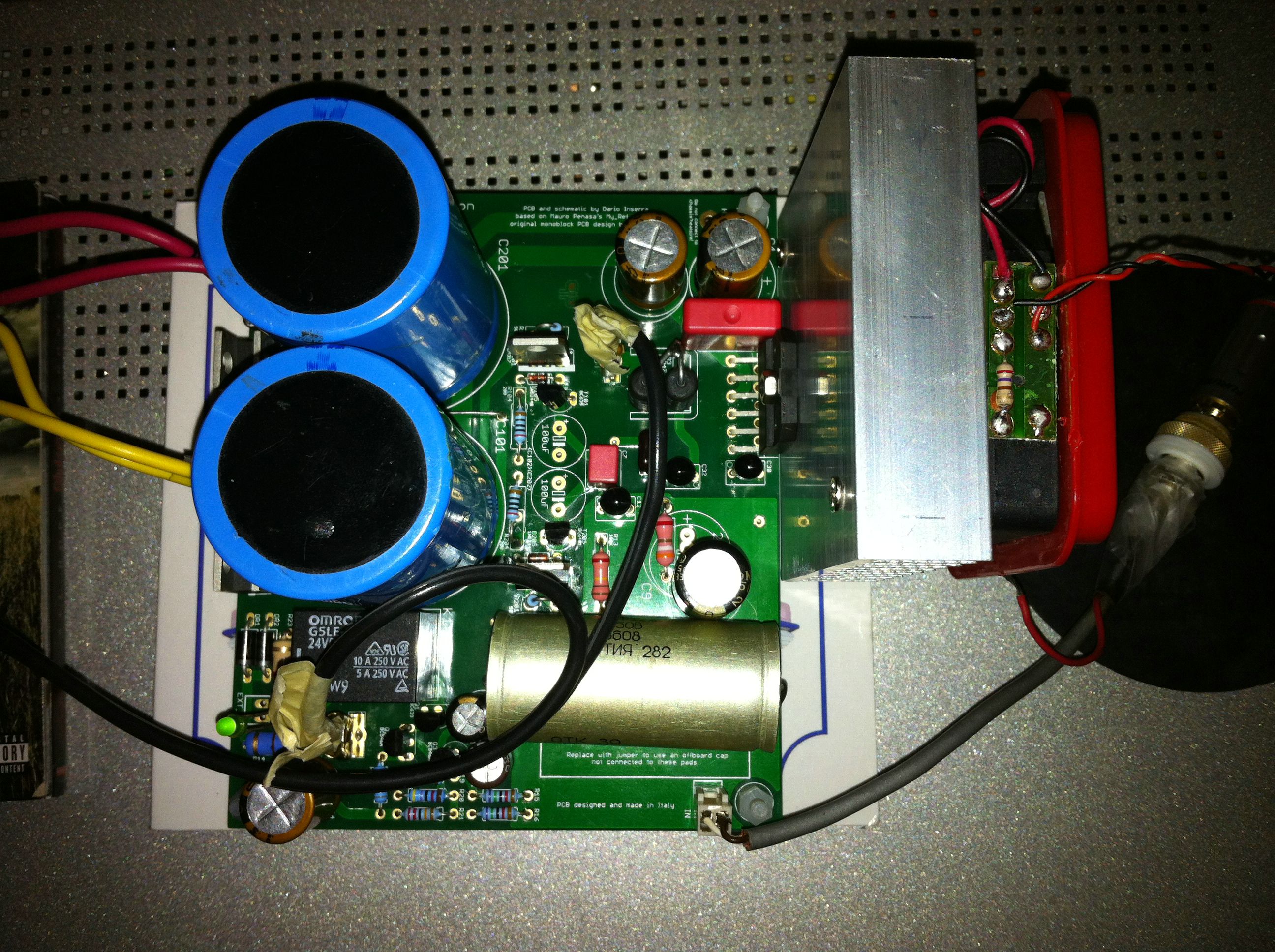

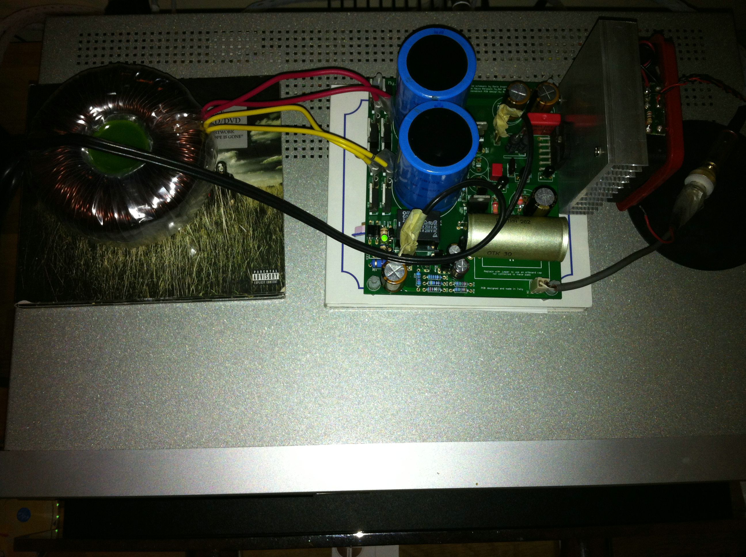

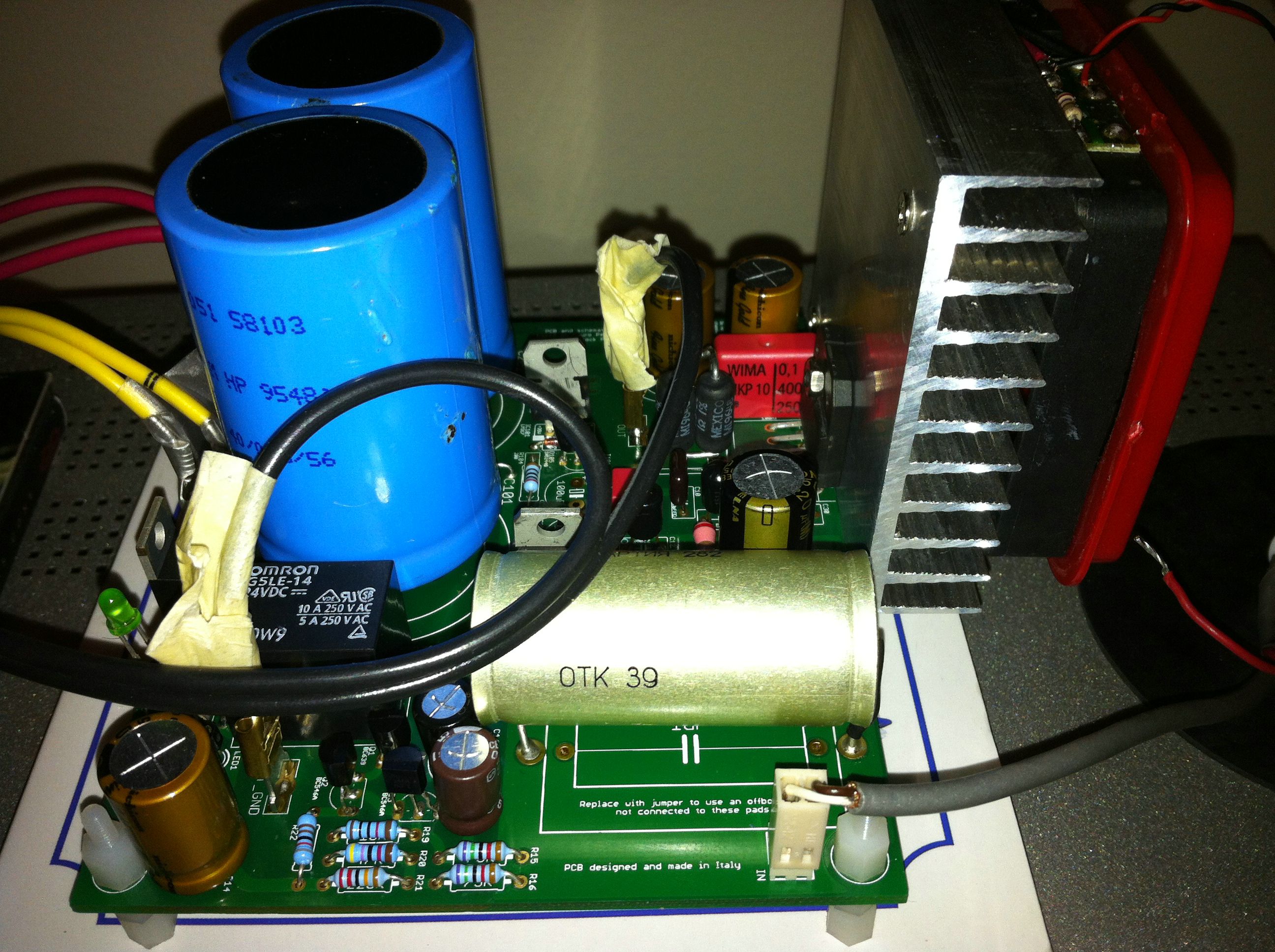

mine has very noticeable grounding sound (not placed in enclosure yet) - some kind of low frequency hum even if the pcb's input socket is completely disconnected.
With input disconnected a slight hum is perfectly normal but it should disappear completely with source connected.
the preamp I use has approximately 3x gain, 10k Alps pot and it seems it's a bit overkill. Is everybody using just a pot or some passive preamp? What would be better?
I'm using plain 10K pot, DCB1 with 10k pot, AV receiver pre-out without problems or hum.
I've built too a JC2 but I get hum.
BTW no preamp is needed with the MyRef (Rev C or FE)
every time I switch off my preamp I get very loud snap or crack in the speakers, then relay clicks, LED is off and amp needs to be turned off and on. Is there any simple output stage that could be added after opamp to prevent this? Moreover, I have already burned somehow 1R resistor and T201 doing similar switching yesterday, not sure was it the volume level or the series of turning on and off my preamp, but in the end i've got not working FE and spent hours to figure out what was fried... :D
This is not normal, definitively.
Are you sure you correctly wired signal hot and ground return?
If you invert hot with ground return hearing hum is a certainty... ;)

One more thing that would like to clarify if that is normal behaviour. Once I connect socket to the mains, push the switch on button, FE doesn't start, it does only when the switch is turned off and on again. :confused:
The other a bit confusing thing is if you play with the mains switch for several times - FE doesn't turn on any longer, you should turn it off, wait for 2-3 secs and only then it's working.:confused:
thanks, Dario, for help :)
You're welcome :)
could you please eleborate this? did you mean pot?
No, I mean connecting source hot to FE ground and source ground to FE hot.
There is something wrong, this beahviour is absolutely not normal.
I would check all resistors value and correct assembly.

dtses, are you using sockets in your build? If so, are they maintaining good contact? A loose fit can easily interrupt the circuit.
hi mate,
I'm pretty sure that the contact is good and tight, this shouldn't be the problem.
indeed that helped :) checked all resistors and R2 turned out to be 270R instead of 10k, I should have checked that in the shop, their mistake. At least one issue is solved - relay and LED works perfectly now!

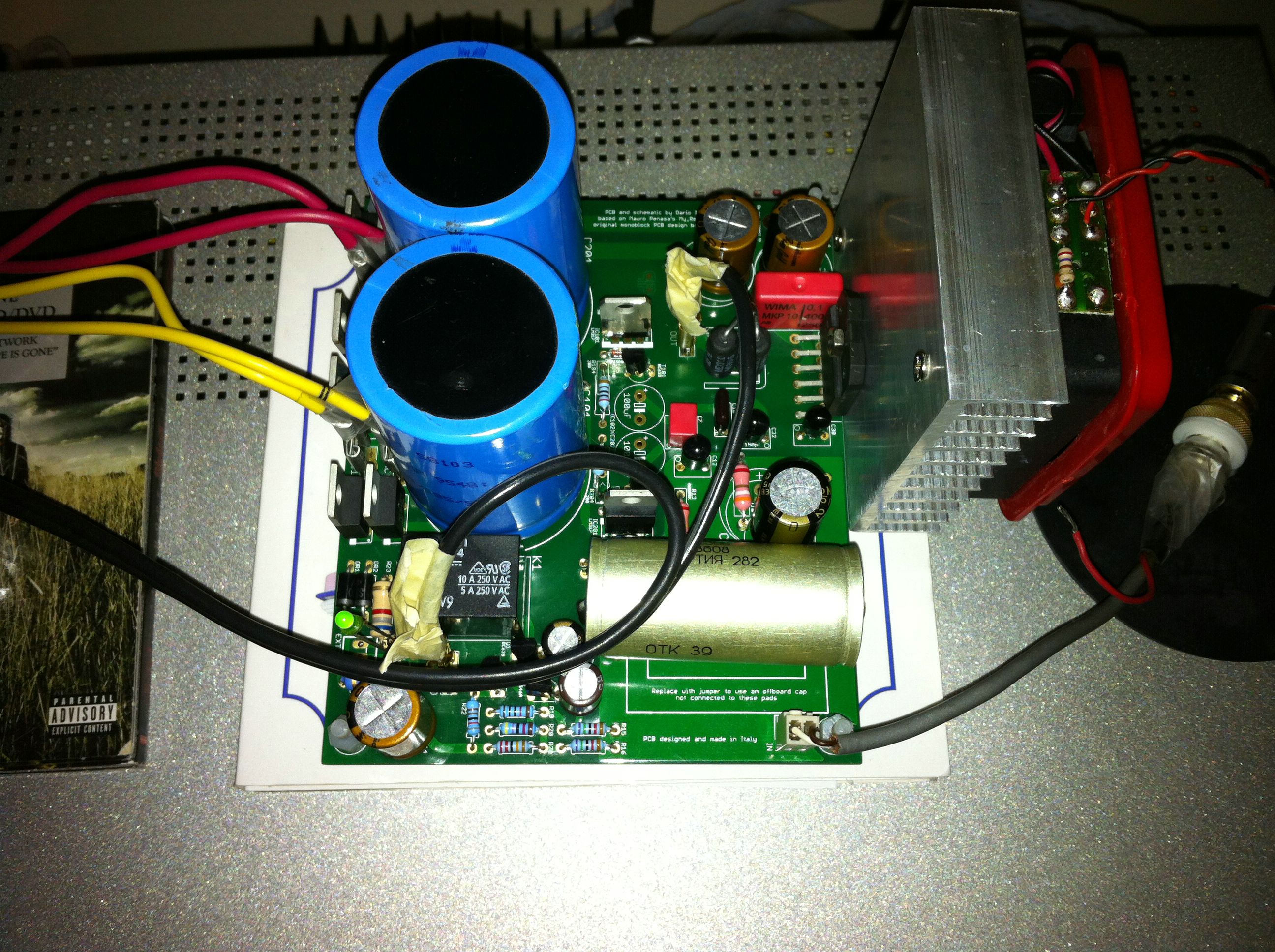

However, I assume the problem is somewhere else as I have tied to run FE simply with a single pot nothing else and I've got the same grounding hum. I do not use any chassis or metal things that could cause that, so I'm really confused now...
There are several things that I would like to say more:
-testing assembled channel for several hours I've got only 1.6mV DC offset, actually didn't even expect it to be that low :)
-with rather trivial heatsink (it's only temporary on the pics) amp gets only to some 40-45c, not more.
-the PCB is so splendid, I've got the most pleasant soldering experience I've ever had! I would compare it with my favorite Italian vine Brunello di Montalcino. Perfect look, fragrant smell, unforgettable and very distinctive taste, feeling that you are drinking/ soldering indeed something very special! DARIO, don't know how did you manage, but it's outstanding! both the pbc and the work you've done!:)
-I have burned R11 (1 ohm) once more time by my mistake. Perhaps it would be better to use some 1w or even 2w resistor here?
One thing I was really disappointed:
not sure if that is so or that grounding sound I experience somehow affects on that, but I feel some kind of bass leakage in comparison to my modified Restek Fantasy that is kind of reference for me. I feel it's not so deep and articulated in FE and the bad thing is that it's quite noticeable. Again, not sure if it really should be so...Perhaps Dario could elaborate this :confused:
I have attached the pics. There are still several parts I'm waiting for, so temporary put these big 10k uf caps, few resistors, heatsink with a fan (didn't even turn it on, no need).
Did you checked hot and ground input?
Connectors?
Really a good result. :)
the PCB is so splendid, I've got the most pleasant soldering experience I've ever had! (...) DARIO, don't know how did you manage, but it's outstanding! both the pbc and the work you've done!:)
Thanks! :)
Yes, the italian PCB maker done a much better job than the chinese one I've used for beta boards. I'm really satisfied (the italian product cost much more, though)
No, that resistor is also a sort of safety measure... it's better to change a single resistor than much more costly parts...
You're using a different BOM so result may vary... but on this post on the beta thread you can see that I was using a Takman too and had similar problems.
Simply reverse it. ;)
