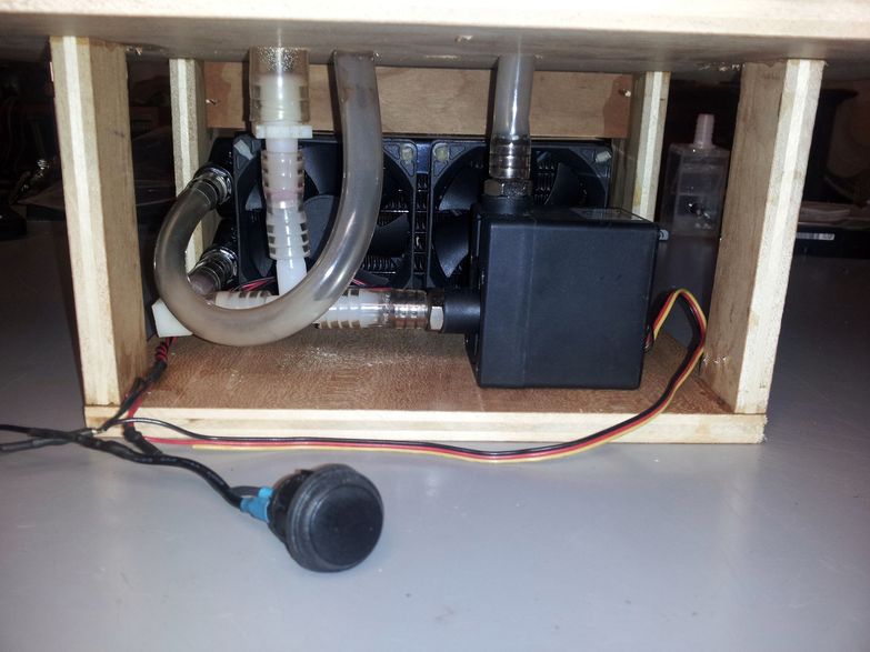

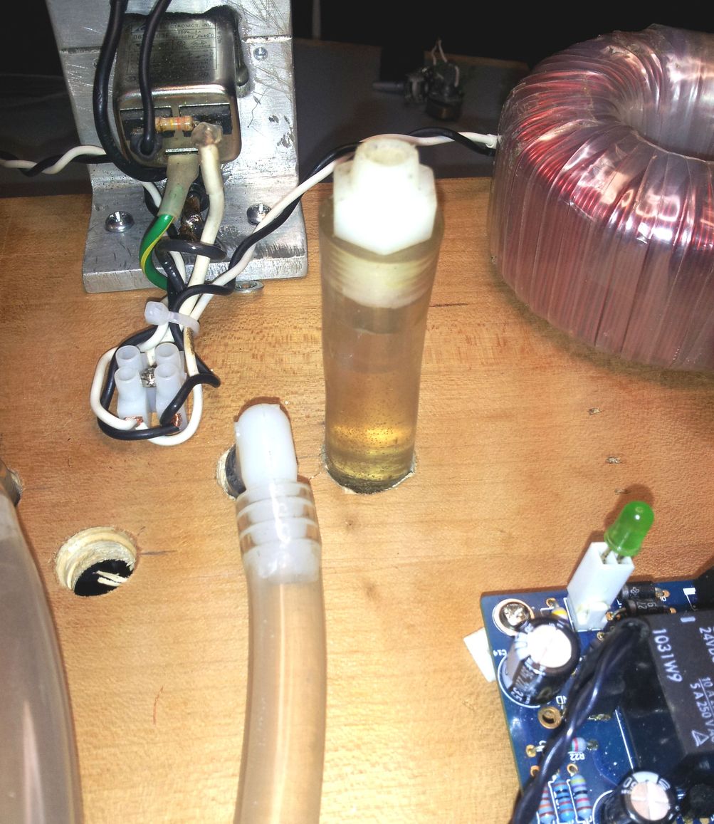

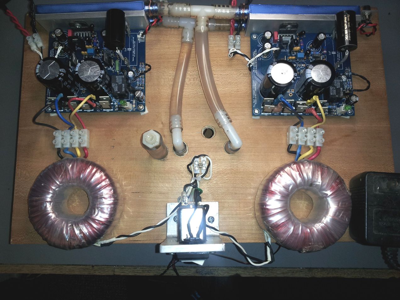

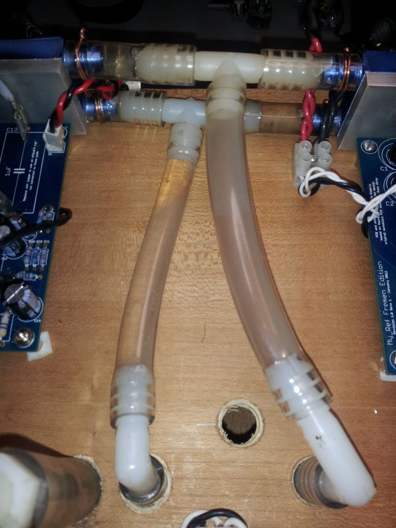

IT"S ALIVE 😱

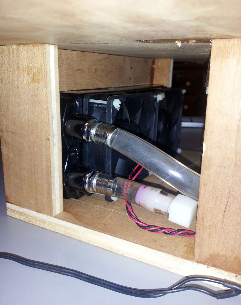

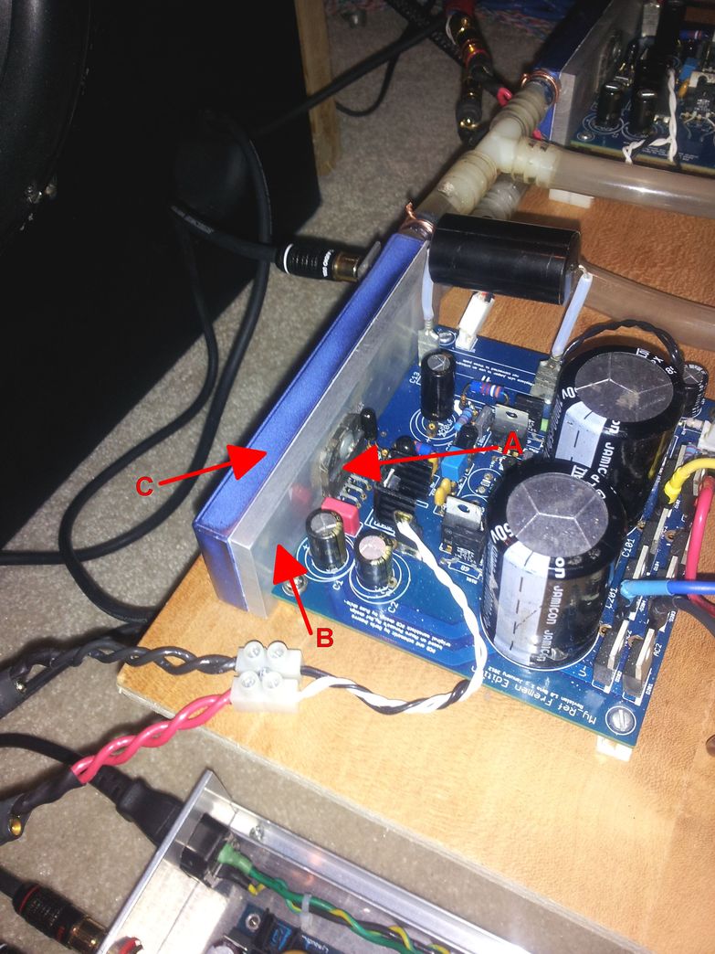

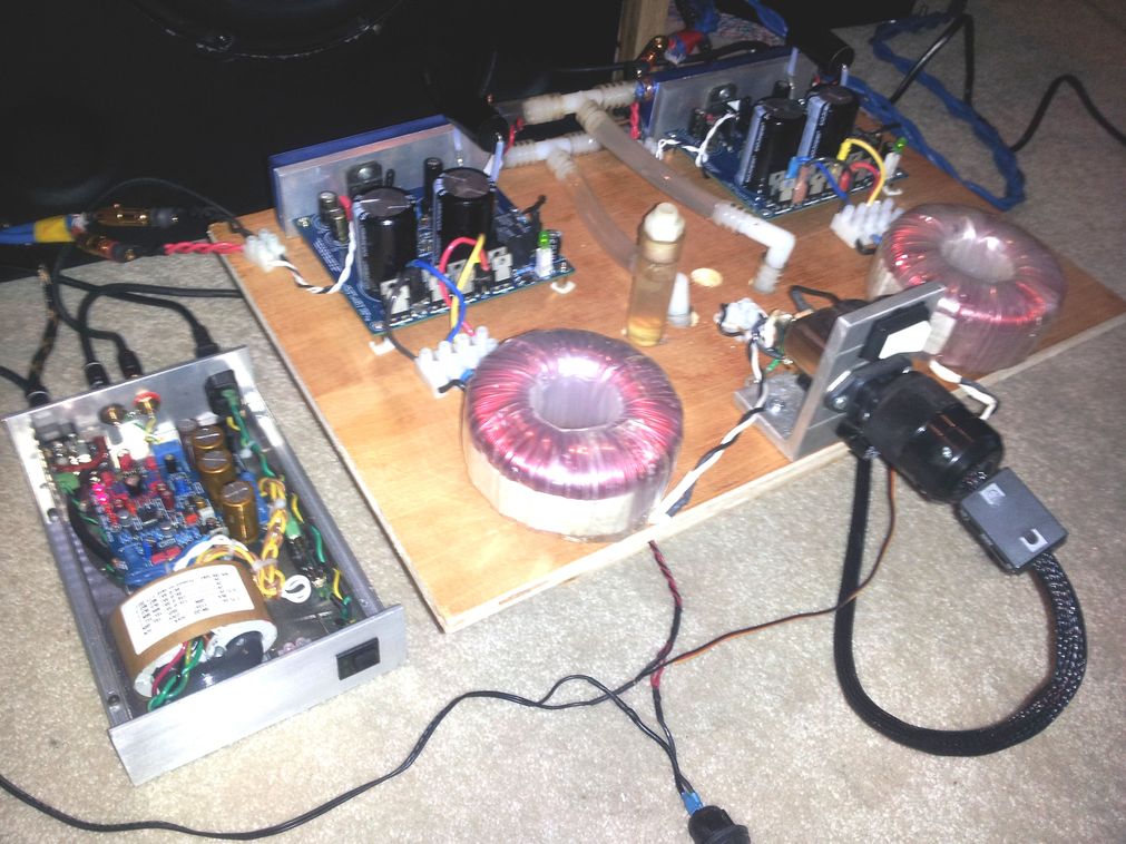

Bomac Liquid Audio has passed beta. 😀 A fun project I've been thinking about for far too long to admit.
Honestly, I haven't done direct comparisons with air cooled HS and listening tests to see if it is worth the effort. The results are as follows:
The standard HS settles in at about 115 - 117 F with room temp of 70 F.
After 45 minutes with liquid system active - level of 87 db @ 14':
Left amp - A =90.5, B=80.3, C=72.1
Right amp - A=91.4, B=80.9, C=72.0
After reducing the level to 76 bd for 30 minutes:
Left amp - A=83, B=74.3, C=69.0
Right amp - A=81.6, B=72.2, C=68.0
The most obvious is the A/B gap. I attribute that to the use of heat transfer tape as opposed to a thin layer of paste. Not sure why one side is cooler than the other with the tee configuration.

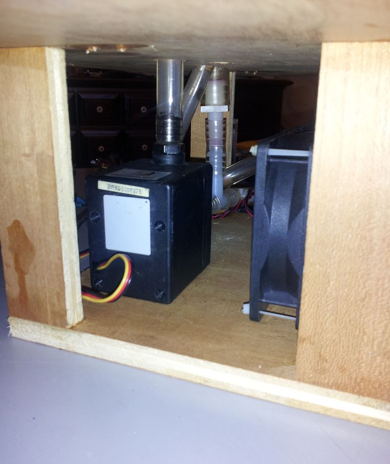

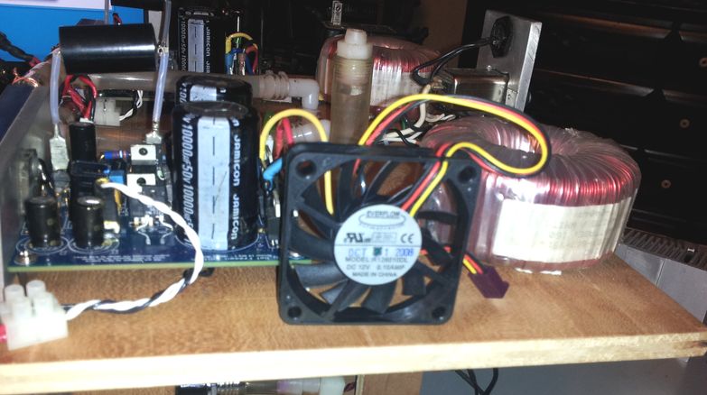

The pump is absolutely silent but the fans are not:
@ 2" = 60db
@ 4' = 51db
@ 14' = too low for meter to read
I don't consider that a big problem as a rheostat on that line can actually provide an improvement. This pump runs full speed, but both fan and pump at lower speed improve heat transfer from the radiator. The options are a single fan, or using the 70mm format as shown in an earlier post. The 70s (complete system) could easily fit in a standard 17" chassis. The fans are standard PC units and much quieter devices are available. This is the radiator used. I built a small reservoir but used the "T-line" to reduce the volume of liquid.
I'll play with it more next week, but I think there is a useful potential for adventurous builders. 😉

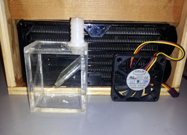

70 MM comparison and mini reservoir.
