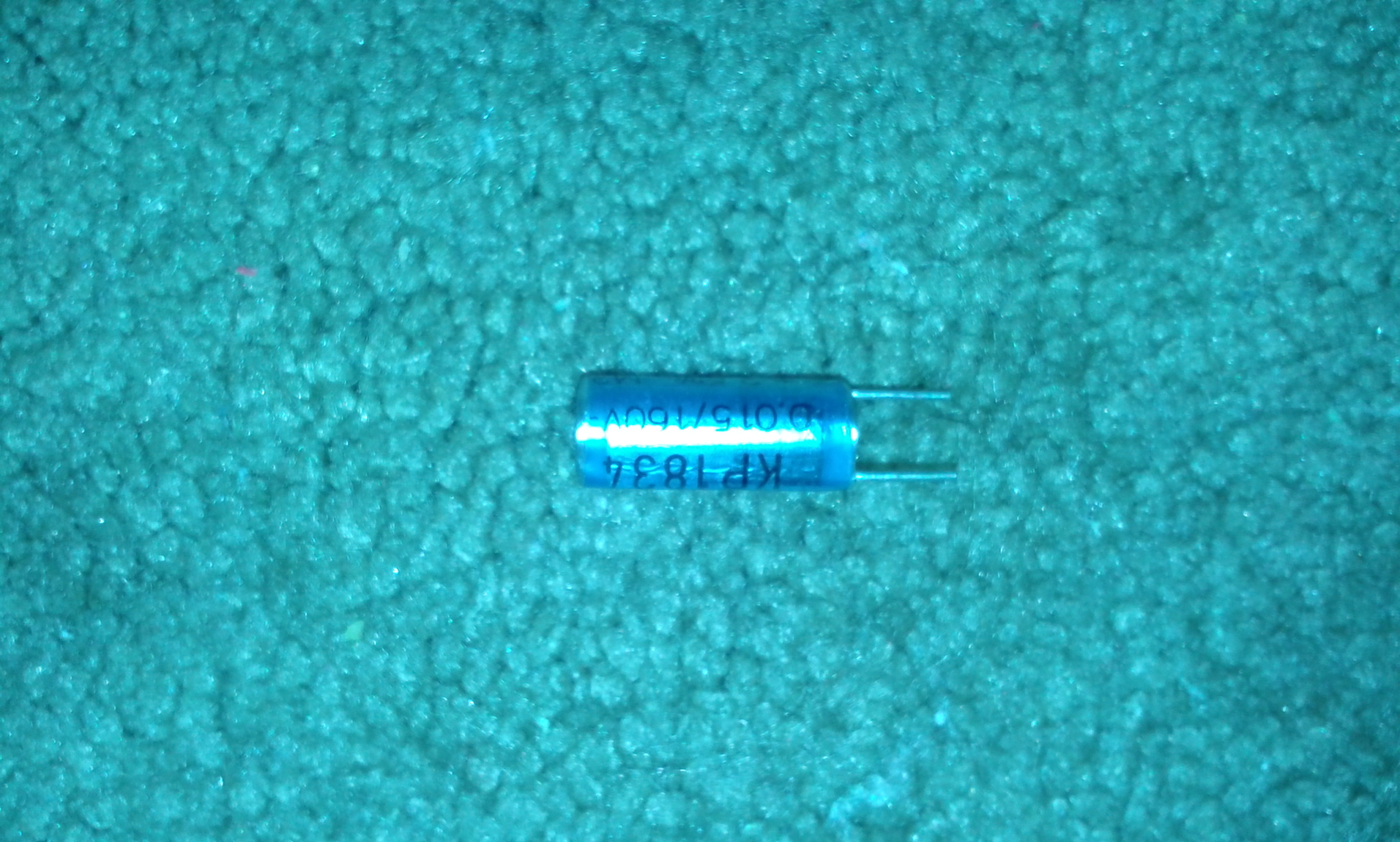

I have attached picture of my 15nf polistirene caps without yellow dot. Where should be the dot ?
They're for C7, right?
If they're 15nF they don't have any yellow dot.
The KP1834 marking shoud go toward the LM3886 but I would try it using sockets (the right side is the sweeter and fuller one)

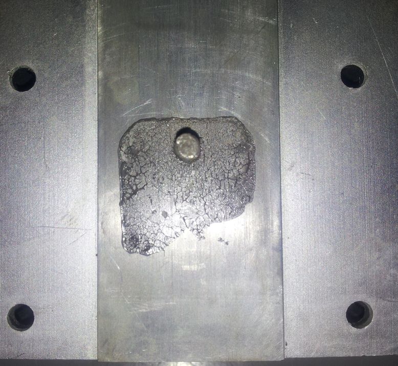

Should i be worried about this Spike protection that activates so soon ?
It depends... sensitivity is important (better >=87db) but it the dinamic impedance goes under 4 ohm (it could be the case) it could be a worse problem.
I will try also to change the termal paste to a more advanced one as i'm using a generic one now. The heatsink and chip are heated but to too much as i can keep my fingers on them. My heatsink is Heat Sink A4291-60 :: Heat Sinks :: Electromechanical :: Electronic Parts :: Banzai Music 60x165x35mm
I read that the Spike protection is related to temperature but i think a hungry (ineficient) speaker can heat up too much the chip.
What confuses me is that on RevC i used two computer heatsinks with almost no termal paste and had no problems with Spike.

This is a return to the paint affecting the parasitics..........The KP1834 marking shoud go toward the LM3886 ............
As a temporary measure, use oil.I will try also to change the termal paste to a more advanced one .......
Anything that fills the gaps and excludes the air is good enough to prove the heatsink is big enough.
Oil will allow metal to metal contact. You can't get a thinner interface than metal to metal.
Sorry, no.
Those caps are rolled, so they've an outer foil, so a preferred direction.
On smaller KP1834 outerfoil is indicated (by ERO, the manifacturer) with a yellow paint dot, on bigger ones by markings.

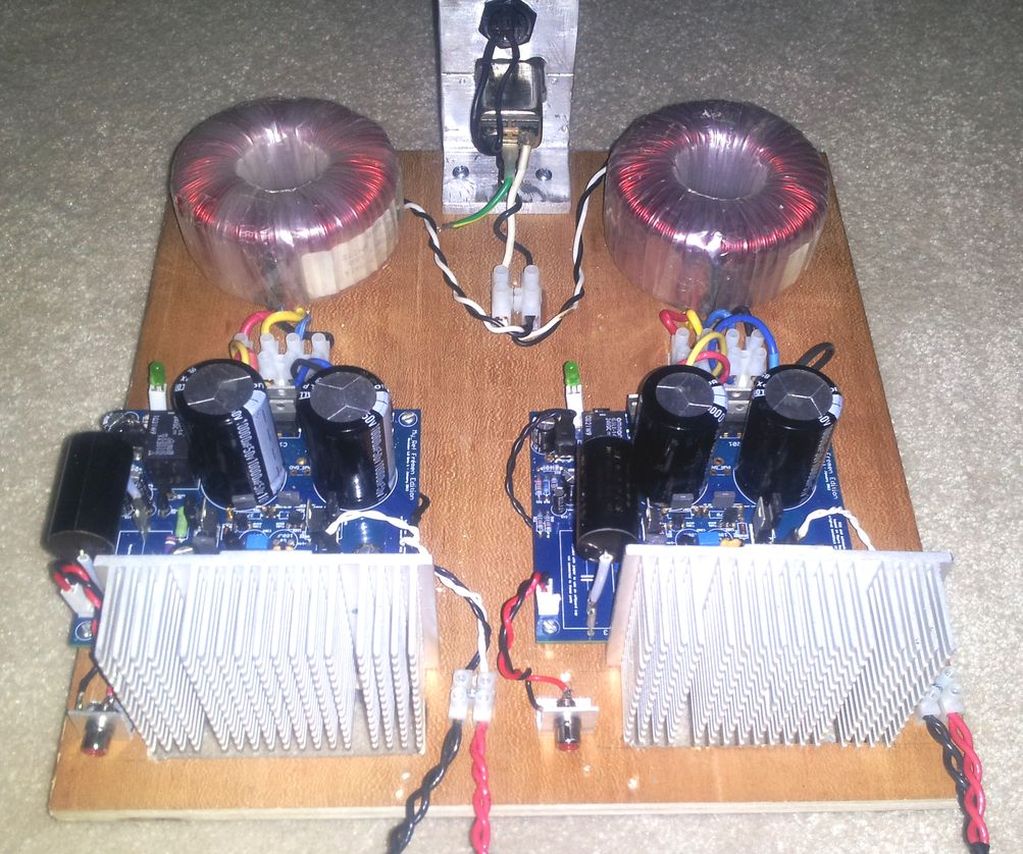

Beta build is operational again.
Component mix: ApexJr 120 VA toroids, M-Cap Zn, Black Gate STD, C101/201 Generics, Amtrans, Caddocks and Renkins. Still sounds great and very close to the premium RC build. I'll do a little more swapping and twirling and then remove all sockets for a final solid build.
