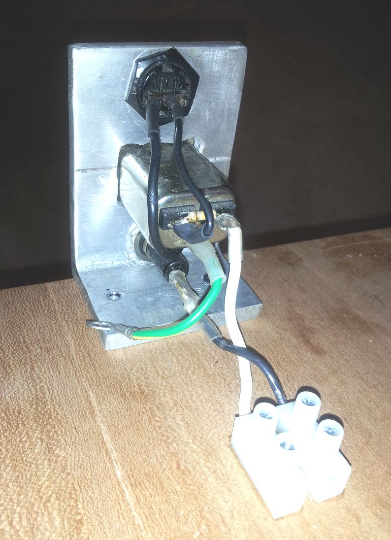

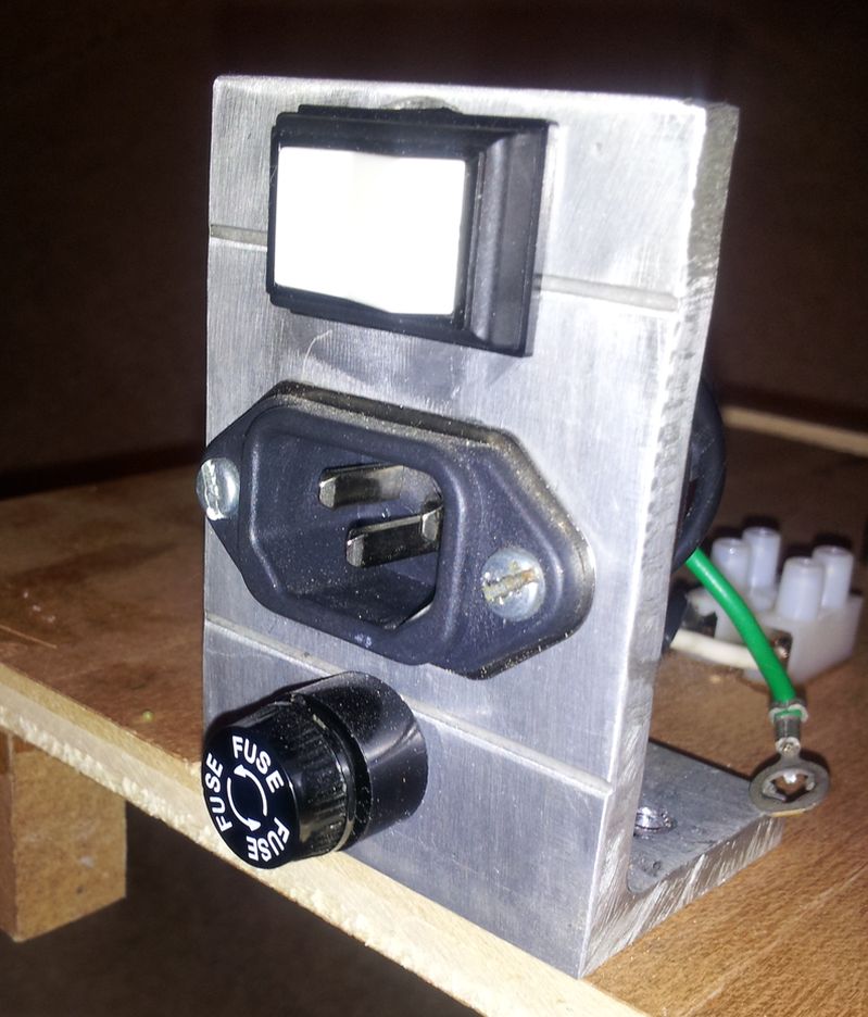

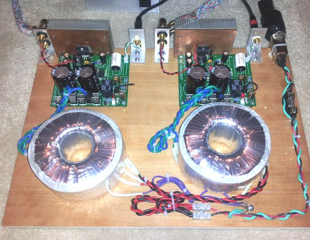

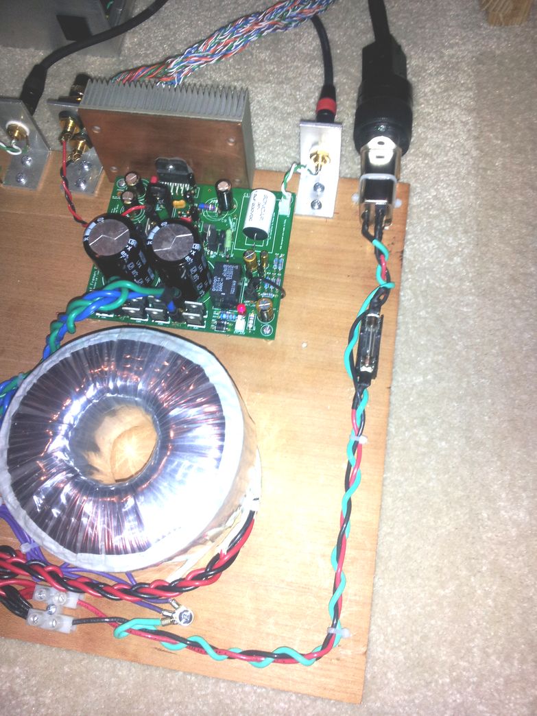

What's your mind about the connections between mains plug, fuse, power switch and transformer?
Do you connect this stuff in a different order?

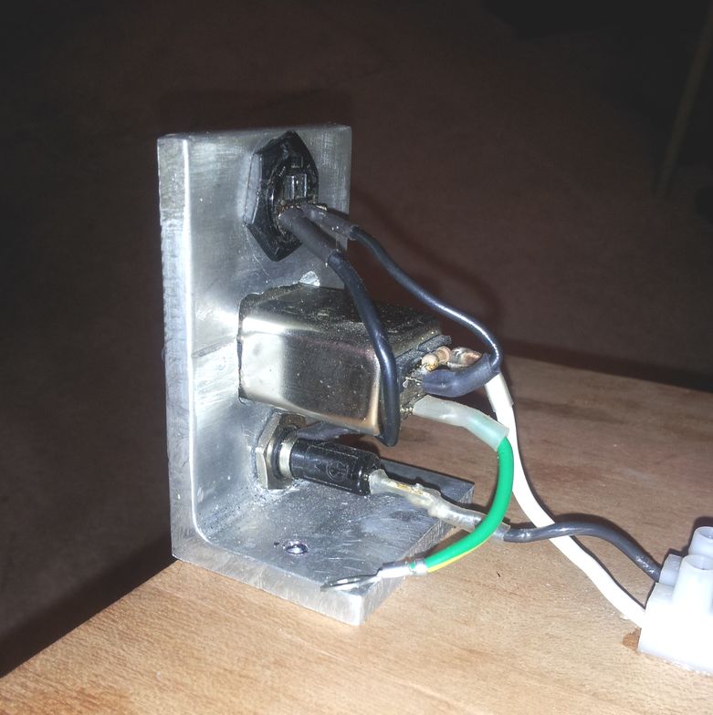

Funny that you should ask as this morning I am ordering this inlet (see data sheet) that combines the socket and the fuse in one unit. I am moving to a non- filtered socket as that feature is reported good for receivers and multi-component audio systems, but of little or no benefit (possibly detrimental) for a straight forward design like the FE power amp.
Some pics of what I have been using. As Andrew said, most of what I do is still on wood. The safety/earth ground (green) must be connected properly in all cases with a metal chassis. The fourth picture is an internal fuse holder design to which a safety cover can be added. The purple wires are the extra "shield" provided with the new Antek toroids. I did a new board this weekend so the AC inlet is now at the back. It is cut to the 17 X 11 inch standard so I can see what space is available for a final chassis.

This is the final accommodation:

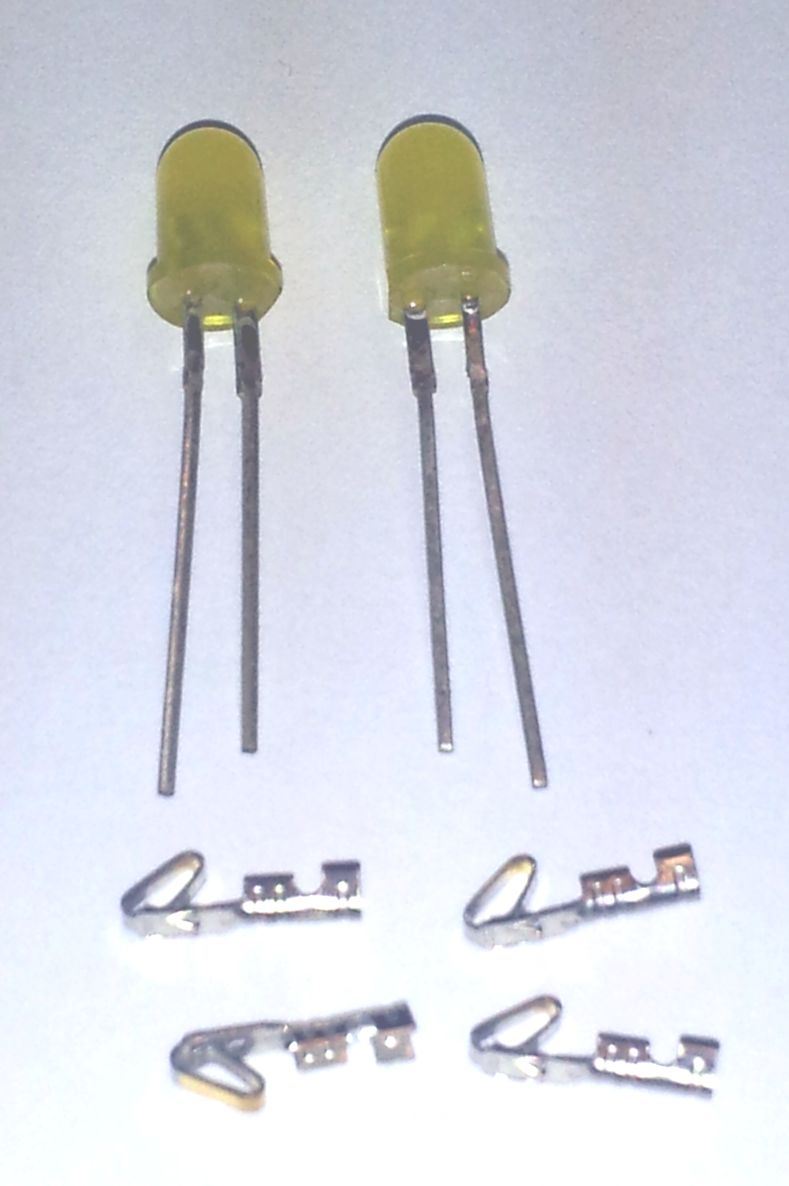

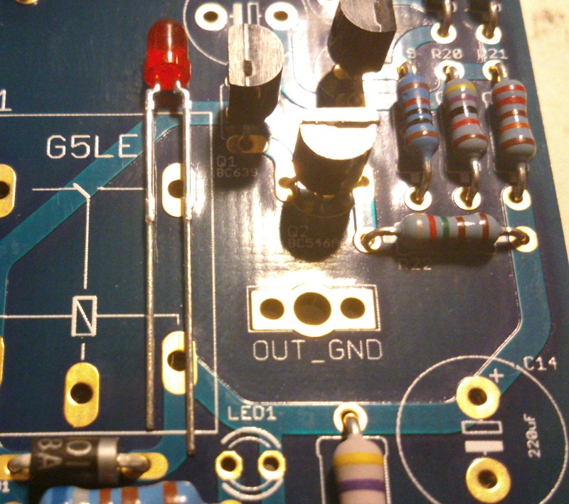

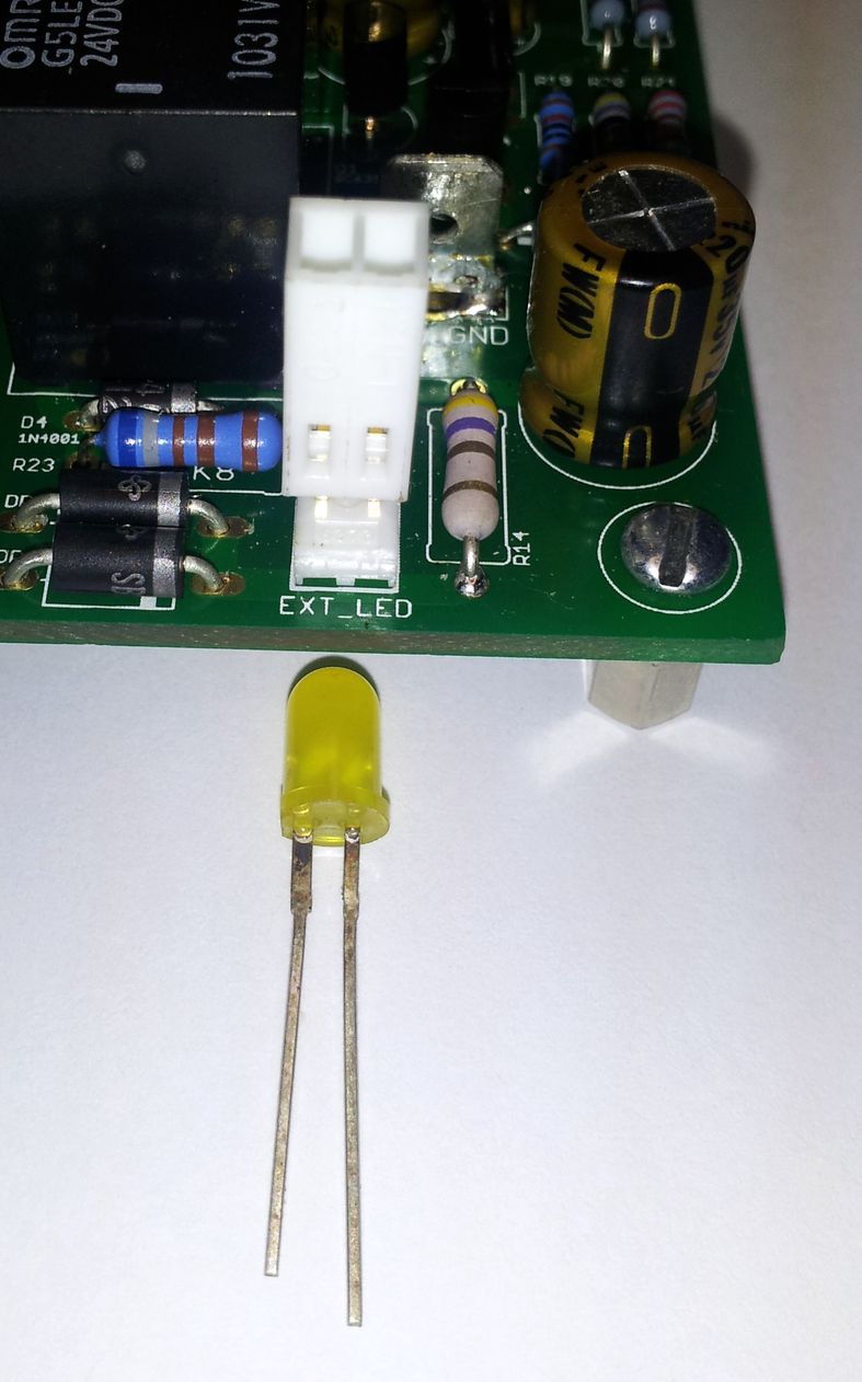

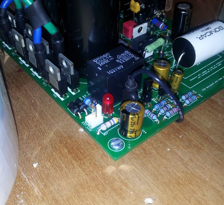

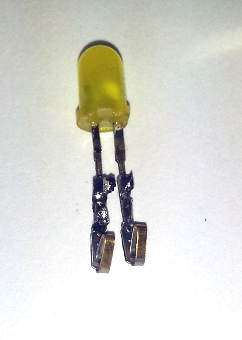

I've got a pair of leds for the front panel, but I've a little problem... they don't light up 🙁
I've tried to invert polarity and check functionality with a tester. On the socket I've 1.6V.
Now I've a doubt, do I need to remove the other one on pcb??

I just tried a second LED and it did not work. One polarity dims the one on the PCB and the reverse does nothing. It appears only one can be used.

Each LED drops Vf.
If you have an emf, of say 10V, available and use one LED @ Vf=1.8V and a 2k2 resistor then Iled = [10-1.8]/2.2 = 3.7mA
Insert a second LED with Vf=1.85V, then Iled1 & Iled2 = [10-1.8-1.85]/2.2= 2.9mA.
This will result in a very noticeable reduction in brightness.
It's simple logic & arithmetic.

Andrew, I had a second question - is there anything inherent in the design of a LED that functions differently than an incandescent bulb? Do the normal rules of parallel and series circuits apply?
I cannot equate them to incandescent bulbs, but yes, they do behave as far as ohms' law and the others expect.
Do remember to allow for the forward voltage drop Vf. That is equivalent to an emf and in the normal "lit" condition it appears as a back emf (reverse voltage or minus voltage) with respect to the driving emf.

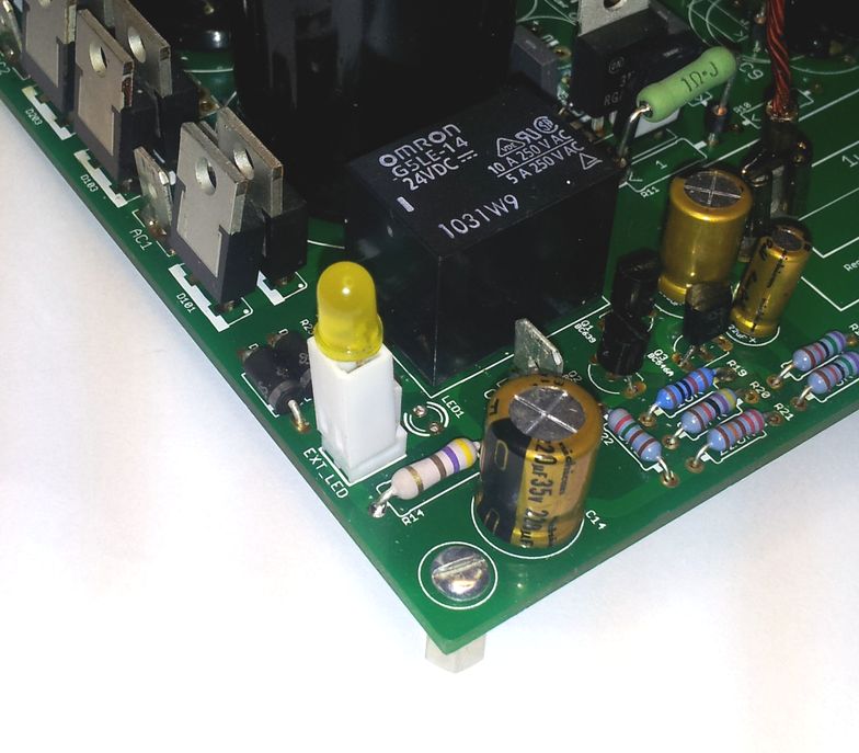

I actually had a problem with one of my LEDs being brighter than the other - different values, not a voltage problem. I tested two yellow pieces to insure they match, then went about the changeover process. These have the flat so orientation was easy. Non the less, I matched things up with Dario's photo in the build instructions. Now the on-board or remote options are both available.

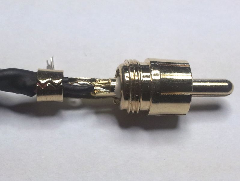

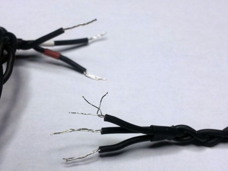

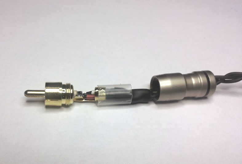

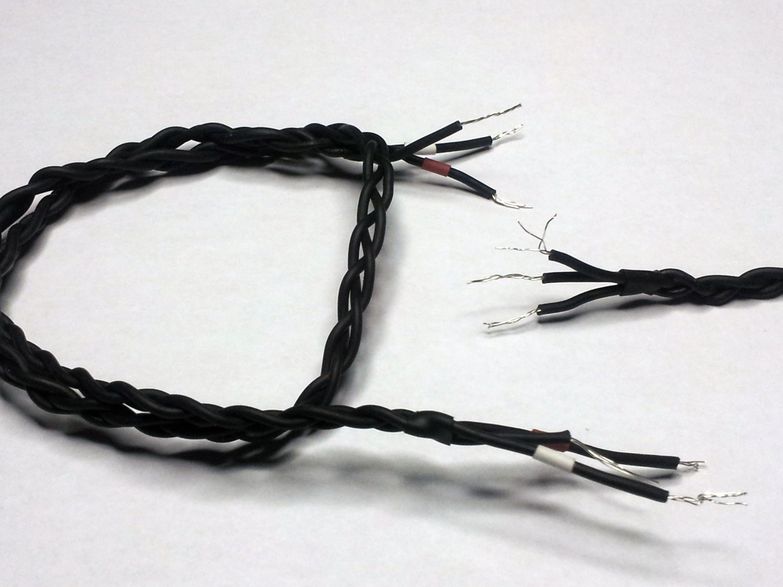

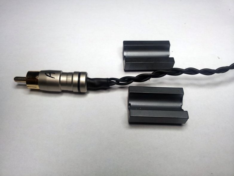

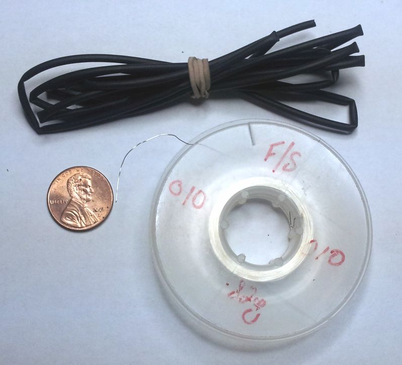

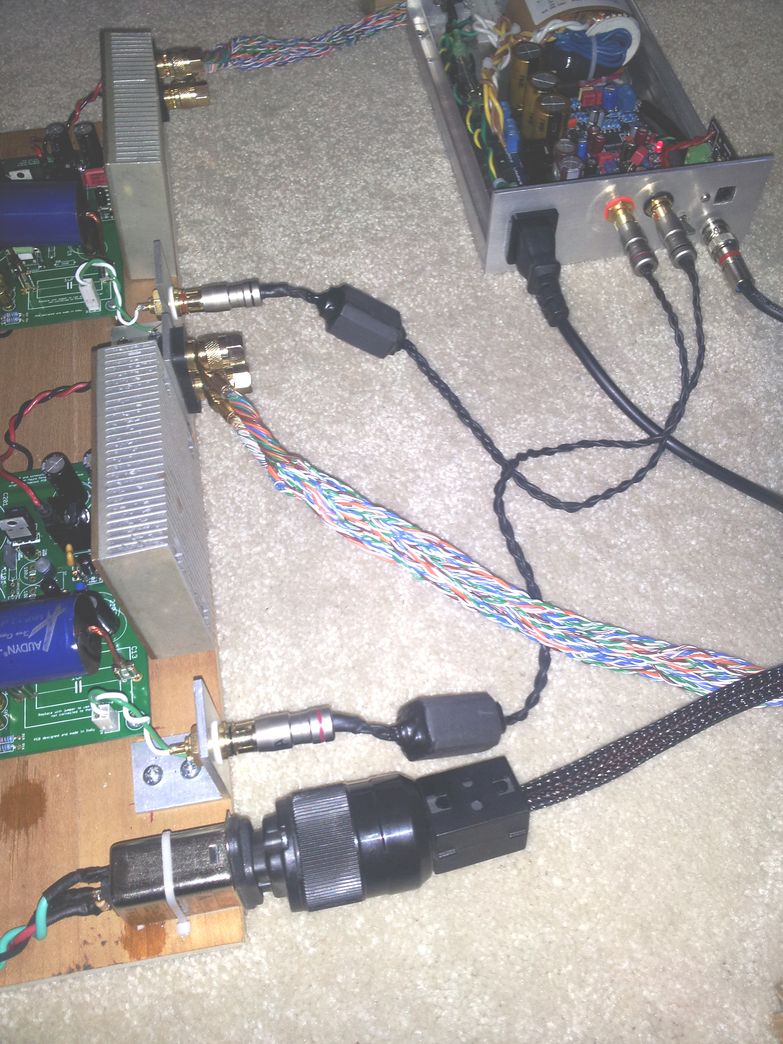

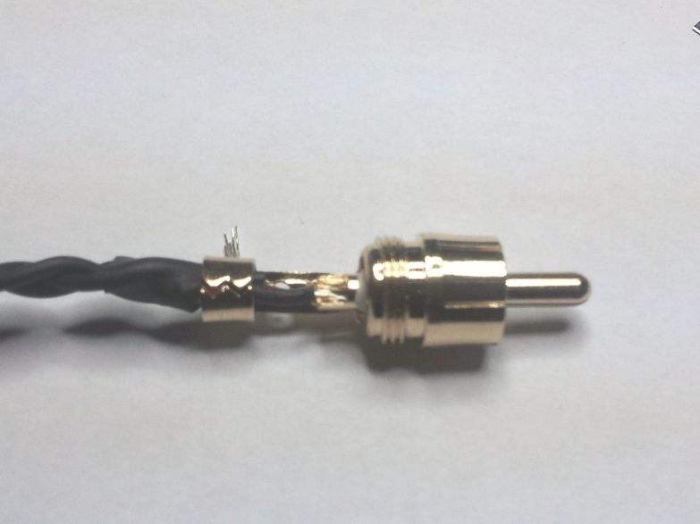

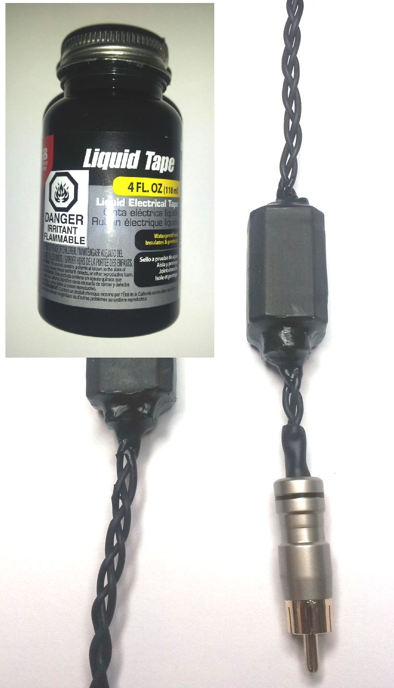

As madisonears says, I'm stuck on wires. Months ago I ordered some fine silver to try an interconnect recipe that used clear package tape as a dielectric. They were ok but nothing special. These are much better. I won't hijack and just point here for more info on design and construction. I just twisted three strands this time instead of braiding.

Hey Guys, I got a few inquiries about the interconnects and think there is enough interest to peruse the topic. In order to keep this thread centered on the RC builds, let me suggest we move the conversation over to the JA-FE Integration thread.
Feel free to post what you consider significant in terms of both interconnects and speaker cabling - Hopefully without getting into useless circular "Wire Wars".
What we want to center on is what works best with assembled FE amps from hands-on experience - and not deep metallurgical theory 😀
