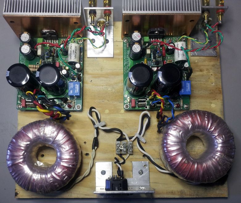

Initially I did want to have a connection from the amp boards to safety ground and even ordered custom made double insulated transformer for this. THis would exclude ground loop issue entirely. Unfortunately the buzz issue is there and I do not know how to get read of it without PGND connection to chassis. I'll twist the transformer leads tighter, but I am not sure it will help. I'll report back if I manage to solve the buzz issue. In principle this forum provide enough info for possible cause/solution, so I'll just use brute force approach and try it all. It may not be the smartest way of solving issues but its a hobby🙂 I'll report back if I find a solution.

OlegSH, there is an alternative that you probably would like to avoid, but it is actually what I do first with every amp I build. Eliminate the chassis - attach all the components on a piece of plywood. You would need a couple pieces of metal if you don't have some heatsinks like those in the photo for the LM3886 chips. I make little brackets for the RCAs and posts, but they can hang free. As Andrew says, get one side working and free of hum - then the other. It's a lot of messing around, but it does work and will let you see if something with the chassis is causing the hum. (V1.3 pictured)

instead remove all cable connections to the second amplifier.
That is input cables, output cables, power cables and grounding cables.
Leave the PE connected to Chassis.
Remove all amp cables to the Chassis.
This last leaves the isolated secondaries separate from Chassis with lot's of metal work around parts.
Be careful !!!!!!
Now you can debug ONE channel. Take measurements, see what the scope has to tell you.
Expect 1mVac to 10mVac if you have a hum loop.
Expect <0.1mVac if you have eliminated the hum loop.
Test with a 1k substituted for the input short to get a feel for how much noise is included in the hum measurement.
Then swap to a 100k for lots more noise.
the shorted input gives just the intrinsic noise of the amplifier. 0.1mVac is very low nV/rtHz
the 1k0 is equivalent to 4nV/rtHz.
You can use that to guess at what the amplifier is adding to the resistor noise.
100k is 40nV/rtHz, just in case the amp noise is obscured with the 1k0 measurement.
On the scope the peak to peak voltages look much bigger than the Vac reading that you get from your DMM. Firstly because of the noise added by the scope and secondly because Vpp is roughly 6times Vac.
A 100k hum + noise reading of 4mVac on your DMM will be very approximately 24mVpp on the scope, a 5mV/div setting will show 24mV = 48mm, up and down the scope screen, or 24mm above the line and 24mm below the line.
