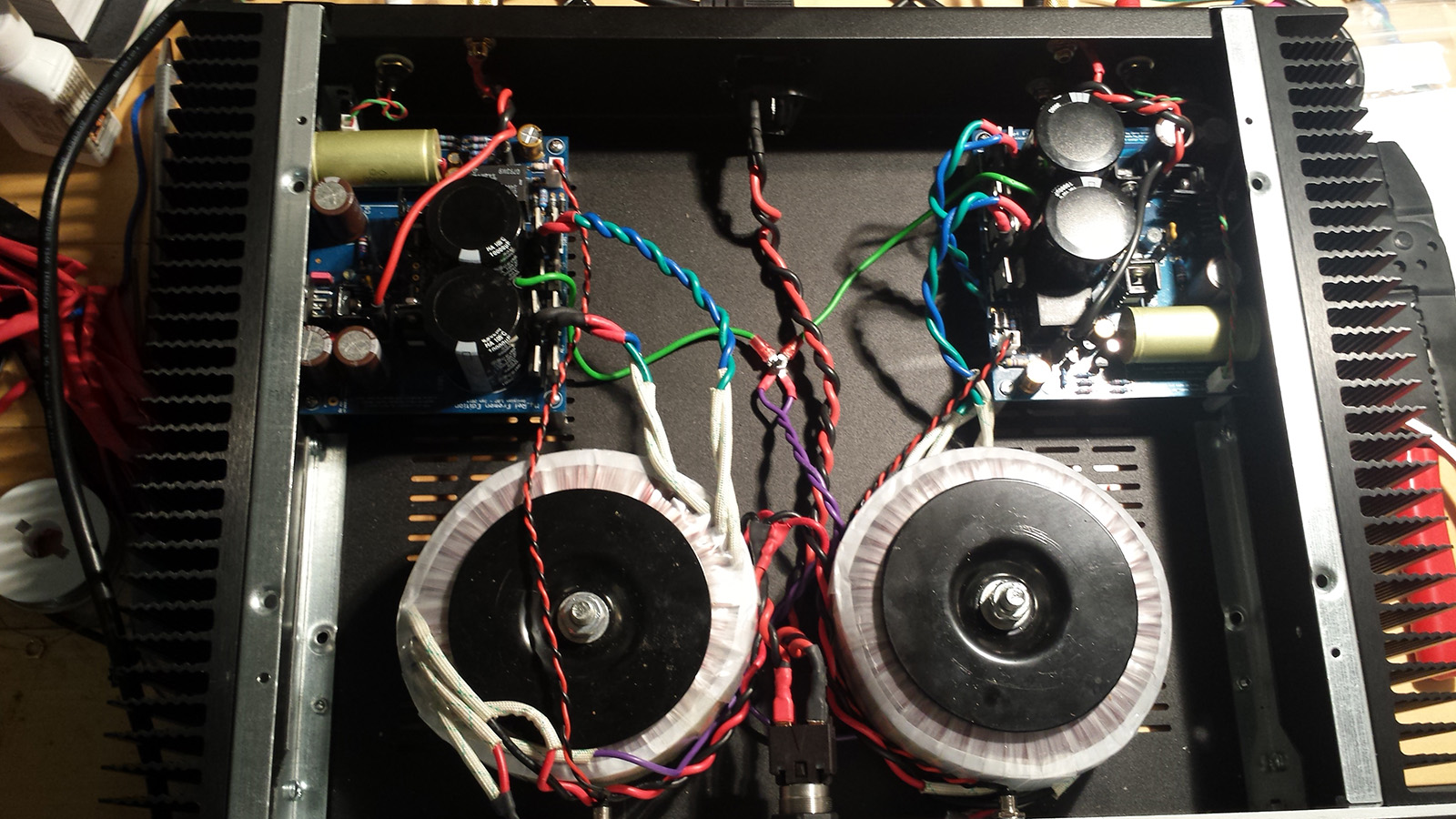

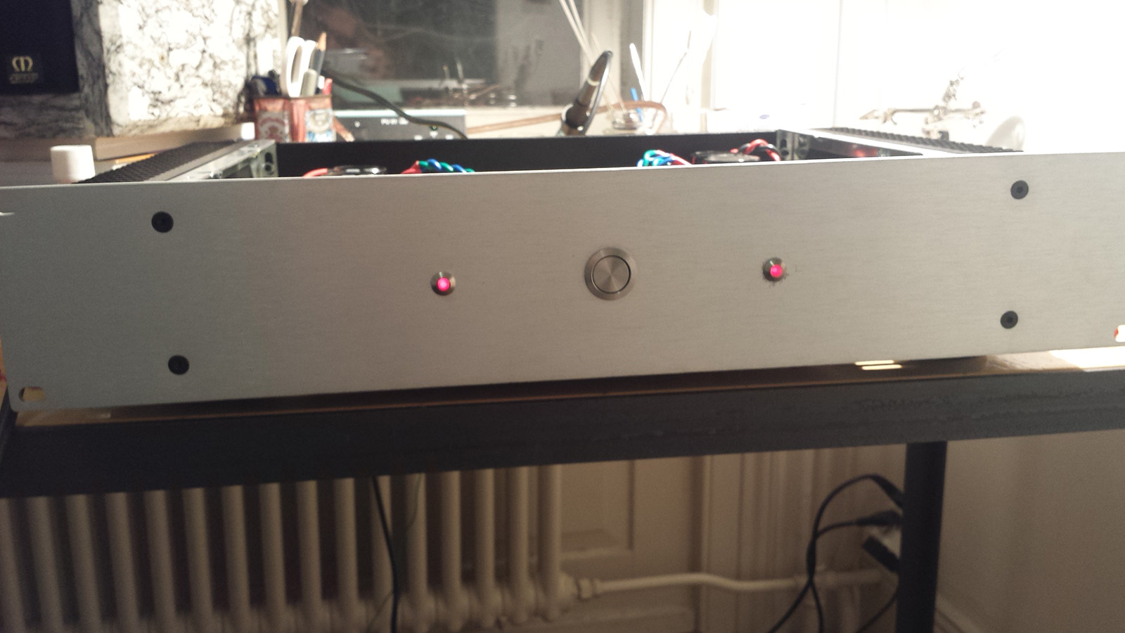

I've finally finished (well, almost..) enclosing my FE! I used a 2U Dissipante case from Hifi2k, was a bit of a pain to mark the holes in the heatsinks but it looks pretty good now. I messed up on the hole for the right LED, you can see some scratches around the bezel. I'm gonna get a washer to cover it up.
For the input caps, I'm using the Russian K71-4 - I'm still waiting on some conductive copper tape so I can ground their metal cases, they cause an ugly buzzing with disconnected inputs.
The case is also not grounded yet, I forgot to order resistors and capacitors to make ground loop breakers, I'll pick those up locally soon.
And most importantly of all, it sounds great! I'll have to compare it to my P101 when I'm done rebuilding that.
