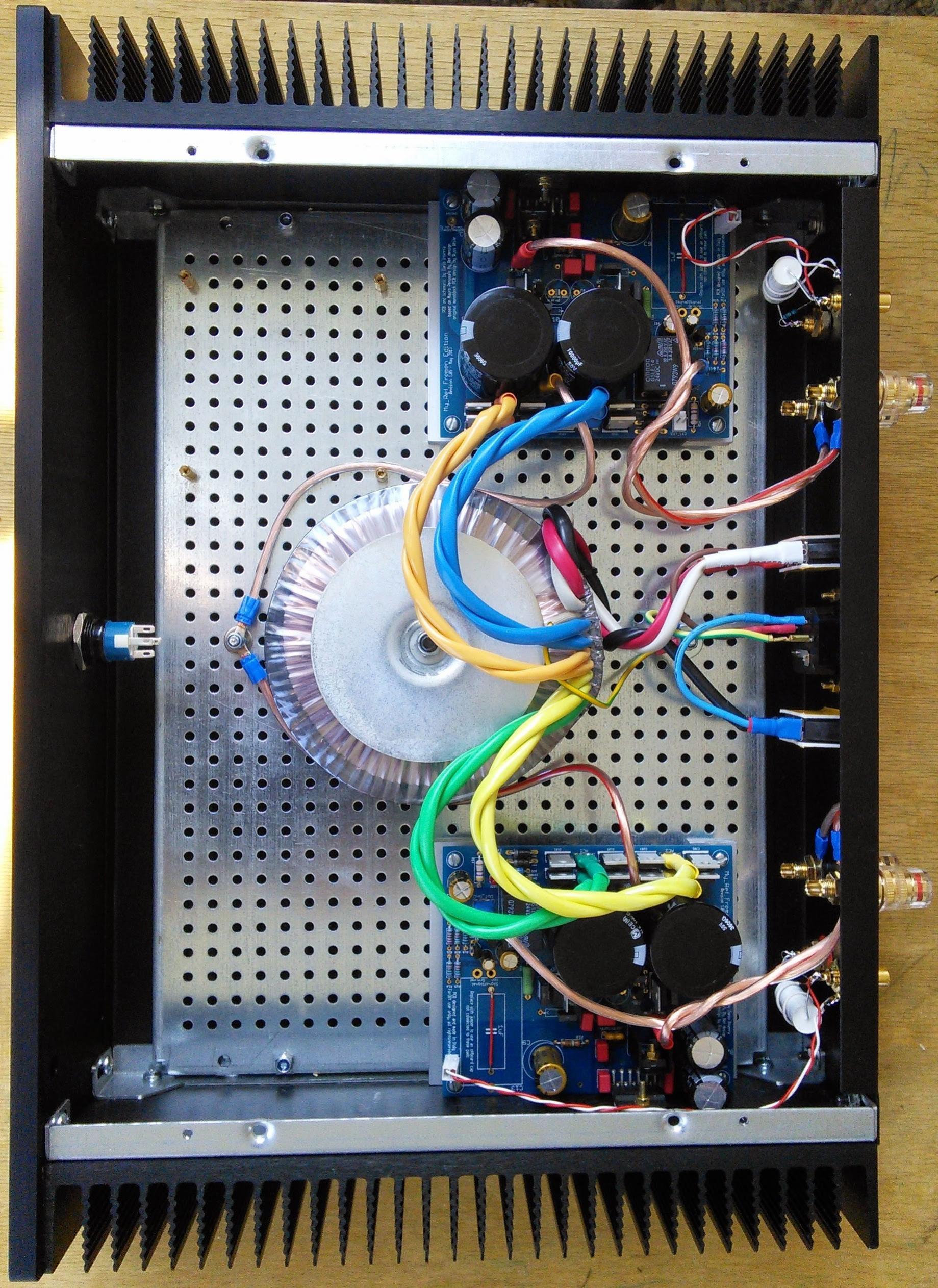

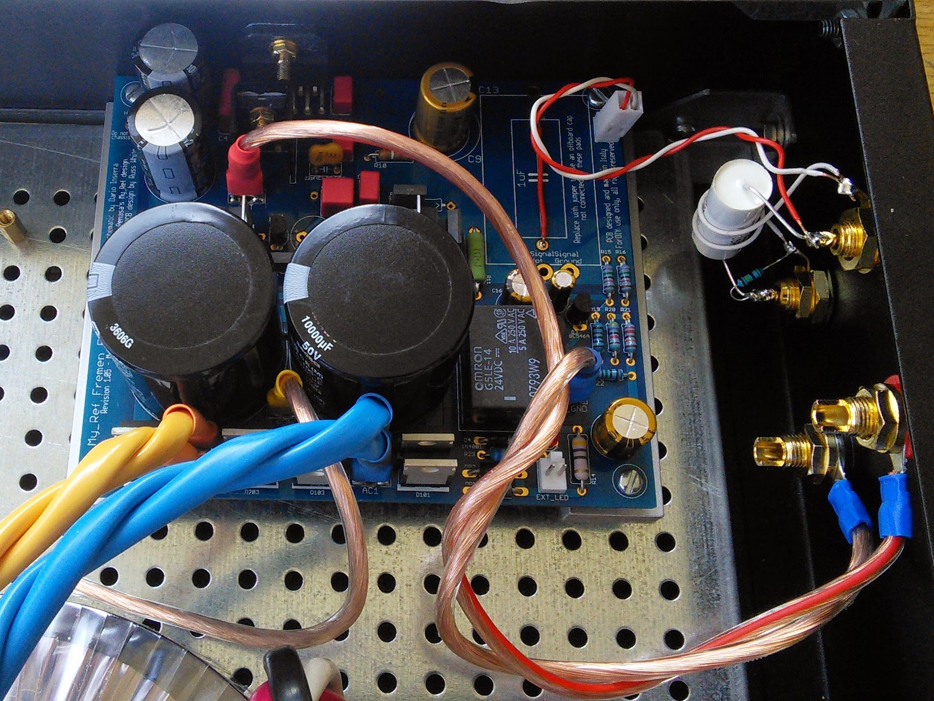

Thanks a lot for quick reply. It does sound strange to me as well. To make things more clear I attached the pictures of an assembled amp.
Please let me know if you see something obvious (or not so obvious).
I am currently out of ideas.
Oleg

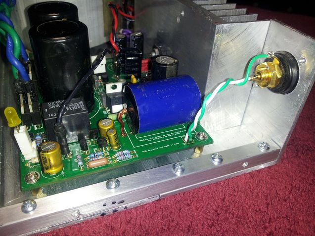

I am sure that Dario is the expert and will see something else, but here are the things that I notice different from my build.
1. You have PGND connected to the chassis. Try removing it from the faston on the board and see if the noise improves.
2. It is hard to see in the picture. Are the RCA inputs isolated from the chassis? If the negative side of the signal is connected to the chassis, then it would be possible to have a ground loop through PGND, the chassis, the RCA negative, and the amp.
3. What is going on at the input? It looks like you have a signal RCA connected in the normal way, connected through a capacitor to another RCA, a resistor between the 2nd RCA signal and negative, and a "coil" between the negative of the two RCAs. In addition, you have a jumper C13 on the board. In my amp, I have C13 at the board connections and the signal directly from an isolated RCA. Can you explain the extra parts at input?
Jac

3. The input of the amp has two RCAs per channel: before and after the input cap (C13), which is soldered between the RCAs center connectors (AC and DC coupled inputs, respectively), hence the jumper on the board. The "coil" is probably the signal reference wire wrapped around the input cap. May be not the best way of doing it "coaxial" with the signal path through the cap. The 1.5 MOhm resistor across the bottom RCA is there to make an RF filter together with the input cap if the upper DC coupled RCA input is used (suggested by AndrewT). I hope I did it right.

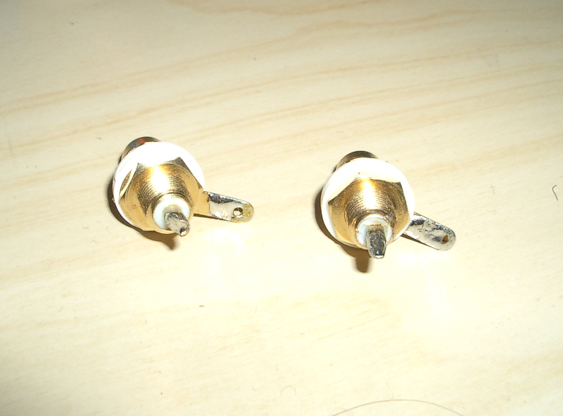

The kind of RCAs you used seems similar to the ones I've used in my Gainclone.
I've somewhat overheated them soldering and while they looked perfect I've had a hum that has been fixed only with a new pair of RCAs.

3. The input of the amp has two RCAs per channel: before and after the input cap (C13), which is soldered between the RCAs center connectors (AC and DC coupled inputs, respectively), hence the jumper on the board. The "coil" is probably the signal reference wire wrapped around the input cap. May be not the best way of doing it "coaxial" with the signal path through the cap. The 1.5 MOhm resistor across the bottom RCA is there to make an RF filter together with the input cap if the upper DC coupled RCA input is used (suggested by AndrewT). I hope I did it right.................
Isolated RCAs OK.
The 1M5 is not RF attenuation. It is to source capacitor leakage to Signal Ground.
If you want additional RF attenuation at the RCAs, then add a 22pF to 47pF across the Hot to Return of the RCAs.
You should also have RF attenuation on the amp PCB.
Dual inputs, one for DC and one for AC gives operational flexibility. Use whichever DC blocking cap is better.
I like the attempts to reduce LOOP AREA.
But you have left Big Loops at the RCAs.
The solder tags are many mm away from Hot. This creates excessive Loop Area.

The Blue-Ray player can't be noisy... with my defective RCAs I was able to hear through the amp switching the light on/off and when the refrigerator's compressor kicked it.
Replaced the RCAs, problem fixed.
Don't you have a pair of cheap but new RCAs to try?
I just don't understand what can be damaged inside of the RCA socket!? I have two RCA inputs per channel, all 4 sockets have same symptoms. I still have a set of new RCAs but they are the same brand as the ones I used for the amp. I can give them a try but I still doubt it will solve my problem. May be I can try another brand assuming that all my RCAs are defective.
But anyways, why it works with iPod? The signal cable is the same in all cases, so bad contact in the RCA socket is hard to believe.

I tried to remove the input connector from the amp board and with the PGND disconnected from the chassis (basically the amp is totally insulated then) I have mains frequency buzz. If PGND is connected to the chassis the amp behaves "normally" until I attach a source to it.
Having a toroidal transformer makes me wonder where the buzz problem can come from. I have also connected the inter winding screen of the transformer to the chassis at the safety ground bolt right next to the transformer. May be I should consider screening the mains inlet with all the excessive cabling/switching that I have in order to eliminate the buzz!?
Also twisting of cables is a bit difficult due to larger than necessary insulation tubing on the transformer leads. May be I should strip it out and twist tightly the leads first!?
The buzz, when no Chassis, indicates a wiring error.
I'm not sure it will work for you, but several builders have found that grounding the transformer screen added hum. The MyRef design is a little unusual in it's grounding scheme. The configuration that has been quiet for me is;
- transformer ungrounded
- PGND not connected
- Single RCA isolated from the chassis ( this means that ground is only through the signal minus to the signal source )
- C13 as a capacitor in the signal stream for DC blocking
When a GND is connected to the house ground by another path than signal minus, it forms a ground loop through R11 which can cause noise. This is not a mistake, but a feature of this kind of amplifier where the speaker's impedance is part of the feedback. It does mean that it is sensitive to how it is grounded regarding noise.
