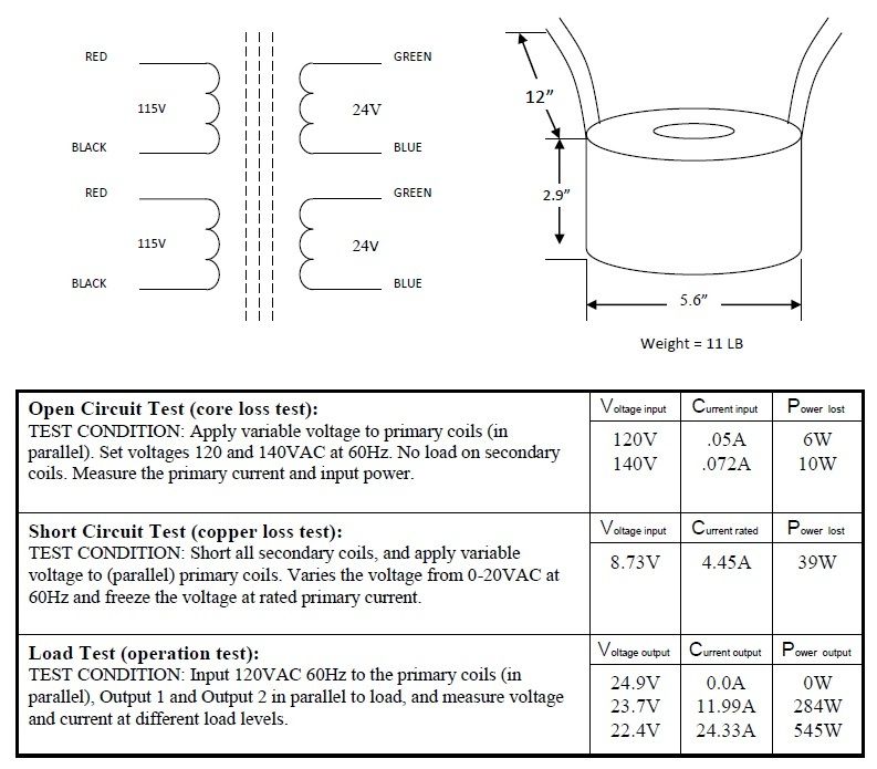

Just tried to disconnect the transformer screen from the chassis. No effect. The buzz is there if PGND is disconnected from the chassis. Each amp channel has only 6 wires connected to it if PGND is disconnected: 4 wires from the transformer and 2 goes to the speaker. What can be wrong 😕

The buzz, when no Chassis, indicates a wiring error.
the speaker Return should NOT go back to the PSU.Just tried to disconnect the transformer screen from the chassis. No effect. The buzz is there if PGND is disconnected from the chassis. Each amp channel has only 6 wires connected to it if PGND is disconnected: 4 wires from the transformer and 2 goes to the speaker. What can be wrong 😕..................
That is a wiring error.
ONE wire connects the PSU Zero Volts to the Main Audio Ground.
All the other amplifier voltage references connect to the Main Audio Ground.
They DO NOT go back to the PSU.

this rings alarm bells.4 wires from the transformer and 2 goes to the speaker
What is going back to the transformer?
OlegSH, is there a diagram attached to your transformer (like Antek has)? Four wires is correct, but problems will occur if they are not paired correctly. The power entry FE and standard MyRefs are not exactly the same.
EDIT: OOPs, we posted at the same time. Would still like to see the diagram if you have one.
The transformer has the diagram. All pairs of same color are secondaries. They should be identical according to specifications. See pictures in post #1825 which show the wiring of my amp.
That's exactly what I saw that made me curious. Same color pairs is simply something not often seen - at least by me. Just wanted to confirm that arrangement. Thanks
