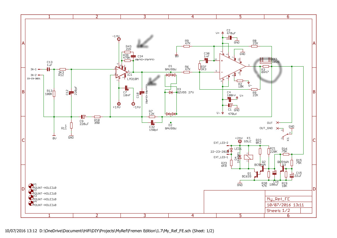

So, first of all one should have the 'Rev-A' compensation scheme applied, in place.
http://www.diyaudio.com/forums/chip...on-build-thread-tutorial-265.html#post4793708
These consist of:
Change R3 from .47ohm to .33ohm (uhm, the most 'painful, costly change..)
Remove C10 (33pF)
Remove R39 (470K)
See attach..
Then, for the eventual opamp change the only step left is to remove - disconnect the compensation scheme for the opamp.
This means to remove C34 (27pF) and /or R43, (22kohm)
I usually leave in place C34 (expensive, better not touch) and remove, or just turn 90degree R43, in it's place
With this move one conserved all the bits necessary to an eventual re-install later. Obviously conserve the LM318, too.

In case of the ADA4627 / OPA627 / or eventually the OPA1641 this is all.
In case of problems of spurious oscillations (we can discuss the effects) one should install an extra 3.3pF directly across the pins 2 and 6 of the opamp.
Do not install by default, was never needed, except for one occasion, this is why I mention.
The original compensation capacitor, C32(150pF) can be left in place. (whew, all our precious styroflex parts..)
We are done.
Except for usual oversights.. Dario?
Ok: should add: after replacing the new opamp, please visually inspect, re-inspect and again, control that all leads are soldered firmly, and conduction is established.
In case of missing this, costly consequences are lurking in the back..
Always turn on first without anything connected, and wait for the usual, sweet click of the protection relays. All!!
Ciao, George

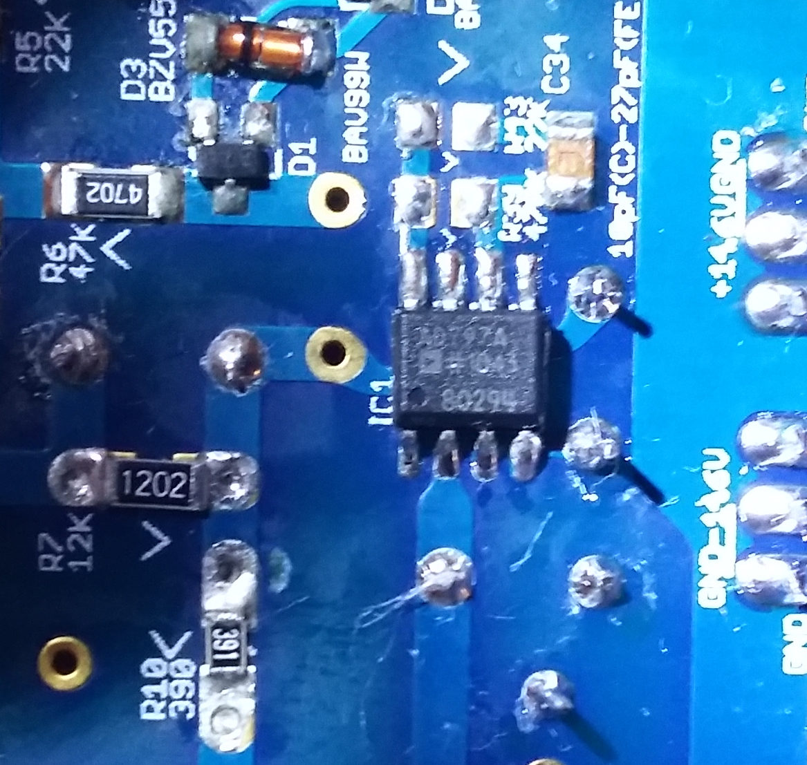

We have a new partecipant here.. Had been always very curious.
Only tests have been done for now, and the pic had been made before vital compensations applied.
(side note: This guy requires, though, that servo - feedback cap should get back in place..)

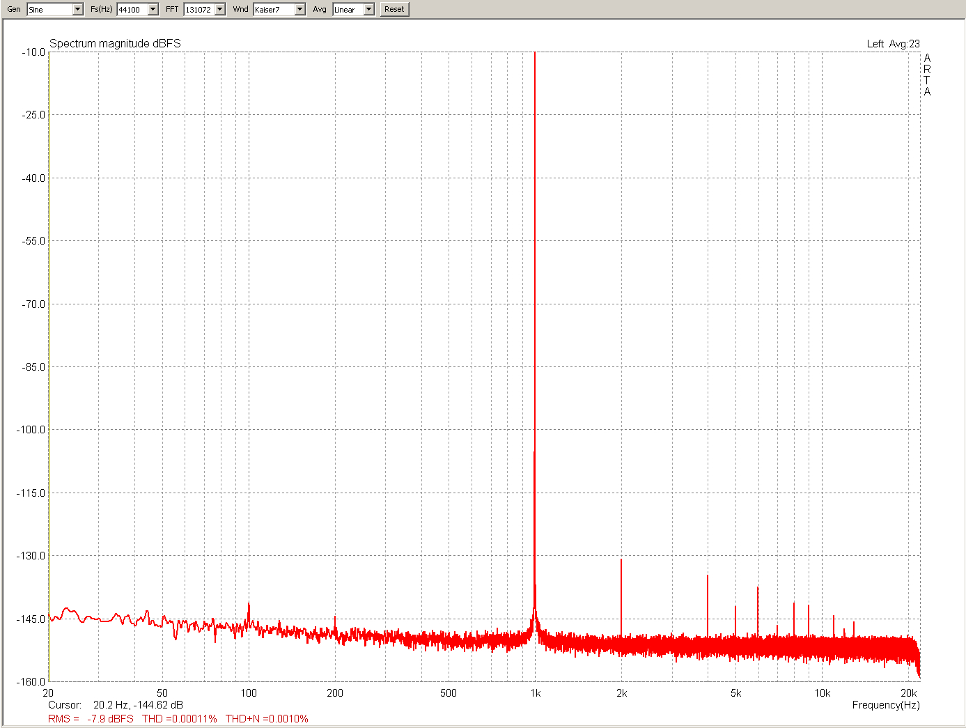

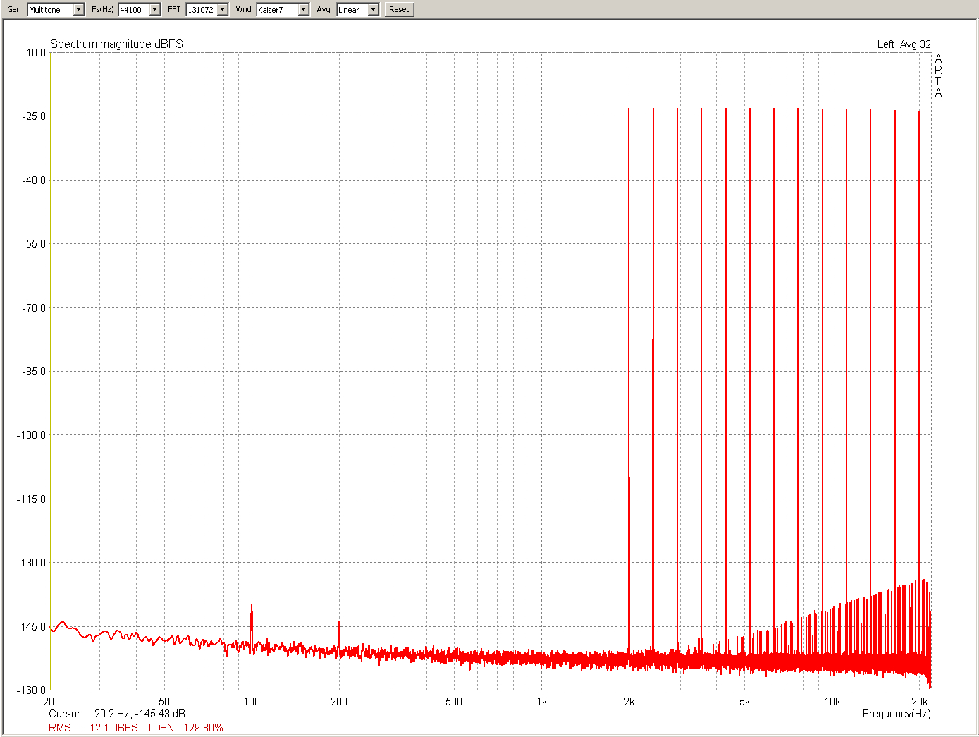

I would like to clarify, again, my intention with these measurements.
The principal intention is purely technical, and first of all: stability.
I always start with simulations, explore methods of the possible compensations, do a loop gain and transient analysis. I wish to do loop gain analysis some time in practice, too. Until then, the first prectical test is the transient analysis with the scope, hunting down the faintest still visible oscillations, if present.
Then I learned slowly that also spectral analysis can be a great help: a circuit even if partially unstable, with slightest hints for oscillation -- never will be able to produce such a low distortion spectra that we are getting used to see. It's the intermodulation, mixing down, plus shifting biases, and thermal effects which at the end result in a brutally deformed distortion spectra even with low levels of spurious oscillations.
Then, these measurements, with an objective possibility to make direct comparisons between different partecipants, show the slight/ not so slight !Technical! differences between configurations.
But the final word is always the listening: no way it is intended from my part to substitute that.
So, with all this put forward, here are the diagrams with the AD797.
First, the usual 1kHz test tone. Then the multitone test, which at one shot returns a lot of interesting aspects. All this in the test modul with external lab power supply.
