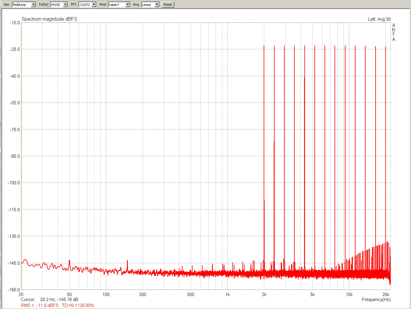

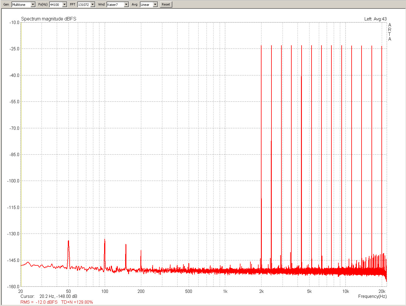

Guys,
It's quite a time that I had started to play with different opamp substitutions in our FE and Myref Evolution amps. It's like one year already on..
I had started principally with fet input opamp families, becasue as stated had found a nice going easy match with the myref topology. When I left off I've been just about to test some bjt input opamps.
That time I have finished testing the LME49990. I can confirm that it was Not a nice, easy going match in the Myref topology.. Had to sweat quite a lot.
When I finished fighting with compensation, I was rewarded with results like this: first to left is with original LM318, right is with LME49990
The sound of a wire
As it could be expected, the distortion reached impressive low levels (in the high frequency range) with the new opamp.
But but. I was so dis-impressed by the amount of fight needed to achieve this, that I did not even proceed to complete two boards and give it a listen..
