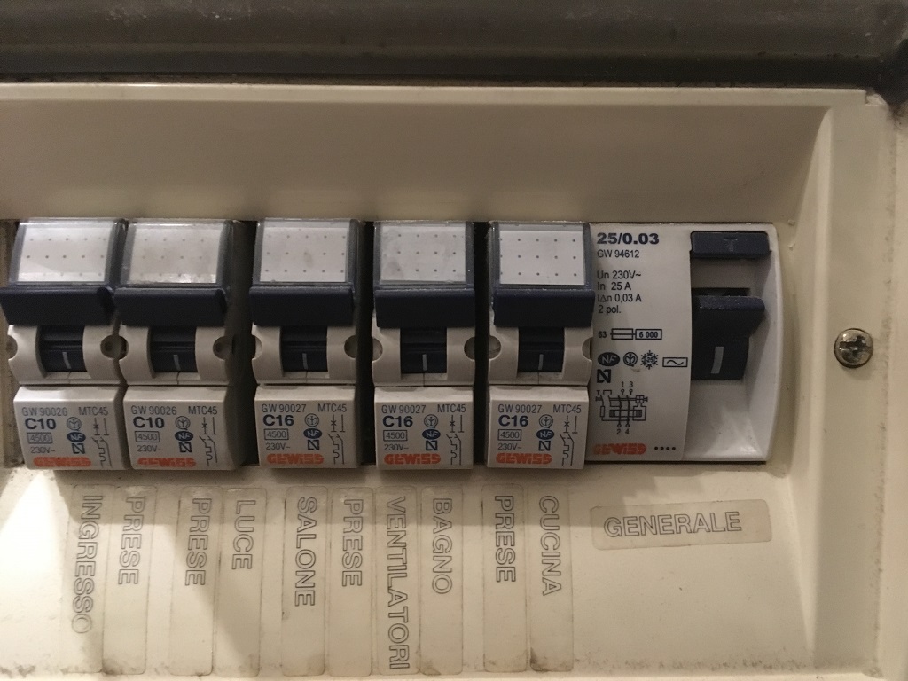

But IMHO such a failure is unlikely in a properly built device and it's still no different than most DIY projects, isn't it?
Also, here in Europe at least, should be mandatory to have protective devices (life savers in most cases) like these (already posted in this same thread):
AKA residual-current circuit breaker and thermal magnetic circuit breakers.
I think that everyone has to be informed about the dangers. Which conclusions one makes and which compromises one allows based on this knowledge is up to him/her.
