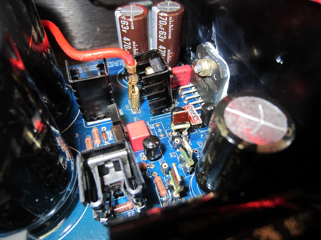

Actually this was quite a tricky build:
- the 1/4" terminals are rather close to the rectifier diodes and require sleeving and careful fitting

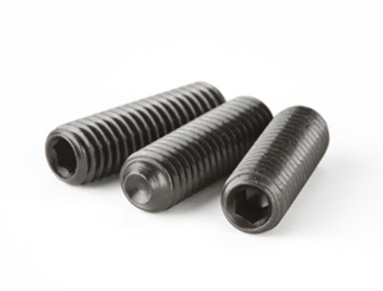

- access to a screw to fasten the 3886 is blocked by other components and it's not possible to use an ally bar to clamp it, for the same reason.

Never had problems with faston tabs... they're a bit tight with 35mm caps, though.
The LM3886 should be fixed by a nut over a M3 grub screw:

As you can see, I can understand very little about the construction of electronics and how the parts work together, but I hope to learn a little when I build these Amps.
I think the noise must come from the signal source, or not?
CD-Preamp and my 2 Abrahamsen amps have no background noise.
I would like to try with an I-pad on battery to see if it gives less noise.
Have tested many versions to ground the stereo without luck.
Has failed to influence the noise in any way.
Maybe I have to buy input isolator (ISO-MAX or ART DTI transformer / isolator)?
Will noise go through these insulators too Or affect the amplifier negatively?
Thanks for reply!
I should have had pictures.Sorry!
I am using a CD player and preamp as signal source. (Abrahansen stereo)
I use XLR cables from CD to preamp and balanced out from preamp.
At the FE-amplifier I connect pins 1 and pin 3 (ground and negative)
I do not know why this goes, but it gives the same good sound as with
RCA directly from the CD player which also has volume control and single ended outputs.
By good sound, I mean when I turn up volume so much that I do not hear the background noise of the stereo system. It is not good sound in delicate soft songs.
I use "best boom parts" in my FE amps.Cap in C13 is in place.(Hot-to Hot on PCB?)
It's when i connect an extra C13 between HOT and return input wires that this noise disappears. I can not use this for anything as it changes the sound negatively.
Like putting a blanket over speaker. What's really going on when I'm testing
with these extra caps (1uF and 4.7 uF) Are they like a filter?
