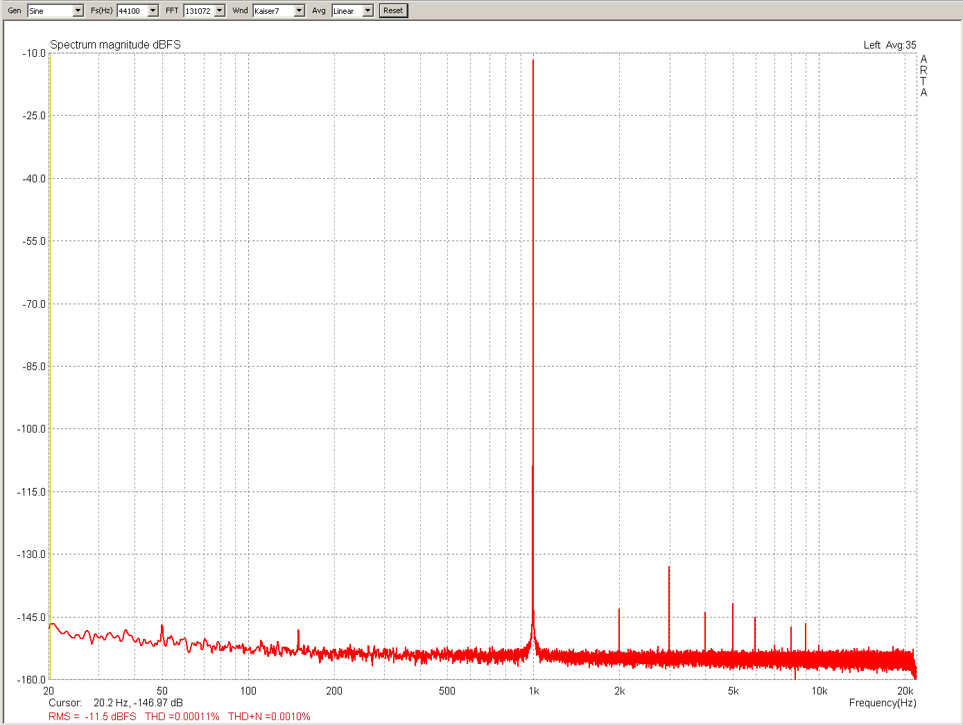

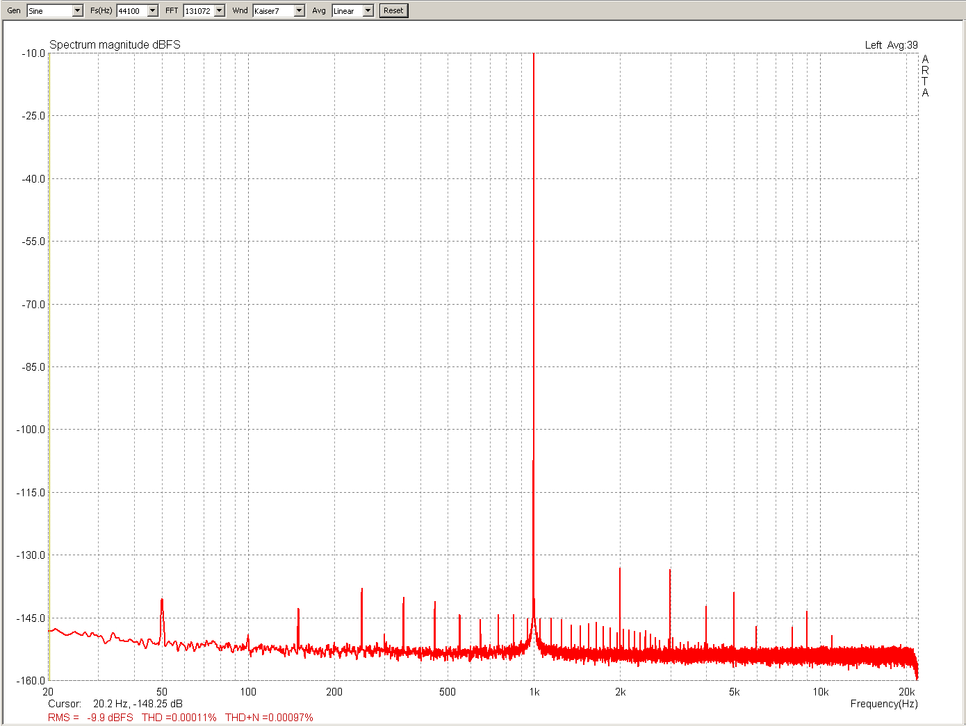

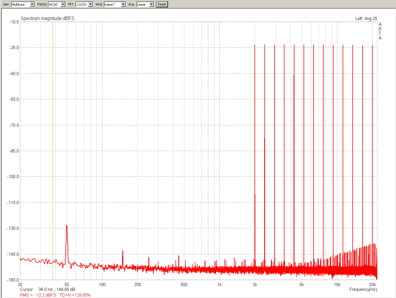

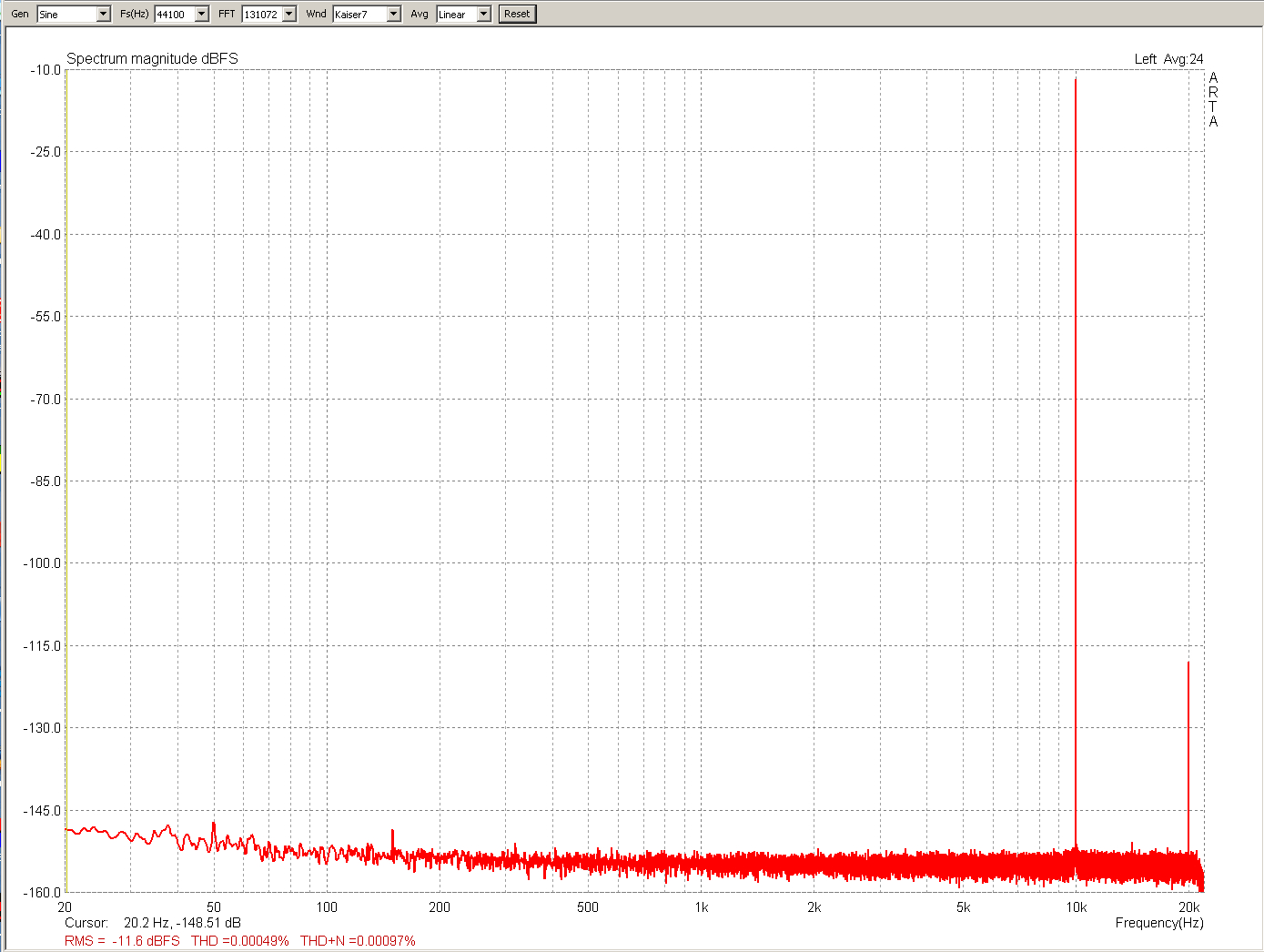

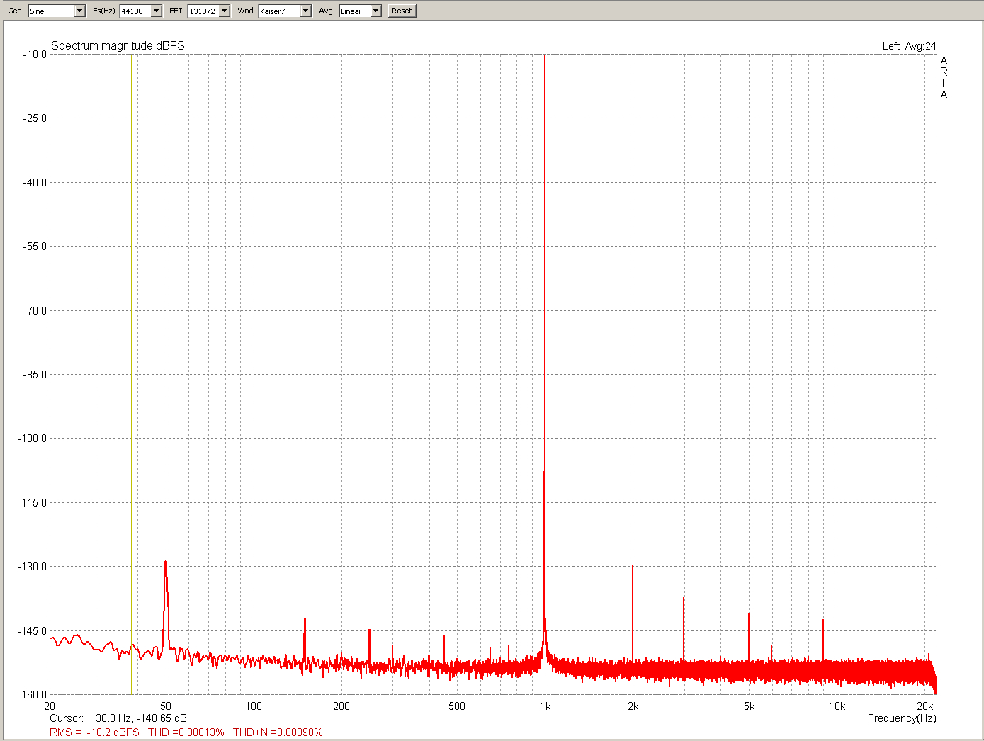

So, with all this put forward, here are the diagrams with the AD797.
Firyst, the usual 1kHz test tone. Then the multitone test, which at one shot returns a lot of interesting aspects. All this in the test modul with external lab power supply.
Am I wrong or AD797 is doing worse than LM318?

One can note a rise in the noise floor, in the low frequency range. Which is an interesting result, given that we are talking about one of the lowest noise high performance opamp.
Yes, but it's a bipolar opamp anyway. Very low en noise parameters with a legendary low 1/f noise corner, but mediocre in, input current noise parameters with much higher noise corner, so it start to rise visibly. Because we are 'abusing' this amp in this application, with very high input impedances presented to it's pins.
The not so exceptional high frequency distortion performance is just slightly surprising, the open loop gain has a very low corner frequency, though I expected a bit better behaviour. It can be me: given the bad 'fame' for happily oscillating, I had a havy hand in the compensations. Shall re-try this part.
All in all this is a good example to show that in comparison the LM318 is showing not a bad performance as well..

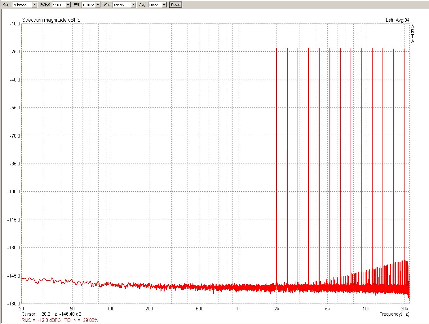

You maybe have hoted that I was talking about the OPA627 --- without facts.. very bad very bad..

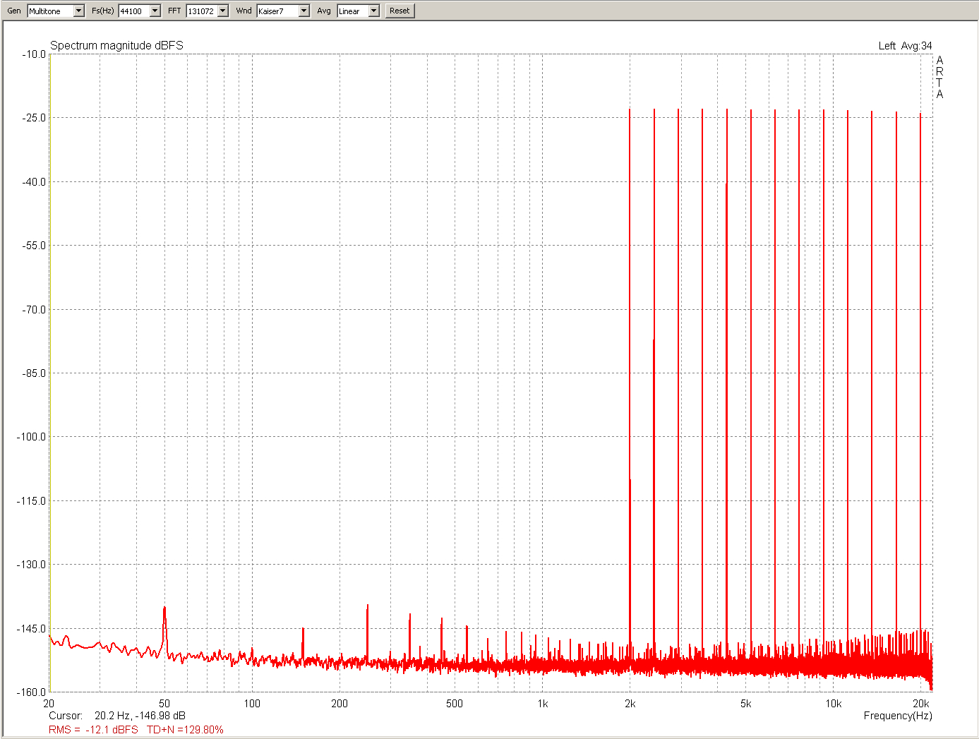

So here they are, the tests on the actual amp which I have been listening to (with C9 shorted )
All I can say is wov.. Would like to repeat, without any kind of extra efforts to stabilize, any sufference.. The only sufference in the system is the close vicinity of a >400W power transformer, which is visible unfortunately.

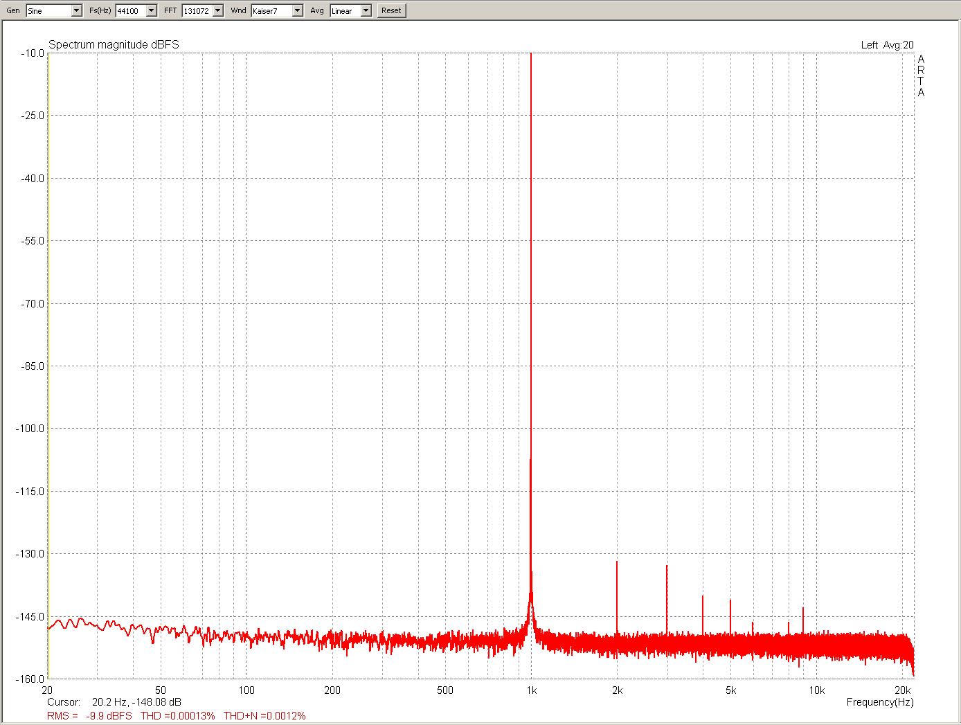

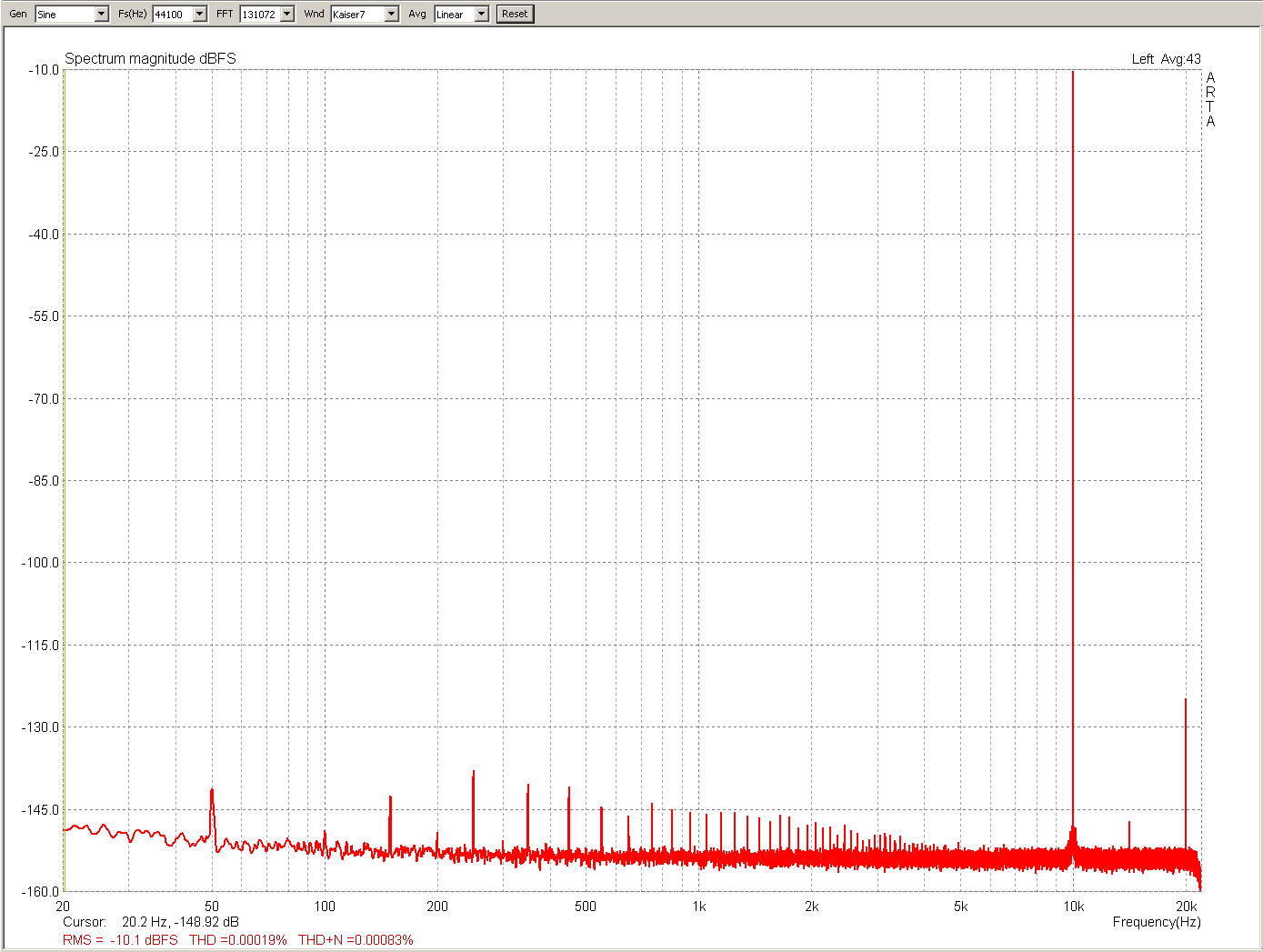

ADA4627
For comparison, here are the equivalent shots for the ADA4627.
FE_ADA4627_-10db_44k_5W_13-14kHz_IMD_kulstap_10mF_28_jul_massa.jpg436.5 KB · Views: 108
FE_ADA4627_-10db_44k_5W_10kHz_kulstap_10mF_28_jul_massa.jpg435.1 KB · Views: 106
FE_ADA4627_-10db_44k_5W_1kHz_kulstap_10mF_28_jul_massa.jpg423.3 KB · Views: 439
FE_ADA4627_-12db_44k_5W_high_multitone_kulsotap_10mF_26_jul_massa.jpg487.7 KB · Views: 452

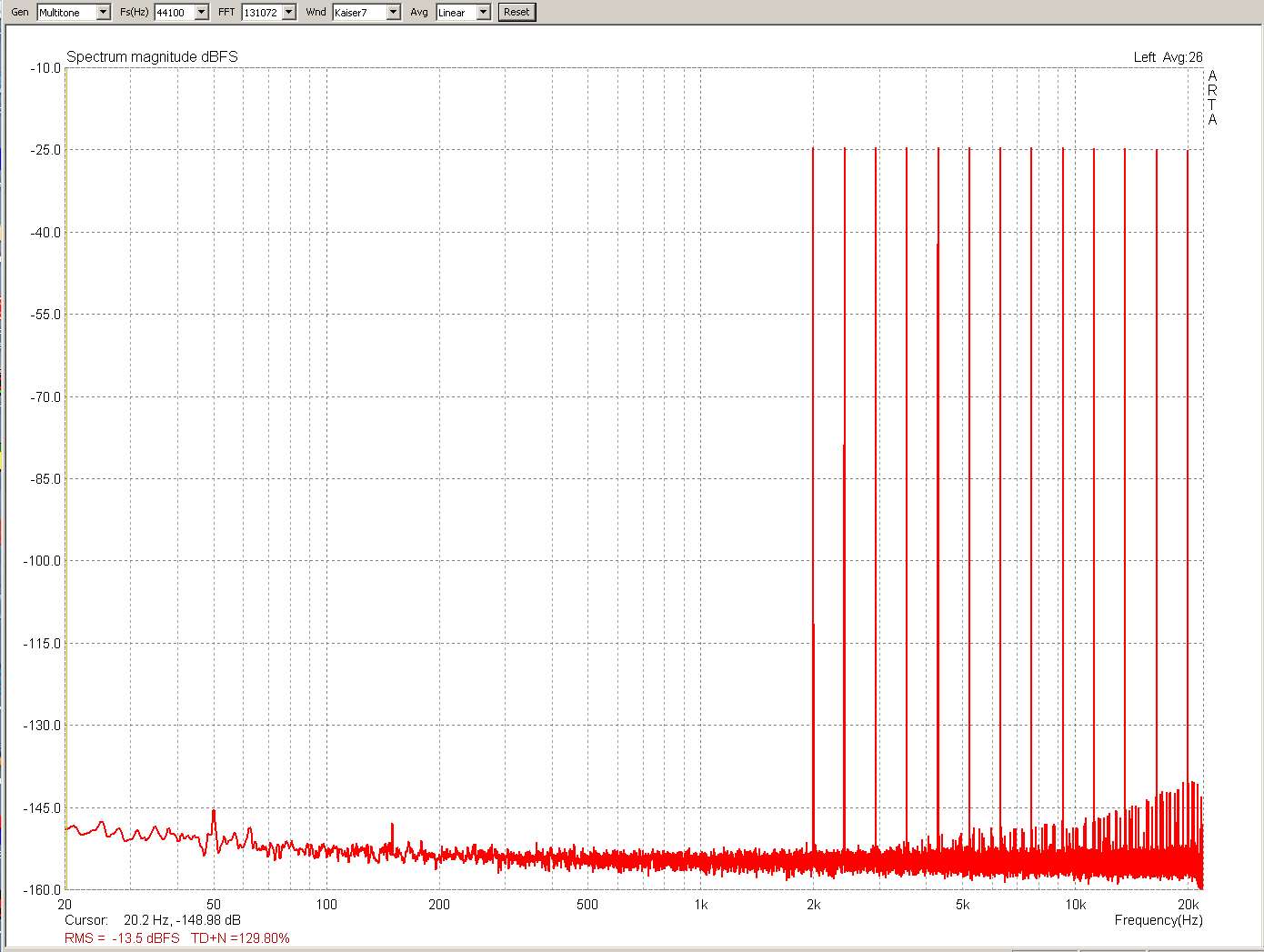

For completness, here are again the shots for the LME49990.
This seems to be the bipolar amp that can compete with the precision fet types, in this application. If only it would be less of a pain ITA..

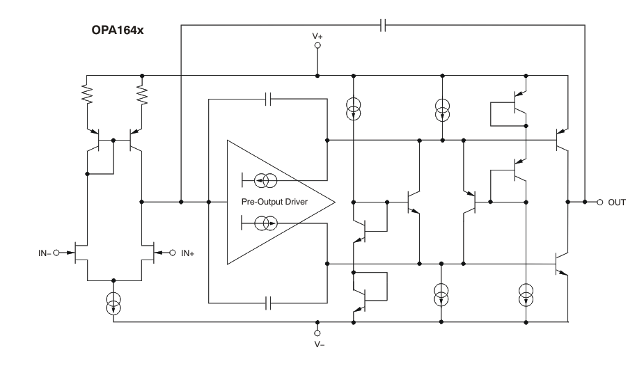

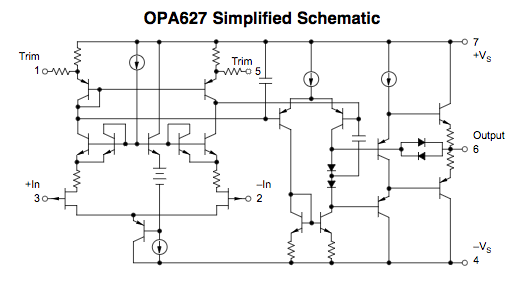

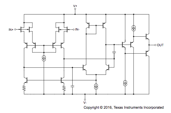

This is an interesting discussion and well on topic for the FE. I have always been curious about the differences between op amps, beyond the simple JFET or Bi-Polar input.
Anyway, I got curious how the op amps discussed here are made differently. AD doesn't offer schematics in their datasheets, but TI does. So using the OPA1641 as the basic JFET input op amp and comparing it to the OPA827 and OPA627 shows some interesting differences.
The 1641 has a single complementary pair of JFET inputs tied to a pair of PNP bi-polars.
The 827 has parallel pairs of JFETs on the input driving parallel pairs of PNP Bi-polars.
The 627 has a pair of JFETS driving what looks to be a PNP buffer and a PNP driver.
I don't know enough about circuit design other than to say these are definitely different approaches, so maybe they should sound different. Take a look at the schematics below.

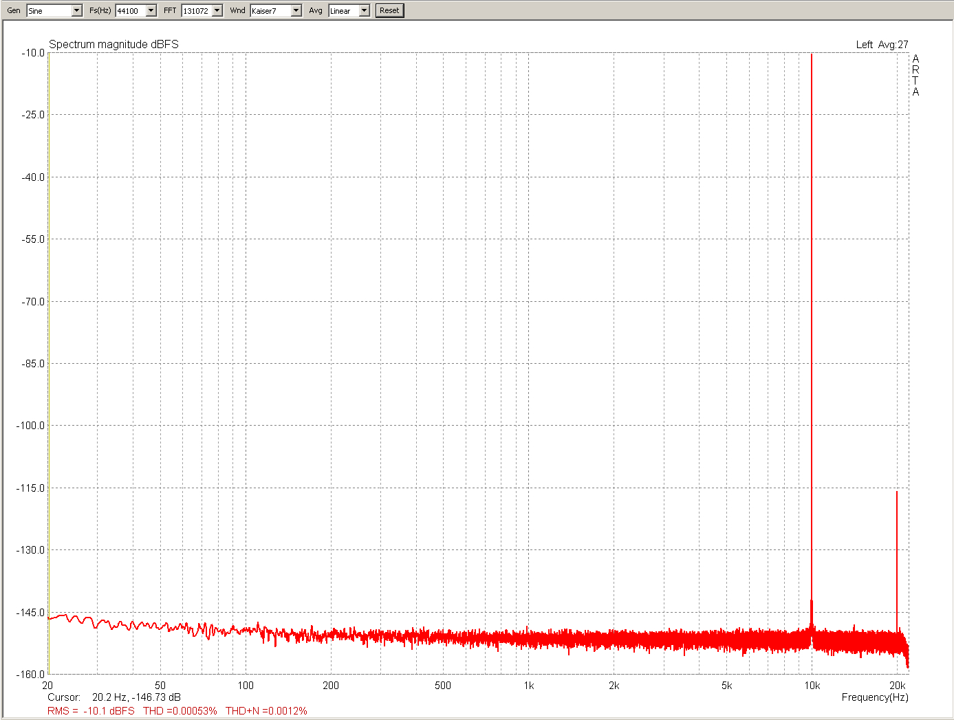

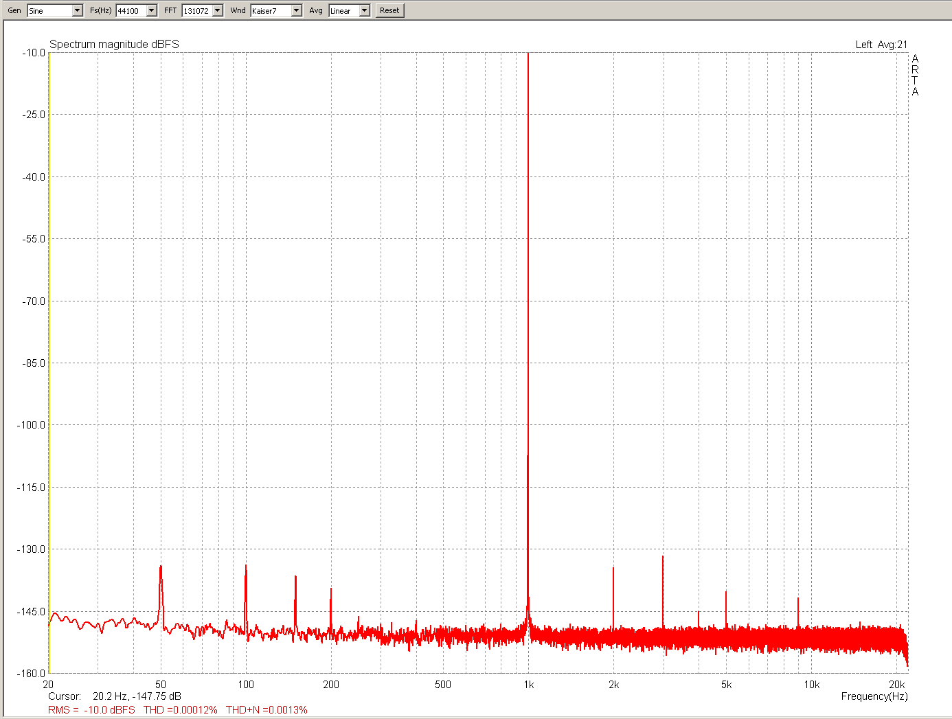

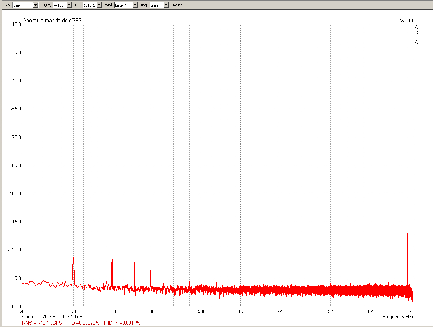

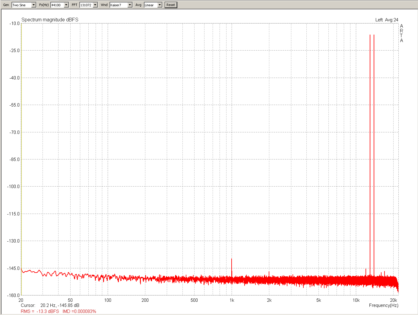

ADA4898
So I had the ADA4898 fit in the second test unit. Because in the other I still have the AD797. Of which I had revisited the compensation scheme, which had been overdone at first trial.
But no real change in the response, even with an optimised, close-to-minimal compensation this time. So it seems to be really the response of the AD797 itself, what had been shown earlier.
Finding an okey compensation for the ADA4898 was quite smooth, and here it is the result:

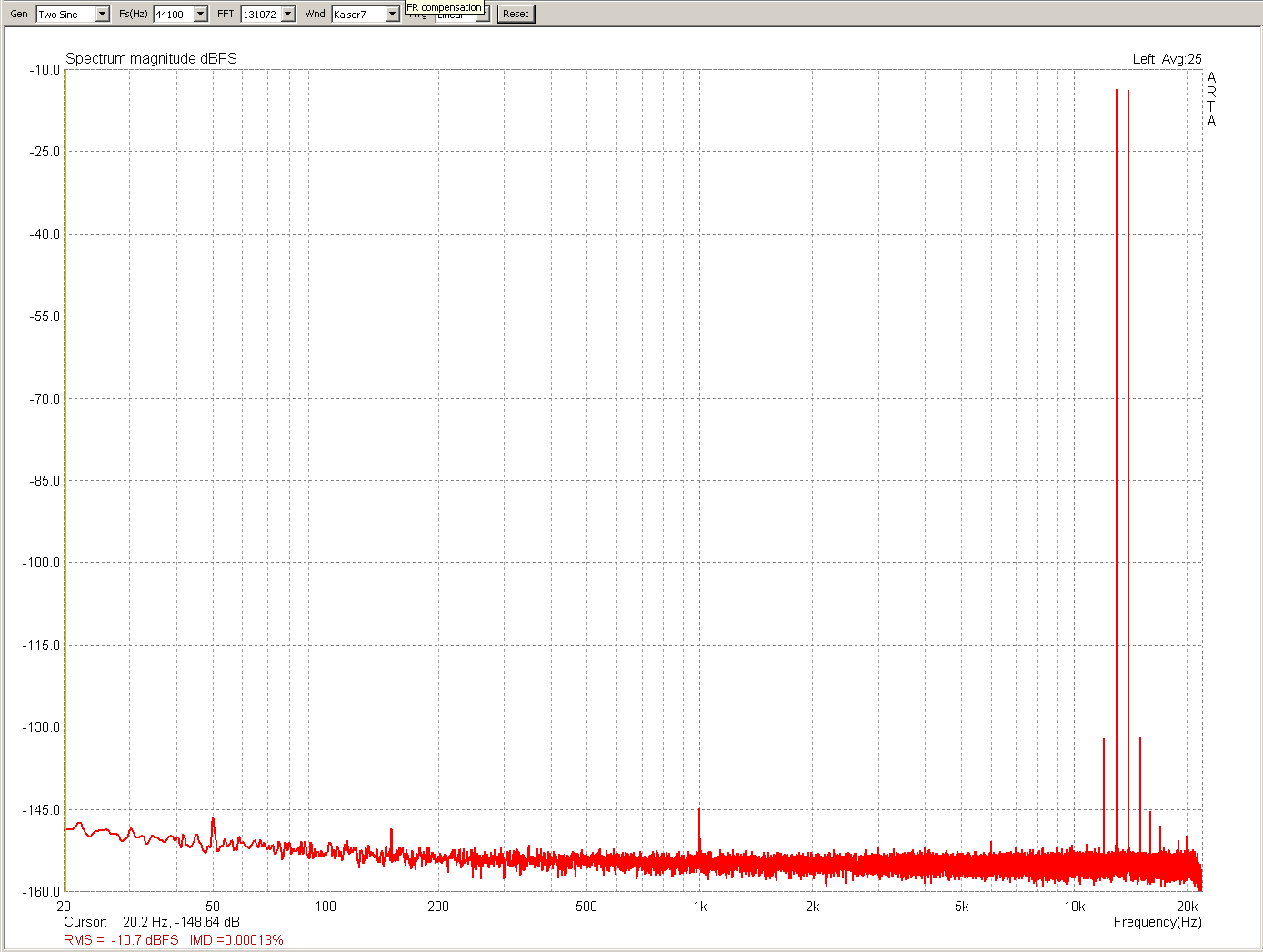

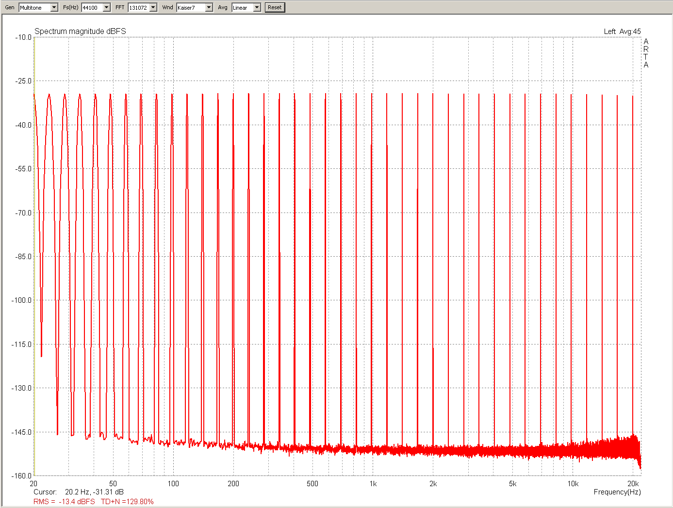

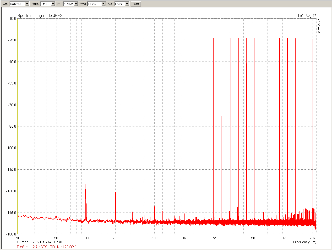

Also, for fun here it is again my favorite, a comparison of test methods: the multitone test done in a 'zero stress mode' like it could be seen at some other place.
And a real one, the high frequency intermodulation for the module, always with the ADA4898:

May I grab the occasion, touting qualities of the device under test: Who of You had noticed distortion level changes (not hum contribution) in measurements between modules off the lab supply or the real full power supply? (Unregulated, transformer+rectifier+filter caps)
Jac,
Also: if you take a look of the datasheet of the OPA211/1611 full bipolar (SiGe) family, you might note some nice similarities.. (to the 1641)
Then: shooting from hip: ADA4898 (high voltage SiGe bipolar) is probably the same design line at AD, that the OPA1611 /211 for TI.
OPA 627 is a bit older, from before the SiGe 'revolution', but was the luxury, expensive dielectric-isolation fet-bjt technology of yesteryear. The input devices have much less capacitance change with tension, and so less capacitive distortion.
