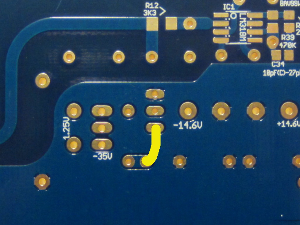

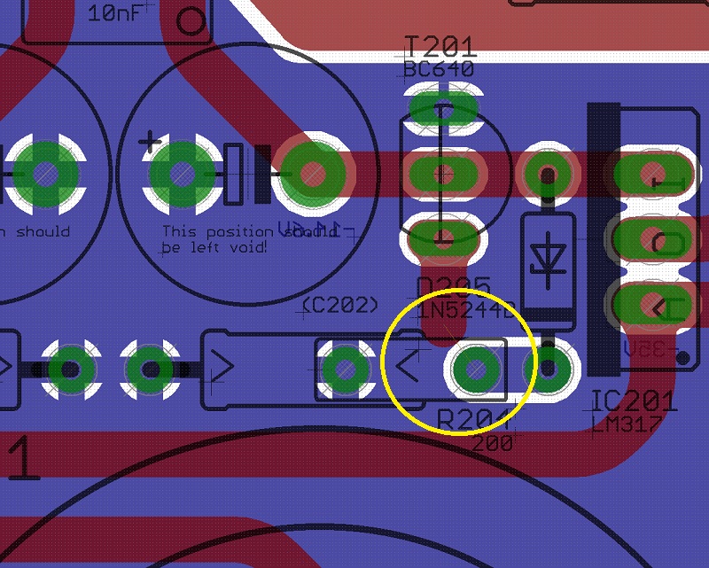

PCB 1.10 problem (easy fix)
I can't understand how but while generating the Gerbers I've sent to manifacturing a tiny bit (1.5mm) of a track of the negative regulator have been chopped in the Eagle project.
It can be easily fixed with a very short jumper wire (solid core preferred, a wire trimmed from a capacitor or a resistor will be perfect):
I've checked again the gerbers, comparing also with previous' GBs ones, and I didn't find further problems.
The fixed PCB will work perfectly and I expect no impact on performance.
I'm really sorry for that... if someone from the 5th GB can't live with it please PM me.

Dario,
No to worry. This is DIY. Stuff happens. And happily it is easy to fix. I once had a similar issue with a commercially sold kit/pcb. That amp is still working 30 years later.
Just curious, is this the reason for Sergio's power supply voltage error? I just fired up 4 V1.02 boards built with components were probably bought to the same specs as Sergio's and the voltages were all fine.

Thanks Jac
Yes, the base of BC640 is not connected to the output on 1.10 boards, the jumper restore the connection.
I'm using too 1.02 boards and all voltages are fine, the 1.10 are the only ones affected by this problem.
Fixed !!
Thanks for the help, Dario!
You're welcome
So now the output is -14.6V?
