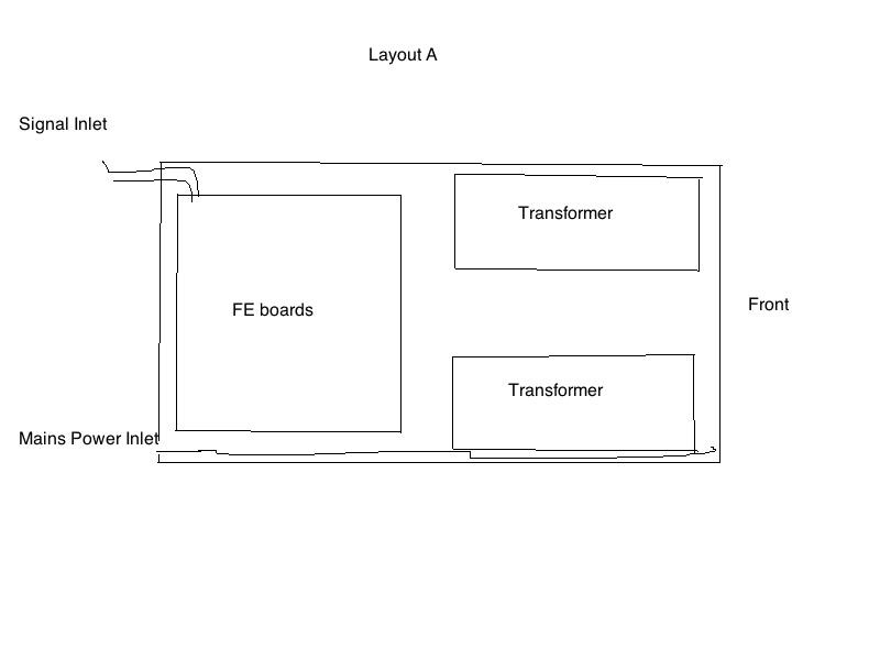

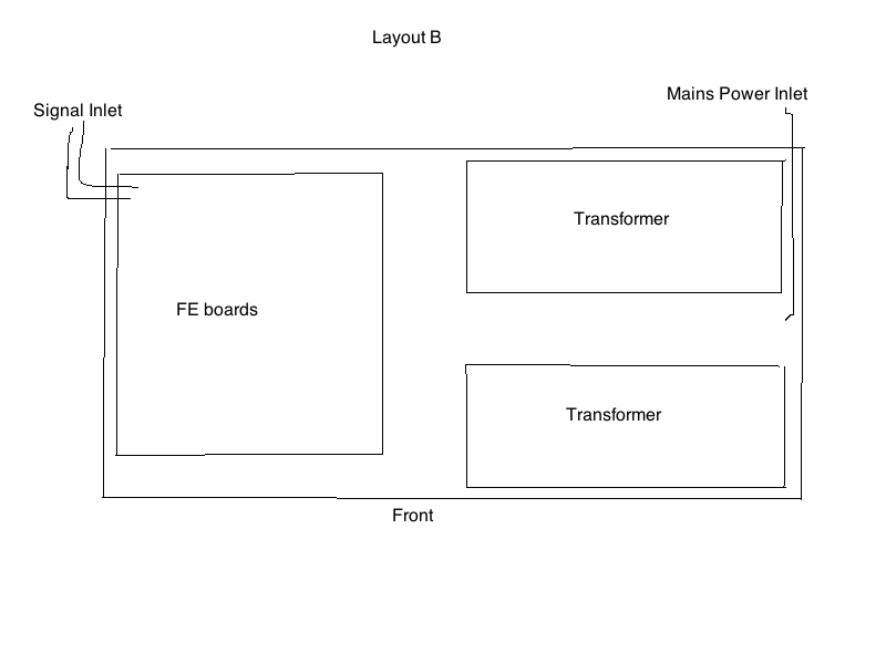

I am thinking about the layout of the FE amp that I am working on and would appreciate some input from you guys.
The place where the amp will sit is short on surface area, so I have decided to minimize the footprint of the amp by stacking the amplifier boards and mounting the transformers to the sides. This will result in an amp that is taller, but has a smaller footprint.
The question I have is regarding the mains power inlet. The width of the enclosure is only a little more than the FE boards. If I build the traditional layout with the amp boards at the back and the transformers at the front, then the mains power line coming from the back panel will have to pass within about 25 mm of the edge of the bottom FE board. Even though the FE amp has good PSRR and it's the power supply side of the board, it seems risky to run that much current so close.
I could shield the power inlet and mains wires by building a conductive enclosure as it runs past the amp board and ground that enclosure to safety ground at the power inlet. That configuration would be my plan with Layout A.
Less convenient for using the space and less attractive looking would be Layout B. In this case, I turn the enclosure sideways and bring the mains power in from the other end of the enclosure. It is clearly ideal from a noise standpoint, but less attractive from a package standpoint.
Can anyone comment on running mains power that close to a My_Ref or other amp board? Also comments on experience with a shield enclosure for mains power would be great. I could make the shield enclosure out of either aluminum or copper. The idea of the copper would be a better conductor and not as good at sustaining eddy currents.

Jac you could always use one of these and mount a switched IEC inlet in the front base of your amp so that you can mount things in the usual? way.

As to your build, I'd go with layout B myself. I prefer to keep mains wiring as far away from the boards as possible. Why build in a known potential problem which could be difficult to solve once the amps finished is my take on it.

If you strictly follow pairs of close coupled wires for EVERY circuit, then you will find that interference effects are very much reduced.I am thinking about the layout of the FE amp that I am working on and would appreciate some input from you guys.........
Close coupling the mains wiring and the terminations reduce emitted interference.
Close coupling the input wiring and the terminations reduces the sensitivity to picking up interference.
When you do this, you will find that mains to low level interference virtually disappears.
Try it without the chassis.
Move temporary wiring around. Place it alongside the FE PCB. Does it create any noise change at the output?
Place it under the PCB, then over the PCB.
Are there any locations where you can hear, or measure, an increase in output noise?
Once you have found the "no go" areas, then you can layout your Chassis/modules.

Thanks Andrew. I should have thought of that and tried already. I will give it a go.
Also, I like Marra's idea in either layout. Not running the mains power inside of the chassis and using a "stealth" 90 degree inlet plug both keeps the power isolated from the boards and allows the chassis to be a little narrower.

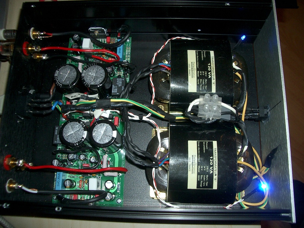

Hi Jac,
since I've already used it with succes, with both the TP My_Ref and the FE I would go for layout A, simply run power wires (twisted, as Andrew suggested) between modules.

Hey Jac,
FIY - The version I shipped around (still never got full reviews 🙁) is only 10.5" W (w/.5" wood sides) - 7.5" D - 5.5" H. The board mounting style has worked great with both a MR V1.2 and the FE. In fact the "mini" is all I have used for the past several months. You can see the AC path in the photos starting at post #1315 - 1317. No special metal for shielding was needed and the amp is hum free. Might just work for your limited space.😉
Hey Jac,
Hi Bob,
Good to hear from you. Thank you for this. I don't expect to be shipping mine around the country, but it is a good idea. I had completely forgotten about your "back to back" approach. Very nice.

Mains Power Wires Close to FE boards - Noise
I took Andrew's advice and did a little test to see if I got any noise when the mains power wires ran close to the boards. Of course, twisted wire would be the best, but as a first try I just moved an extra long mains cable everywhere I could reach that was close to the boards. As Dario reported, no noise issues. YEAH!
That said, my thinking on where to place the amp enclosure has evolved and I will probably build it in Layout B, with the mains power coming in at the other end.
