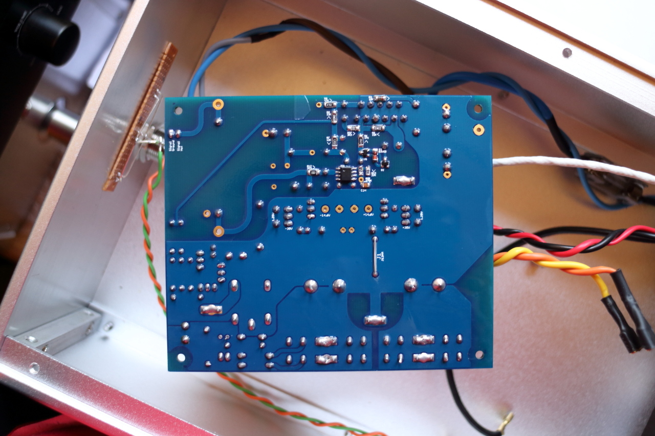

Hello everyone,
I just finished building the MyRef FE.
Besides a problem, now resolved, of cold welding that prevented the ignition of one of the modules,it played perfectly. I like it very much!
In testing I double checked the voltages and I noticed that on both modules instead of having -14V, I get -18V, the other voltages +14v are OK.
Visual analysis does not show anything wrong, the components are taken from Mouser (recommended BOM list ) with the only variant of ERO caps.
I'm not forcing them but they are playing since several days for hours. Temperatures are OK (about 30 °C).
Does anyone have any idea of the possible causes of such behavior? I suspect a anomaly in the BC640-16 I purchased.
I just followed the installation instructions provided by Dario!
Sergio

Sorry, cant see anything obvious so maybe an off spec component, maybe someone else can help identify which ones to test/replace??
Have you double checked for solder bridges, maybe between the AC in terminals and ground plane?
BTW I don't see a mains earth connection to chassis either!
@scorda
I have seen about 16 V on one of my op amp power supply voltages. The regulated voltage power supply is for the LM318. It is OK up to +/- 20V, so I don't think you are causing any damage. I suspect that you are correct, that one of the components is off spec a bit and causing the different voltage.
Of course, Dario or others may be able to comment on the effect of the -18V, but I think you are OK. Just enjoy.
