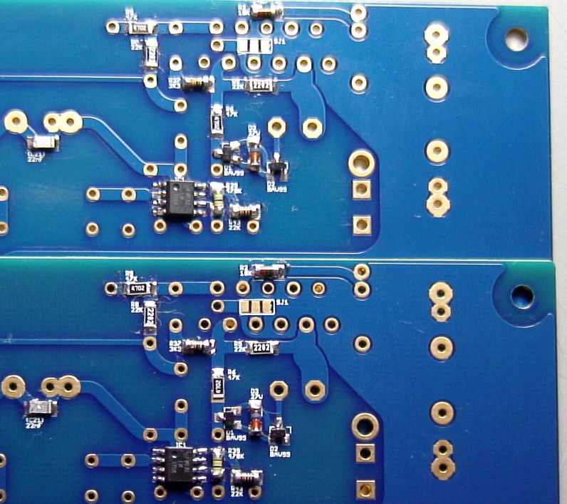

What is the purpose of 4 diodes bav99 and zenner 27v connected between output of opamp and power output ? I think this is new in your My_ref FE version.
Also what is that SJ1 symbol connected to pin 7 of LM3886.

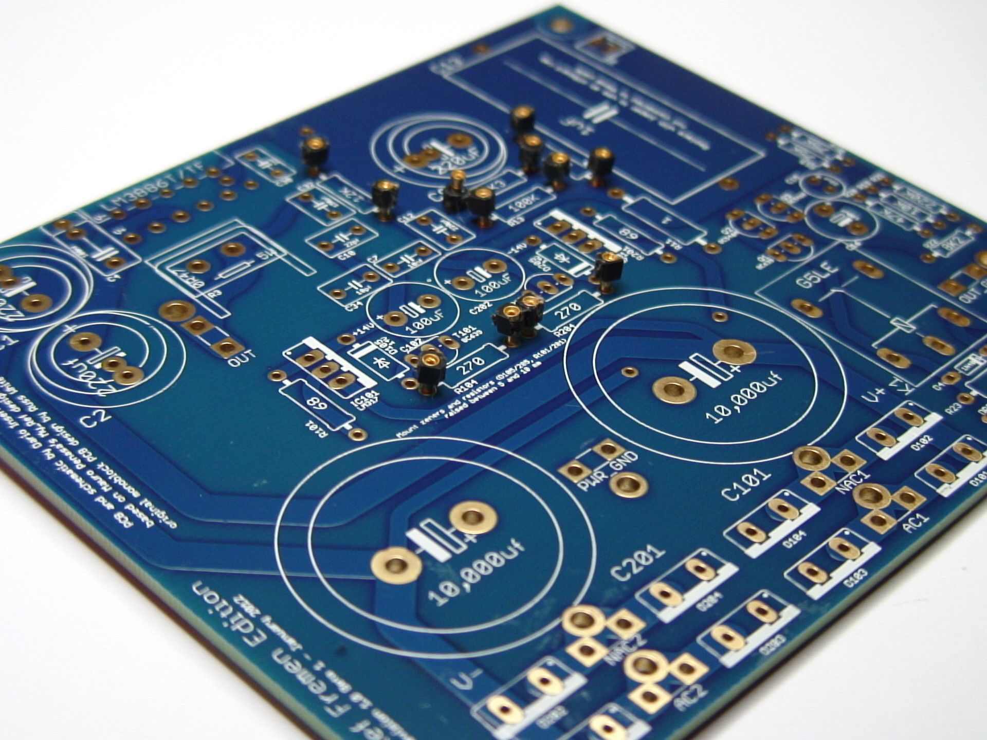

Final build?
Dear Dario, great work as usual!
How is the beta test going?
I will be interested to purchase boards and (kits perhaps) to build when you get into final production stage. The My ref Rev C ultimate BOM I built still sounds great, but time to build again soon I think!
It's a safety measure, a voltage limiter that pemit use of higher rails on LM318.
The idea come from the My_Evo.

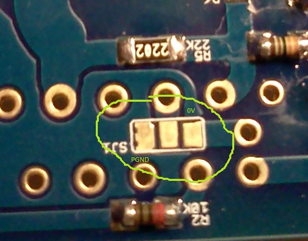

It's a solder jumper that allows different grounding of mute circuit of the LM3886:
To AGND like in the Rev C or to GND like in My_Evo Rev A.

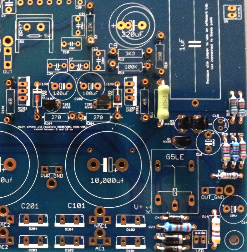

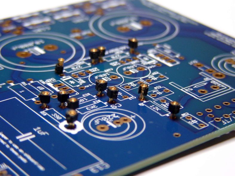

Hi Bob,
nice soldering work 🙂
Do you plan to use Black Gates for C9? If so C21 shouldn't be mounted.
C103 and C203 are optional, it would be better to desolder them, but possibly they don't harm either.
Maybe you can desolder them after the build is completed so you can report if removing them sounds better (It did in my case)

Dario, my plan was to do a "standard" build so I can hear the changes as I upgrade.
Fine, C21 is needed then, just remember to remove them when and if you'll mount the BGs in your upgrade path.
I almost made a post earlier today to request an explanation of C103 and C203 and I'm still not quite sure of their function. I looked back on the threads but couldn't zero in on anything. Info Please![]()
C103 and C203 have the same function of C5 in the My_Ref RevC (removing spikes from bridges) but using soft recovery diodes they're not needed.
In fact, if you ground the LM3886 to GND (the better sounding solution, IMHO), the amplifier sounds better (more dynamic and full) without C103/C203, at least in my system.
I've left them as optional in beta boards to let people test them (maybe different transformers than mines need them).

Just remember to short one of the two posistions of the solder jumper with a solder bubble.
I suggest you to use the PGND one but you can change it in any moment desoldering the bubble and shortening the other posistion, your choice.

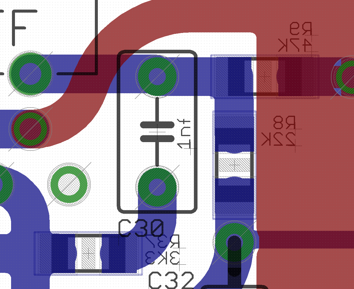

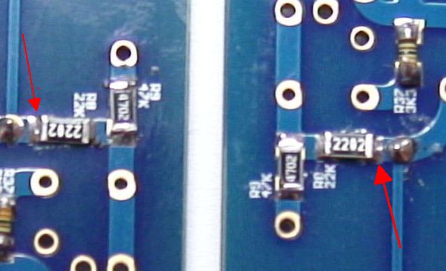

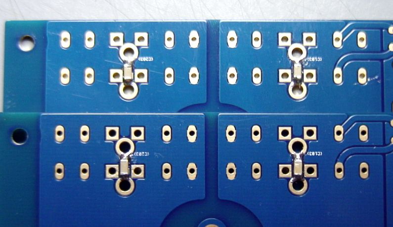

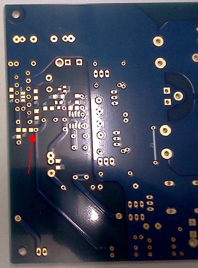

Installed resistor sockets as described by Dario.
Couldn't tell if indicated spot is an allowable bridge or if it's just a super close tolerance.
Not sure if these photos should be posted here or on the other thread ????
Don't worry Bob, these pads are on the same track so no problem if they bridge (see attachment).
And yes, this is the right thread 😉

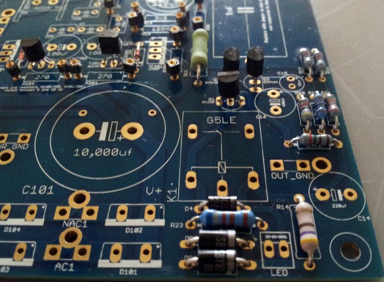

The D105/D205 diodes I got from Mouser are glass (1N5244B) and those in your picture are not (1N5351BG). If I use the glass do they need to be raised above the board as on the MyRefs for ventilation?
I don't think they need to be raised since they dissipate barely one tenth of their rated power.
Now I'm using too 1N5244B and they're not raised, no problems so far.
