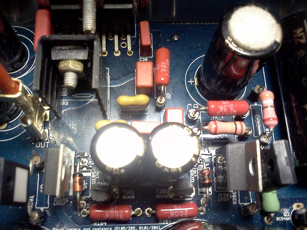

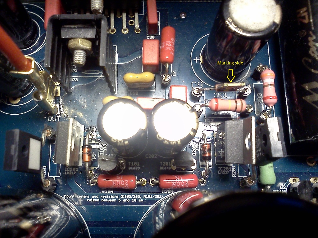

Components selection
Testing will continue but so far the best combination for signal path I've found is:
R7 12K Metal film (PRP 9372)
R10 390R Carbon film (Takman Rex, Riken)
R12 3K3 Metal film (TX 2575 or PRP 9372)
R13 100K Carbon film (Takman Rex, Riken)
For R12 a naked z-foil seems the best but a much (much) cheaper PRP is also very good (marking direction is the same as signal
For carbon films Takmans sound very good, full and balanced (red band toward ground
[*]), Rikens sound even fuller, maybe too much.
For R101/R201 (current setting resistors) the fuller and best ones are Caddocks MP915.
For R104/R204 I'm using PRPs (marking direction is opposite to ground
[*] Only if you trust in resistors directionality (or in my opinion... 😀), otherwise ignore it.

I've attached two pictures that will make more evident which resistors's direction to use for who cares about it.
