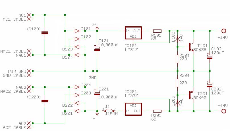

Looked at the schematic. It's not exactly a simple shunt, we need to consider how it biases the transistor. I think this is what Andrew was suggesting. Now that I look at it, do we really need the transistor?

The shunt is nearly identical to ESP project 37's PS:
(Image linked from ESP' site)
The simpler shunt can be found here, the one I'm using adds the base/emitter resistance, which acts as a sort of feeedbak (terminology may be not proper).

The transistor lowers zener's output impedance by transistor's HFE, isn't it a nice thing to have? 😉

I have not done the calculation, but if the total current sink is always within the limit of the device it is supplied to, then it is fine. However, since we are only redirecting current based on the variation of load impedance. The source impedance should remain high. I tend to think that the design should be geared towards damping of current.

According to datasheet LM318's maximum supply current is 10mA (5mA typical).
The CCS generates 24.5mA, the zener current (basically set by the 200R resistor) should be 3.2mA so, current flowing through transistor is between 11.3mA and 16.3mA according to the opamp absorption.

Sorry for jumping into your thread but I've been reading your work for a while and I hope I can help. After drawing the circuit from ESP into Multisim and simulating it a bit I might have found answers to some of your questions.
First, do you use a 1W zener or a 5W ? Using a 5W limited by a R4 of 200R is far too low current. Using a 1N5363B, Izt is @ 40mA and Izm @ 158mA. According to my simulation, it starts to regulate properly @ 15mA so 47R would be appropriate. Using a 1W zener, 100R is perfect and to simplify everything you should stick to a 1W. And yes 1N53xx is simulating better than many other zeners so they might be better sounding too.
Second, simulating the circuit, I get around 3.45uV RMS(1N5363B), but if I add an other 2200uF capacitor after R2 in parallel of C3, the ripple drops to 1.94uV RMS(1N5363B). It makes a 2 stage RC filter and seems to work properly.
It's up to you to take the risk of using a better sounding zener but according to my simulation, improving the RC filter is reducing the ripple by as much as using a better zener. Sure you can risk everything and do both.

In fact with BZX85 the 200R value works very well and I'm planning to use 1/2W 1N5244B zeners so that the 3.2mA would be plenty for them.
I think 1/2 watt should be good... 3.2mA * 14V gives less than 50mW, ten times less than rated dissipation.
If I raise CCS' current output heatsinking became necessary and there no space for it on the PCB.

Just started simulating yours. ESP's circuit is a nice 120Hz sine wave @ 10.2uV pk-pk... The LM317 introduces an irregular sawtooth waveform of 175nV pk-pk using the 1N5244B and 320nVpk-pk using the BZX85C13.

I need to add a LM318 to my simulation to be sure. The op amp might reject a lot of noise so improving the circuit might give no result. Sine and sawtooth might affect the LM318 the same way (It's getting too much theoretical). Sometimes balancing imperfect variables sounds better...
The original RevC has the same kind of sawtooth ripple but it is more in the range of 25uV pk-pk. The diode might be the cause of the sawtooth (and not the LM317).
One thing is sure, the 1N5244B simulates better than the BZX85C13 in your circuit.

I think your CCS is generating more current than you think. Please look at the bottom of this page.
Amplifier topologies for current-drive - Current-Driving of Loudspeakers
I don't think so:
(image linked from current-drive.info)
The CCSs used int he PS are type (a), according to the article the current is always VRef/R.
In case (c) current would be higher as you told but it's not our case, am I wrong?
You are right. I am getting 25.1mA out of LM317, 3.40mA into the Zener, 16.7mA of collector current (BC639) and 4.99mA into the LM318. More current through the LM317 would go straight to the transistor (the zener too but negligible because it is base current).
