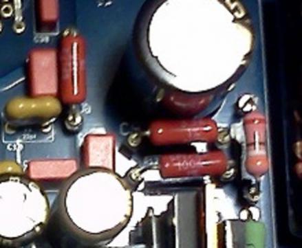

That's a typical symptom of either a dry (non-ohmic) joint on one of the resistor leads, or a flaky resistor with a cracked/loose/non-ohmic end-contact. Reversing it probably fixed the dry joint or made the end-contact sit snugly, thus solving the problem
Hi Siva,
all through hole signal resistors are socketed (see attached magnification) so the difference is not soldering related.
I've reversed it several times with always the same results.
Takman REX, in my experience, are directional.
The Same for PRPs.
It could also account for some of the hum/crackling artefacts reported - in my experience, the MyRef is sensitive to dry joints at several location
This is a possible hint, maybe the problem is socket related... 🙄

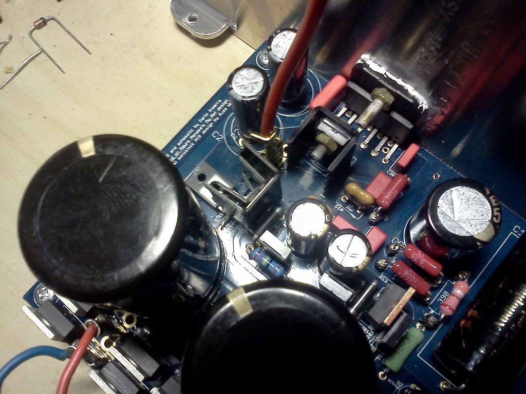

I think that I've finally found where is the problem... LM317's power dissipation.
When idle temperature on LM337 is 44 °C, on LM317 57°C (23°C room temperature).
I've replaced both LM317, the new ones heatsinked, problem seems gone.
What puzzles me is that when on breadboard this problem did not appear.
Just for the sake of precision I've measured also both unregulated rails (+33,6Vdc and -34Vdc with 2x24Vac transformers) so there is not a voltage difference...
So for all beta builders: buy TO-220 thin heatsinks for LM317s
This Mouser code should be suitable: 532-576802B00

Interesting heat sink on your 3886.
Are the Mundorf smoothing caps bigger (taller) than Panasonic TS-HA 50V at C101.201 ? Your M-Lytic are 10000uf 63V MLGO right. I think the chassis I am working on is too small.
what changed ?
Maybe the fact that on breadboard there were more air around them... I don't know.
How many 68R and 270R should one buy to get a good match ? ... or can I pay PartsConnexion to match for me ?
I don't think matching is necessary with 1% resistors.
The 'heatsinks' are server heatsinks for harddisks... temporary, obviously... 😉

The data sheet says use high quality tantalum. Try this before you replace the
voltage regulators. They could be oscillating, hence, that high temperatures. Take\
care.
Remember that a breadboard is basically plates separated by plastic dielectric material. Hence, breadboards have a lot of built in capacitance.
Interesting, never though about it. 🙄
I would suggest placing four capacitors around the LM317 and LM337. The input capacitors would be 0.1 microfarad. The output would be 1.0 microfarad.
Both datasheet and this Jung's article don't talk about decoupling for LM3x7 CCSs...
Or simply a broken BC639 lower output voltage and thus raise voltage on LM317, paired with same current -> higher temperature.
In these days, waiting for the LM3x7s to arrive, I've made several measurements and experiments.
For example measuring currents with a multimeter leads immediately to a broken BC639/BC640 AKA lower output voltage.
Just a note: while 1N53xx sounds fuller they, maybe have a touch of hardness but as hours are passing it seems to lower.
That hardness never gone completely while BZX85 didn't have it.
Superfigone pointed out via email than he thought the 270R don't give enough current to flow through the zener.
In fact, since Vbe measures 0.638V, current is 2.36ma.
So I've tried 200R (current = 3.19mA) and hardness seems almost gone.
Probably 150R (4.25mA) could be better.
I did expected to fine tune values but I didn't expected that the initial values could be bad....
Zeners are generally run where they are on the low dynamic impedance part of the I vs V curve.
If you run too low a current through the Zener you can be operating off the low dynamic impedance part of the curve.
I recommend that any Zener be run at 10% to 99% of it's max operating Power dissipation.
Incredible, I was just reading some docs on dimensioning zener shunt regs... same recommendation.
Andrew, are you remote-controlling my mind? 😀
Jokes apart, so it seems the 1N5352 should be operated at about 32mA...
In 1N53xx datasheet I can't find any indication on minimum zener current while on BZX85 one is clearly stated that minimum current is 2.7mA, quite lower than the 7mA found using the rule of thumb.
But even if we suppose that 1N53xx behaves in the same way (no guarantee about that) we still need at least 20mA...
Maybe going back to BZX85s could be wiser... I don't know...
