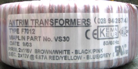

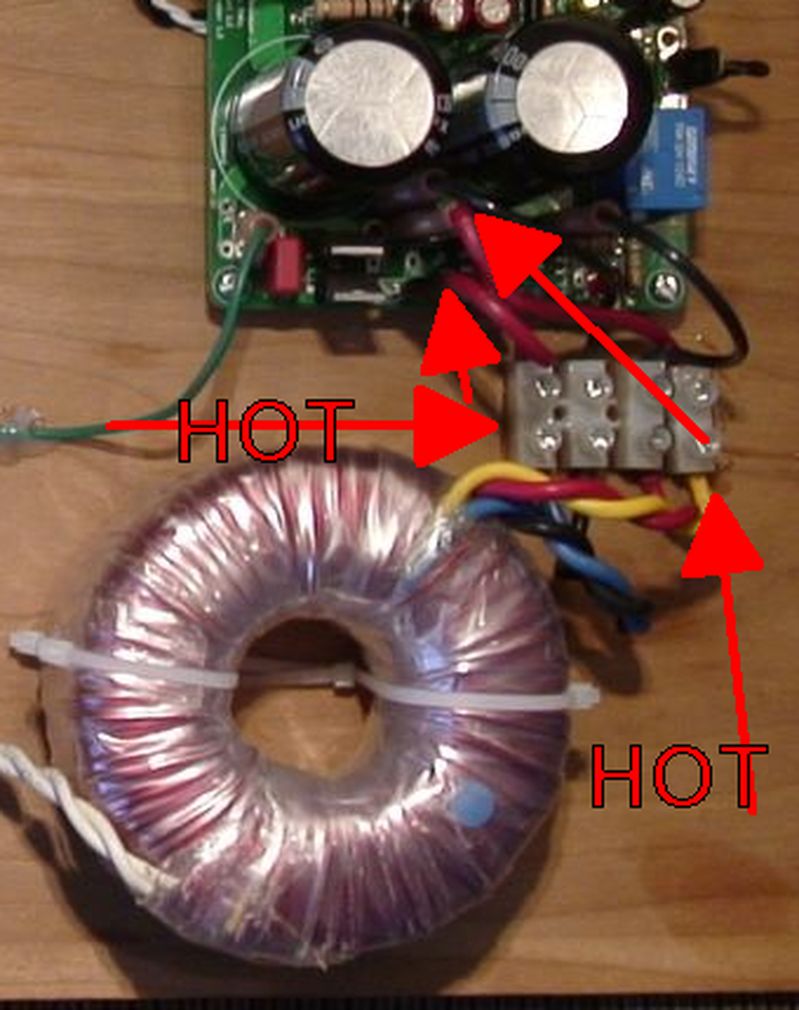

I can show you how I branched mine (see attachment and pay attention on traasnformer's label and colors order).
Colors are written in French:
Violet/Gris -> Purple / Grey
Bleu/Rouge -> Blue / Red
Your transformer do have a label with secondaries indication?

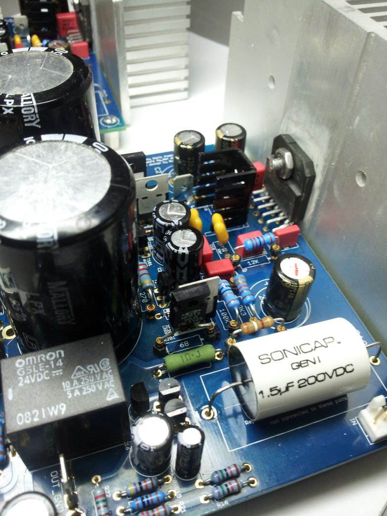

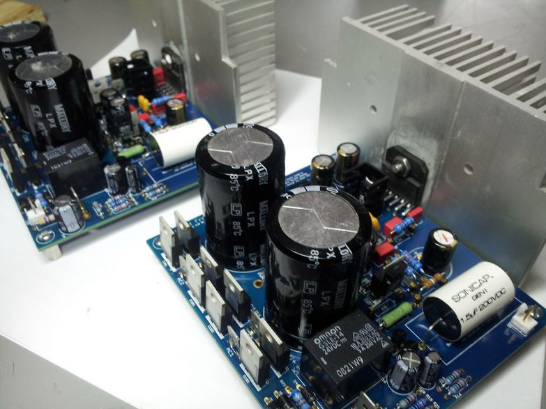

The build seems fine but I can't see the input cap... are you DC-coupling? 😀
And smoothing caps? 🙂

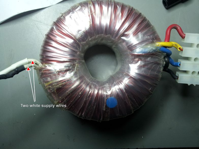

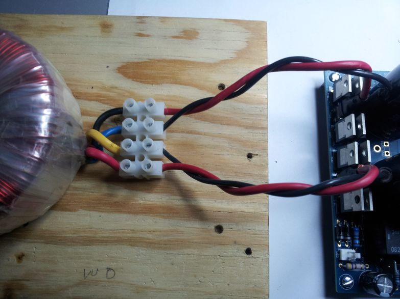

Unfortunately this toroid doesn't have that detail on the label. What's in the picture is what I've been using on the V1.2 and V1.3 amps as well as the BrianGTs. Red/Hot (outside on terminal) wires to AC1 & AC2 - Black wires (Neut on above photo - two inside wires) to grounds. On Siva's V1.3 I used two ground wires direct from the Euro style terminal to include the extra ground terminal he put on that board.
mmh... without secondaries indications I can't figure out how to tell if wiring is correct... 🙁
In the picture on post #126 the black and blue wires from the transformer form a continuity loop. The yellow and red wires form the other. Does that help? I have an extra Antek unit with info on label but it is 34V
Do you remember transformer data (VA, code, etc.)
On Antek website there are datasheets with secondaries indications
When you make a center tapped connection from a double secondaries transformer on centre tap goes neutral from one secondary and hot from the other.
So that connection is not right for the FE, you should discover which of the wires tied on center tap on RevC is hot.

One of the wires you connected to PGND on Rev C is hot, that wire on the FE must go to AC1 or AC2
O.K. I'll try to trace it down. Can you explain what is different between this and the MyRefs. I'm not understanding. Why is it more critical in this case?
this say that black/blue are one scondary and yellow/red the other.
On a spare (twin) If I connect one probe to either white AC supply wire on the toroid, there is NO continuity to any of the secondary out leads. Don't know where to go from here.
In the U.S. black is hot and white is common. I can assure which is which from the house service box all the way to the toroid, but with no indication of continuity on the toroid itself, It's only a guess.
I can hold off till I get a proper unit from Antek if that's your recommendation. It would be here by the end of the week

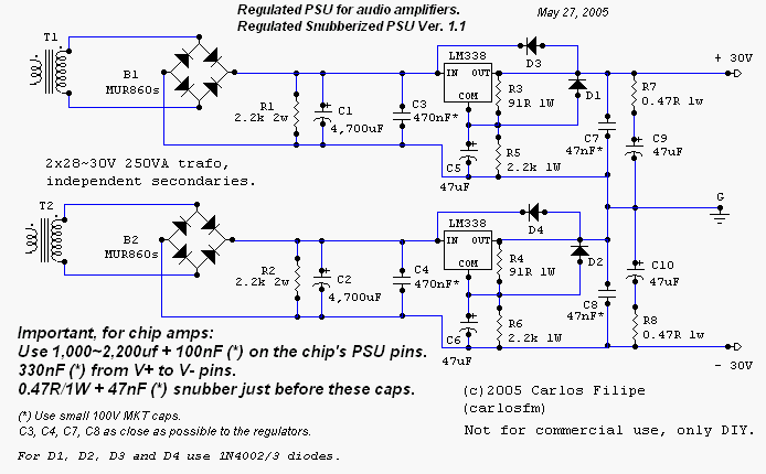

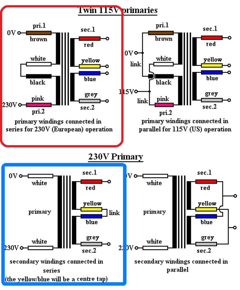

See this picture from Decibel Dungeon (double secondaries to center tap, like in RevC):
The dot indicates hot (phase). (read this)

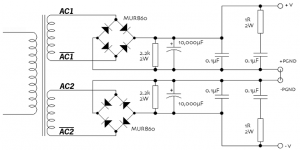

In Rev C a center tapped transformer is needed since it uses a single bridge, the FE uses a double bridge, each of these bridges needs a secondary.
In center tapped connection virtual ground comes from secodaries wiring, in double bridge (and thus double secondaries) virtual ground come from the bridges.
On the transformer you should have a label like this:
(picture from Decibel Dungeon)
Or at least a model number so that you canfind a datasheet on manifacturer website.
The FE is wired like double bridge Gainclones:

As you can see on decibel doungeon picture the dot (phase) on each secondary in on the upper lead, as it is on the primary.
So upper wire is AC (phase/hot) and lower one NAC (neutral).
But I see now that phase in your picture is inverted (lower lead), so it is the contrary:
AC1 Yellow
NAC1 Red
AC2 Grey
NAC2 Blue
But probably it works also like in the previous post but it would be out of phase.
Any transformer guru can confirm it? 😀
