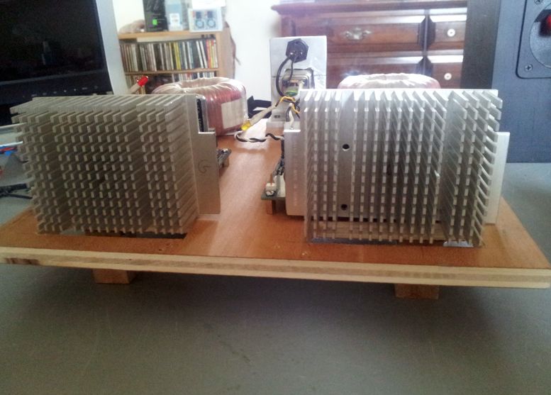

Just hooked up to the "Sunflowers" about thirty minutes ago - sound is great. What I hear first and foremost is balanced tambers and stability of the image. The sound is unrestrained and smooth.

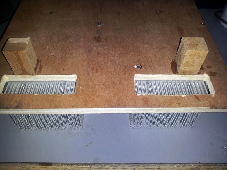

I am seeing higher temps on the LM3886 and the HS. In my hurry to hear the amps I just used the residual heat paste from a former application and the protection has triggered several times. I will rework that and will probably end up using a full slab like this for each amp.
10.000" - HeatsinkUSA, LLC Store
The new cases at the DIY Store here on the forum could be a good option also.

I'm still using the Sony walkman but will switch to the modded PS1 and also try the Mini2496/PC configuration later today. This "Vanilla" base build is indeed impressive.
How would you rate bass?
Maybe the Sunflowers are not very efficient?
My Infinity Alpha are 90dB and never had a problem despite my ridiculous heatsinks...

Yes, the Sunflowers are on the inefficient side and it always shows up with any LM3886 design. From my experiences last weekend, I believe using the Mini2496/PC combination may take care of that problem. I'll know later today. Worse case would be having to add the JC-2 pre in the stream - which is an excellent worse case scenario. The JC-2 is stunningly clean and would match up nicely with the FE.
The bass, at this point (just played a few CDs) is dependant on the source material. That's the reason I'm getting the Munforfs today. I remember the improvement they made in the bottom end when added to the V1.3s. They are expensive but IMHO an absolute must. Yesterday the table under the small speakers was in full vibration on a couple tracks.
I'm sure new paste and maybe strap instead of single bolt LM3886 mounting will cool things down. The triggering I did get was of course at full volume from the Walkman. I don't see it as a serious problem.
a tight connection is necessary for sure

Much better - both amps (direct read on chip) 98F/36C with extended loud play. I'm sure the new Arctic Silver paste helped a lot.
Much cooler than mines... 🙂
Good work! 🙂
