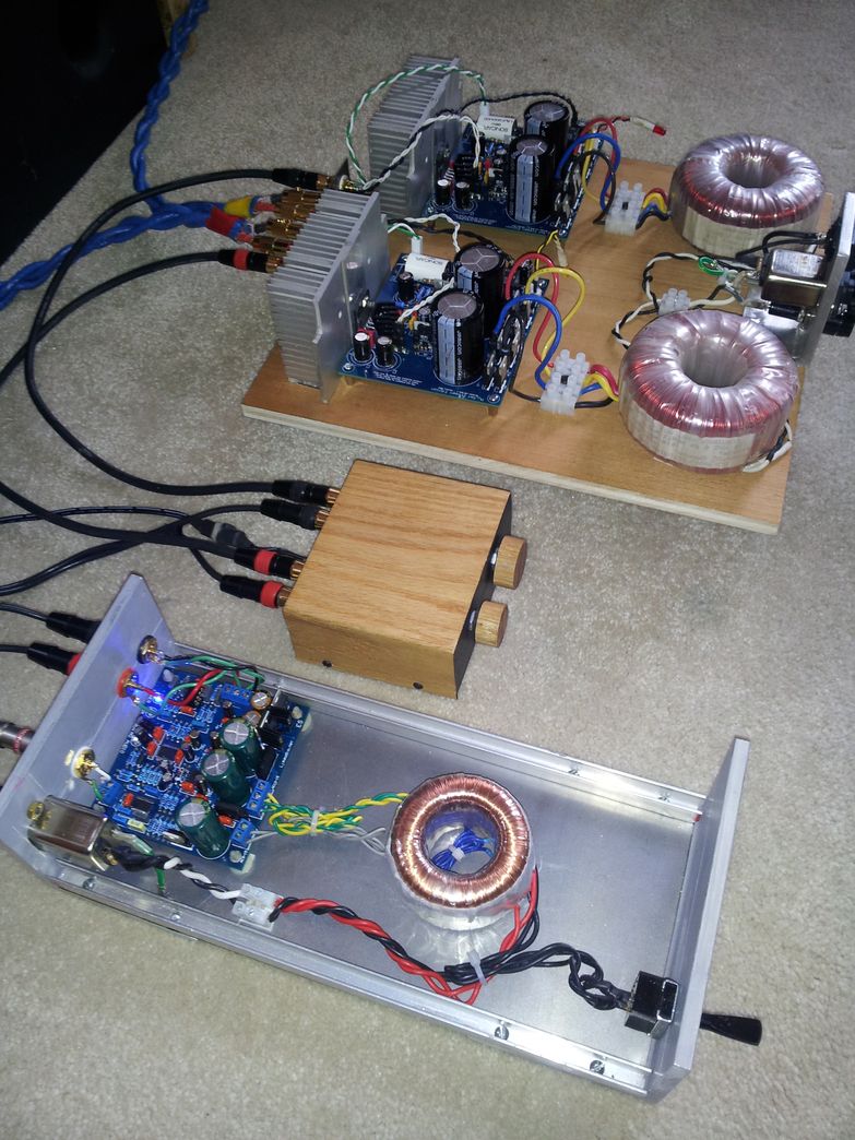

Using uncompressed flac files through a Lexicon Omega DAC did indeed fill in the base output of the FE when played through the lower efficiency Sunflowers speakers. On Pop and Jazz the amps provide about all one would desire in a good high to low balance. The only element that could be enhanced is "growl" and "depth" inside some of the lowest aggressive tones - those elements of sound that would be effected by the leftmost 3 or 4 sliders on a 16 - 20 segment graphic equalizer. This is admittedly at the nit-picking level and I'm quite sure will be solved in many ways including the Mundorfs at C101/C201, Darios Riken recommendation and maybe even the Mini2496 when I get it incorporated.
On the really positive side - the stage presentation has been very impressive. Listening to "Appellation Spring" on this recording,
Amazon.com: The Copland Collection: Orchestral & Ballet Works, 1936-1948: Aaron Copland, Aaron Copland, Columbia Symphony Orchestra, New England Conservatory Chorus, Columbia Symphony Strings, New Philharmonia Orchestra, London Symphony Orchestra, Ph
I can pick out instruments and sections of the orchestra and virtually walk between them. That includes front to back placement. Again, the stability of the image is remarkable. The "wall behind the speakers disappears" phenomenon almost jumps out at the listener. In this song there are several "call and respond" passages where the tympani and bass drum make up the response. As mentioned earlier, they are a bit shallow while at the same time, the string basses are full and dynamic.
I'm still trying to identify a "buzz" "tinny" element the shows occasionally in the higher registers. It's strange because the amp does not exhibit any trace of that electronic/transistor characteristic. Quite the opposite - the amp sounds very warm and tube-like. Hoping the guys with scopes and all the parts swapping will zoom in on the cause - assuming they hear the same thing.
Next step - Change the system to include U Dailey's Lightspeed LDR attenuator and the Mini2496 DAC.

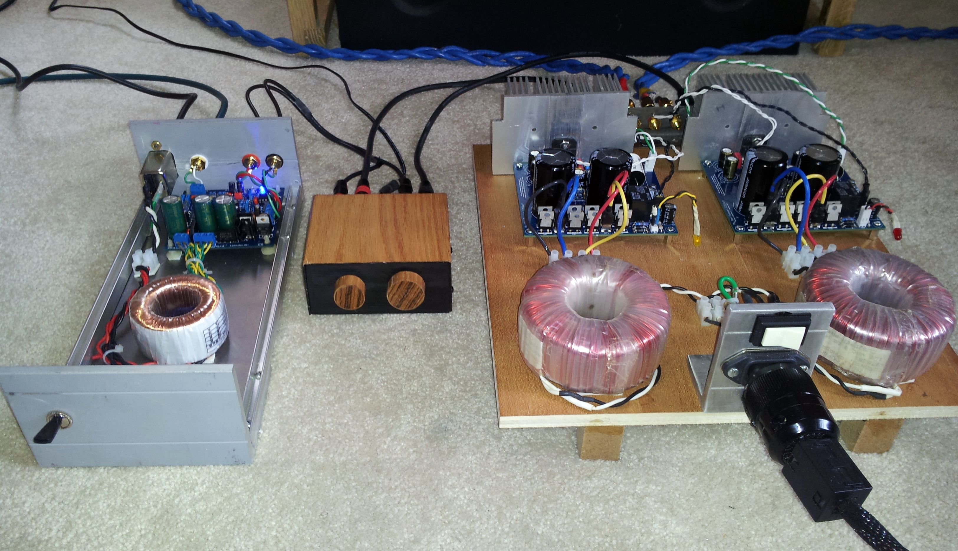

Notes along the way:
On Symphony no. 4 Allegro Ma something or other, I just heard some loud annoying cracks and pops. On replay I discovered them to be the strings on the basses slapping against the finger boards. FANTASTIC!
Moving into the 9Th as I write. Will be fun and exciting.
I can’t say anything about the amps, but after three hours with my buddy Ludwig, I’m ready to take on the entire planet – blindfolded, by myself and with one hand tied behind my back.
The FEs didn’t miss a beat (pun intended). On the vocal passages on the 9th the recording engineer (or the position in the house) placed the chorus to left of stage. The solo voices were distinct, fully separated and easily identifiable by position. When the orchestra comes back in I can hear the heavy rosined bows, the bite of the French horns and unbelievably the individual vibratos of specific members of the chorus.
Amazon.com: Leonard Bernstein: The Symphony Edition: Gustav Mahler, Johannes Brahms, Ludwig van Beethoven, Robert Schumann, Jean Sibelius, Franz Joseph Haydn, Carl Nielsen, Leonard Bernstein, New York Philharmonic Orchestra: Music
(I have the digital uncompressed vol #3 files)
My Radio Shack meter at 12 feet peaked at 92 db. The Lm3886s never went above 101F. There was never a hint of stress or anything being under powered. I had the PC (JRiver Media Center) at 90% volume and the Lexicon at about 20%. I used “Direct Sound” as ASIO overloads the Lecicon.
Summary – It’s been quite some time since I actually got chills hearing music I have known for years. Dario hasn’t yet paid me for saying this but, this morning I did. I could be fully satisfied with this stock build as my go to amp. I definitely can hear elements that can be improved and refined based on the upgrade paths experienced with the MyRef V1.2 and 1.3s, but that’s just frosting on a very impressive cake.

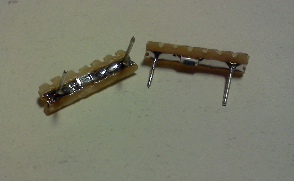

SMD resistors...
I'm considering to use more SMD resistors in signal path for the definitive design.
Using an homemade adapter (see attachment) I've tried on R7 (feedback resistor):
In the next week I'll do some more critical listening sessions but at least the feedback resistor will be SMD.
- KOA RK73H 1% thick film 100ppm
- Susumu RG32 0.1% thin film 25ppm
- IRC PFC12 0.1% 25ppm
- RK73Hs sounds good, a bit veiled, similar to Caddock MK132s
- RG32s are incredibly neutral, transparent and detailed, similar to naked Vishays
- PFCs sounds rich, full bodied and dynamic, similar to Rikens

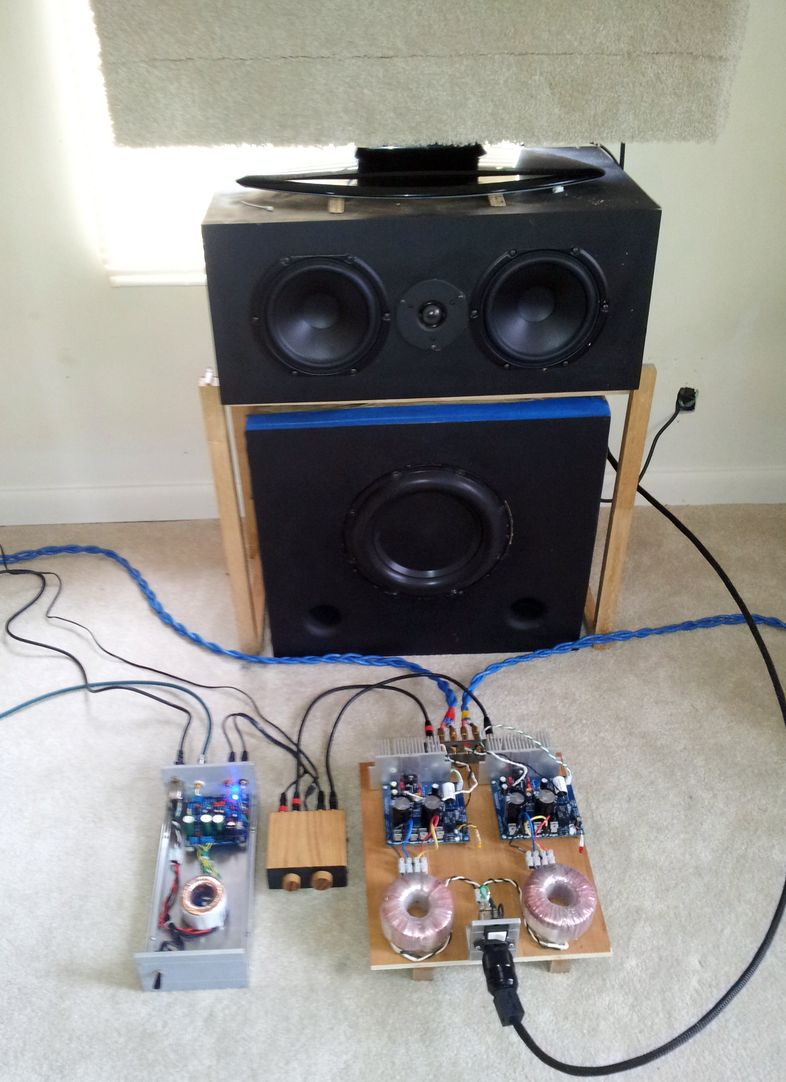

Very good results with latest combination.
The sibilance is for the most part gone. Although absolutely necessary with tube equipment, I'm starting to understand that ALL sound devices require a "warm up" period. I suspect my rushing to get things done yesterday didn't allow the Mini2496 to settle in. It's been my experience that even the MyRef-C V1.2 and V1.3 need about 30 to 45 minutes to really shine.
I won't go into a lot of detail, but I played B&Ws Audiophile Test CD, an award winning Kari Allison offering from the HD Tracks organization, a lot of the Beethoven stuff and a lot of Big Band Jazz. All the vocals backed by just guitar and bass revealed those essential fret noises and overtones. The crack of the stick hitting a cymbal and the punch of toms and foot pedal in drum breaks were accurate and balanced.
I have often reported that, while my absolute preference, LDR attenuators required me to max out the volume pot to get my version of "live" levels with my systems. The combination of WASAPI computer output, Mini2496 DAC and the Fremen Edition amps push enough SPL that I can let the neighbors know what musical mood I am in.
Where the system sits now is like this. Imagine a blackboard that's been used to explain a complicated formula complete with arrows and erasurers and side-notes. Now the board has been washed and only the essential and proven elements rewritten. Both the FEs and the Dac are at stock builds and ready for Dario's upgrades.
Honestly, what I'm hearing now is "Top Notch" and I can only imagine what's to come.

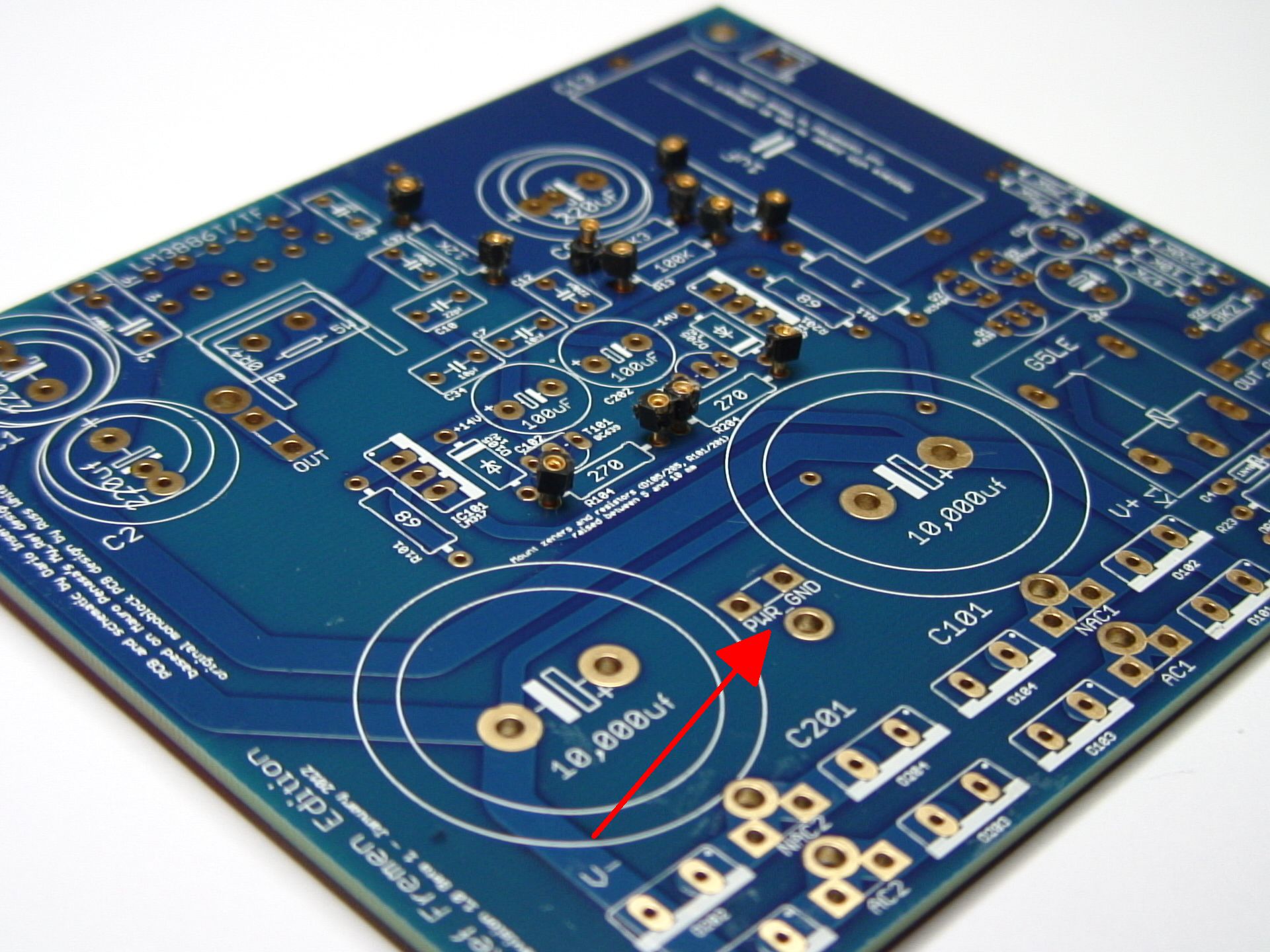

Dario, What's the best implementation of this PWR_GND spot? I'm not getting any hum/noise without it.
I don't use it too.
In fact, IMHO, it sounds better if it's unconnected.
It's there if you want to connect PCBs to safety ground (directly or via a ground breaker).
