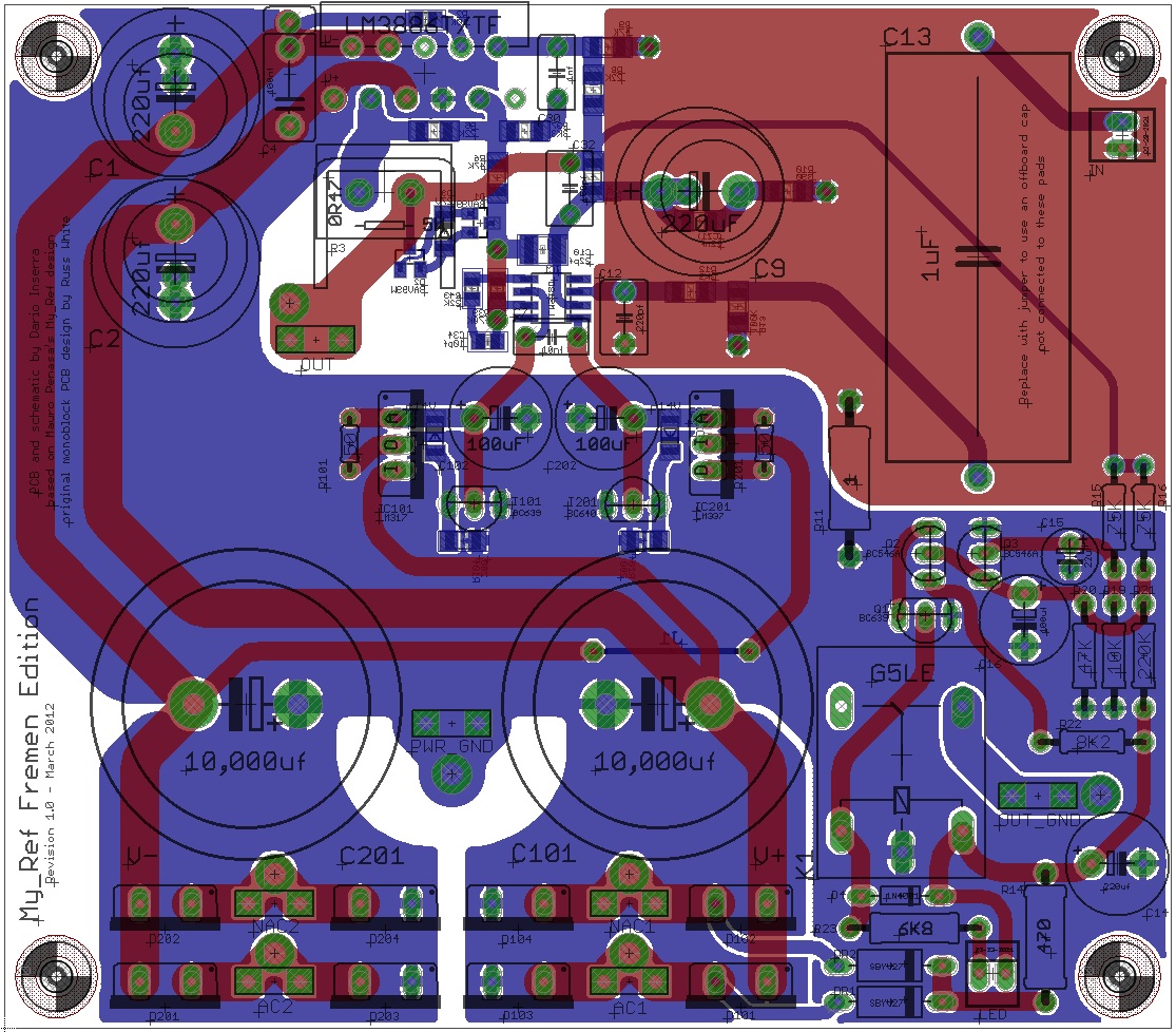

Well, after some weeks of experiments BOM is near the final version.
All direct signal path resistors will be Susumus RG32 and shunt ones KOAs RK73H.
Shunt's PS caps will be Nichicon FGs 100uF 63V and C9 also Nichicon FG (Black Gates are better but FGs are great available alternatives).
Beta-testers can find the latest through hole version on the shared Google Docs folder.
I've yet to do some tests with R101/R201, with SMD film caps (Panasonic ECHU) and compensation resistors (probably going from MELF to Susumus).
Since tests results the final PCB will have more SMD components on the amplifier section (LM318's compensation caps, resistors), some resistors and capacitors (LM318 compensation) will be a bit smaller (0805).
I've attached an updated layout which includes the changes above, larger isolation from ground planes and hopefully easier to solder thermals.

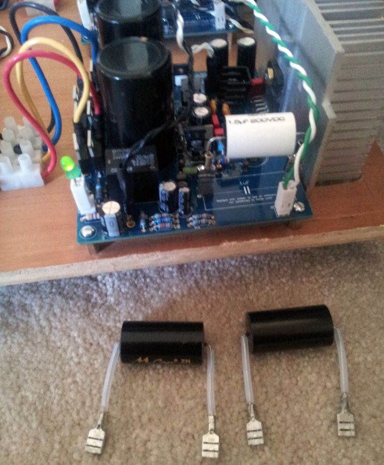

I did the C13 comparisons over the last week using Dario's suggester rig for easy swaps. It is really close and both caps have their own good qualities.
The Mundorf ZNs sounded more precise with noticeable separation between voices and instruments. They definitely have a dryer sound in my system. The side to side stage seems about the same but the front to back depth is reduced.
There is just no getting around the fact that the Sonicaps just sound more "musical" to me. I put that in quotes cause it is such a subjective area/definition. The 3D sensation is clearly more engulfing and I can't tell if that approaches something slightly "gimmicky" as Dario might suggest. It is so difficult to know and to reproduce what sounds "natural" and preferable to each individual.
So my non-answer answer is - the jury is still out. As the Fremen Edition developes there may be a combination of parts that brings out the best in each, or eraces the differences. I'll put the Mundorfs back in again later in the stream.

Thanks Bob for testing and reporting. 🙂
I do agree, the Sonicap is more "musical" but the question, IMHO, is:
Which one is more transparent?
Also, did you tried to DC-couple for comparison?
It seems you're still using the Illinois Capacitor caps for C102/C202, am I right?
If so the dry sound you're earing is possibly due to them.
If you can, mount sockets for C102/C202 and try the amp leaving those positions unpopulated.
If you can try Nichicons FGs there, they're pretty musical too.
Input caps and resistors are the most critical, IMHO, since they carry a low level signal, I think here transparence is utmost important.

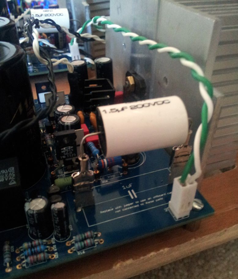

Here's something to throw up the flagpole. I went from Flim and the BBs with lots of electronic bass and jazz voicing, to Pachelbels Canon in D played by a chamber orchestra. The Canon realy sounded muddy and indistinct with the Sonicaps installed. The Mundorfs made a dramatic improvement in seperation of the instruments/sections.
The difference was so apparent the idea of installing both with an A/B switch came to mind. As stated, I usually lean toward the Sonicaps with "modern" music, but the ZNs show a clear advantage with a lot of Deutsche Grammophon type classical recordings.
I know much of this "tuning" can be done with DSP software but I would like to keep the signal as pure as possible. I am assuming such a toggle would be done with the power off, but maybe Andrew and/or others can shed some light here.
Does anyone have comments/experience with this type of arrangement. Switching between caps is so easy and immediate with the fastons it would seem to be a simple option.
Yes, it's better if you power off if you make the swap manually.
But probably if you use a switch it's possible to do the swap on the fly, IMHO.
Let'see if someone else can confirm it or not.
I was afraid that you would suggest more sockets, but I thought it a possibility, and will do so.😡
