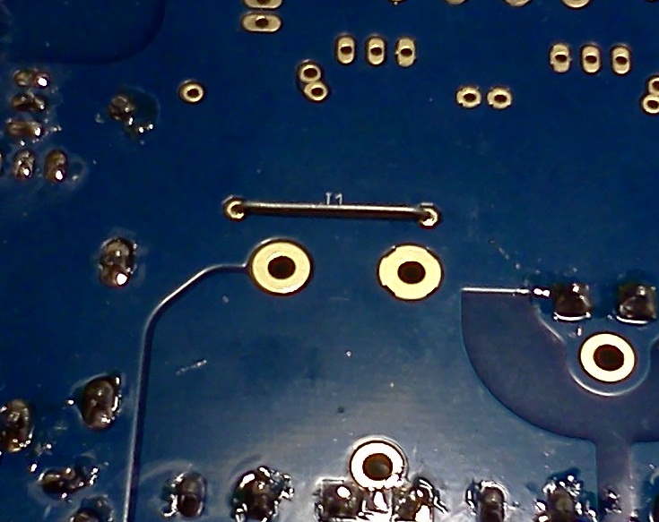

I have populated R2, R5, R8, R6, R9, R37, R39 and R43. Placed the jumper at J1. I believe I could surgically remove hemorrhoids from a gnat's rump, should the need arise. 🙂
What's the story on C21 ?
Did you mount the jumper on the bottom?
It's optional.
