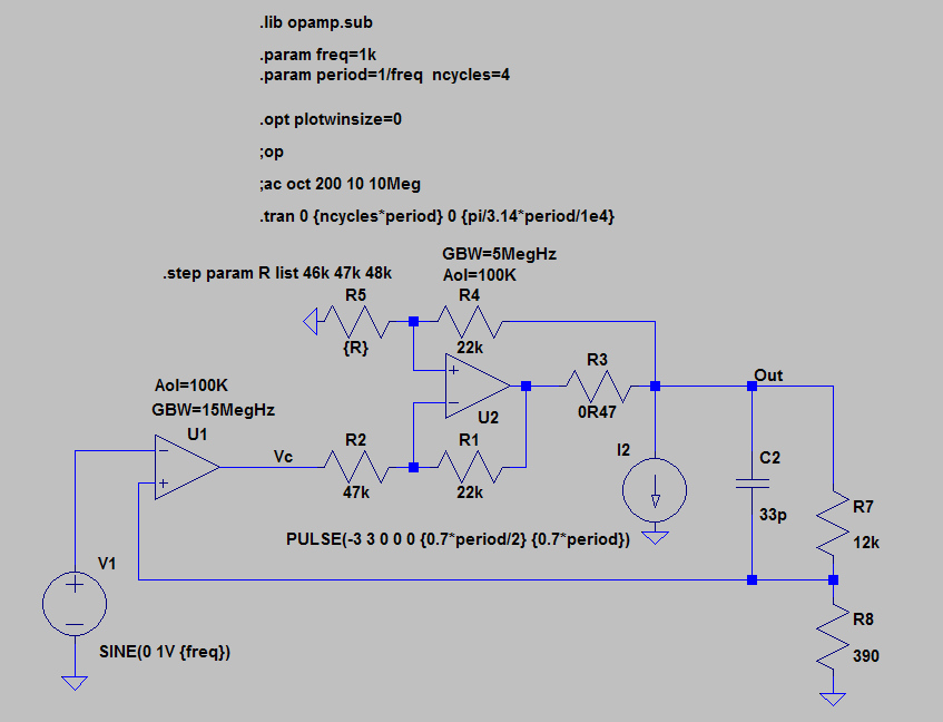

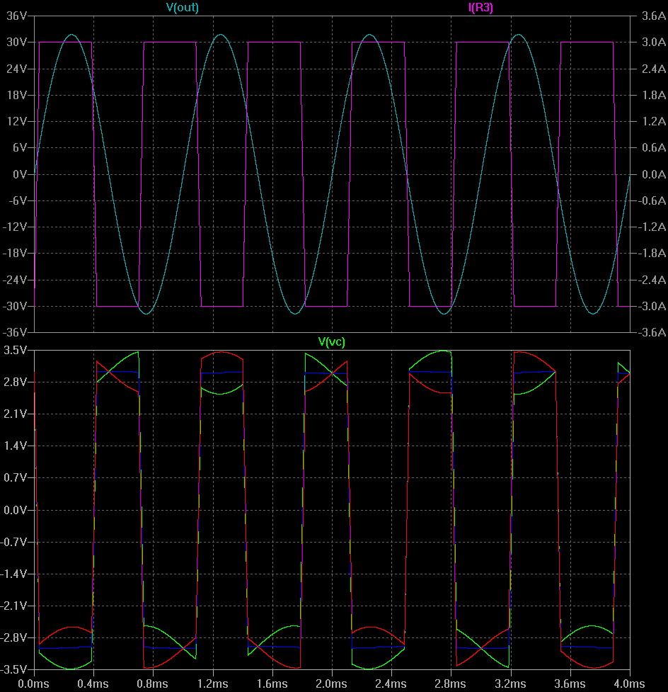

See below sim for the effect of a detuned Howland in the MyRef. Detuning is by setting one resistor to -2%, 0% and +2% of its nominal value, giving the pump different output impedances, including negative.
Input voltage and hence output voltage is a sine as it must be with any voltage amplifier, but to demonstrate the effect I choose a non-correlated square load current for an equivalent of about 10Ohms load.
The output voltage of the first opamp is shown, it is the control voltage for the Howland. As expected, this voltage tracks the current but on top of it a partial "copy" of output voltage can be found. Also we find that even exact resistors (and flawless single pole opamps) doesn't make the voltage part fully disappear as the Howland isn't perfect even with exact resistors, for many of the reasons explained in the paper I had linked to earlier.
Note that with different load currents the control voltage will keep tracking the current whereas the voltage part will stay constant, detemined only by the output impedance of the pump. In the shown setup the point when both are equal in the order of magnitude is reached when the load impedance would be around 70 Ohms which also is the level of output impedance of the Howland in the detuned cases (-70 Ohms and +70 Ohms, dependent on which direction the resistor is wrong).
This means that at points of very high speaker impedance a key point of the MyRef -- making the control and error voltages a function of current rather than voltage -- is missed by a significant margin when the resistors are not matched to at least 1%. Still the degradation from the ideal is not too bad, and resistor matching beyond 0.1% or fine-tuning the howland for parasitics to be a truly ideal pump doesn't have any merits.
Like Andrew I would encourage (true blind) listening tests to confirm any audible differences from a given (known) amount of detuning the Howland down to about (+/-) 100 Ohms output impedance but personally I would not expect any to show up, this will probably be too small a change.
