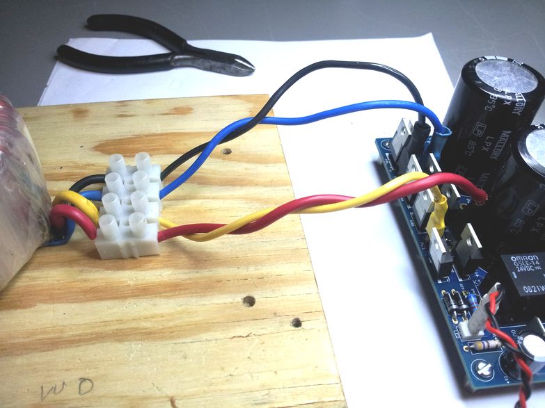

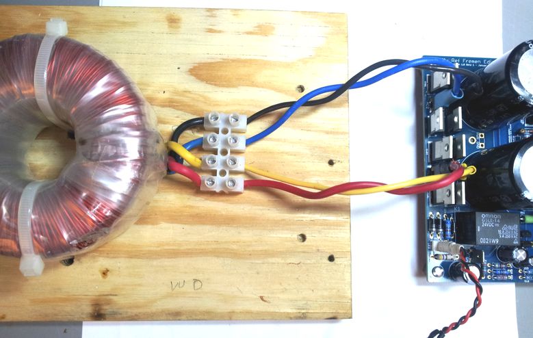

Transformed. Check it out and I'll throw the switch.

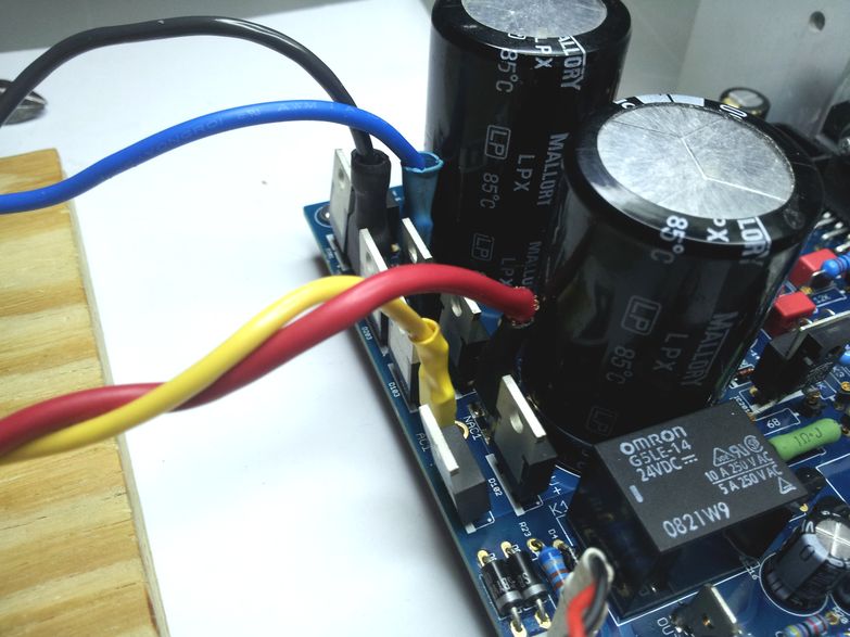

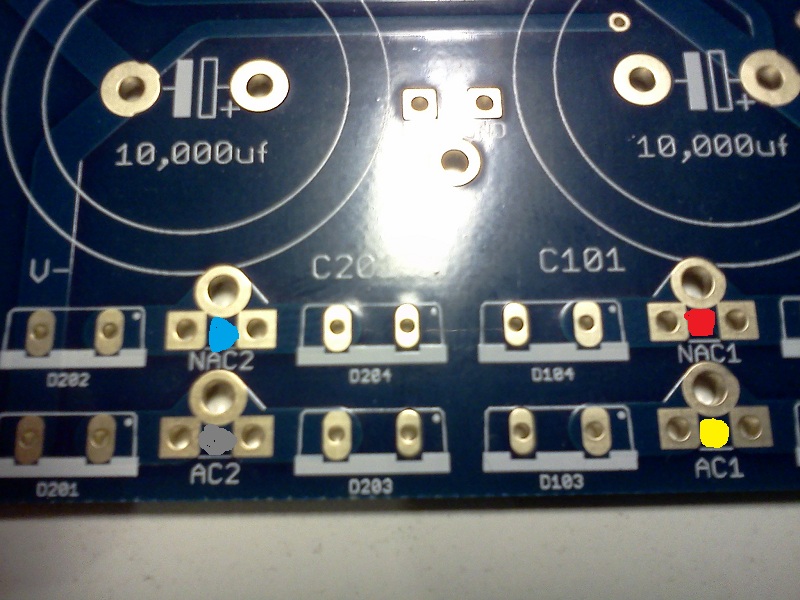

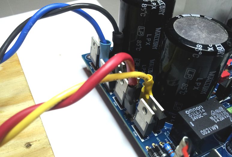

If the wire that seems black is a dark grey it seems quite correct, you should reverse connections.
Yellow to AC1 and red to NAC1
Grey to AC2 and blue to NAC2
ACn are the connections near the border, NACn are the ones near the smothing caps

How's this ?
Seems good... hope it works... it's 2:30AM here . I want to sleep! 😉
the light bulb tells you when it is excess current wrong. The secondary voltages tell you when when it is otherwise right or wrong.how did you determine that?
That's the beauty of the bulb tester.
You can act like a complete idiot swapping around the primary and secondary tappings and nothing blows up.
But sort the PSU before you attach a circuit.

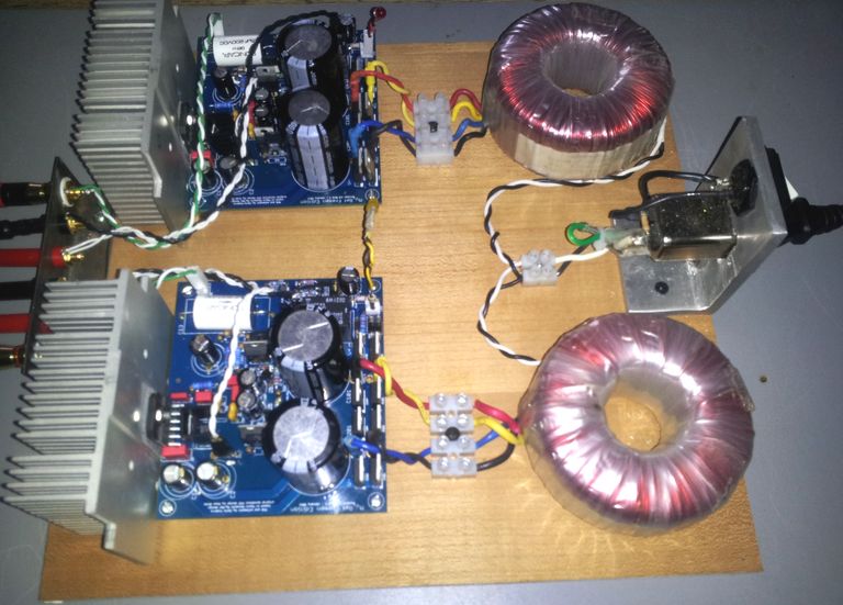

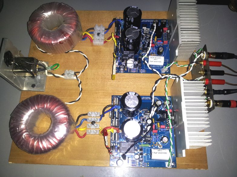

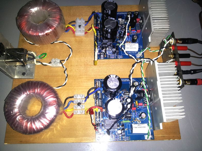

Thanks Andrew. I think we made it through O.K. Getting 3.2mv and 2.8mv for DC offsets. I'll be testing for sound in about an hour when the other transformer is setup.

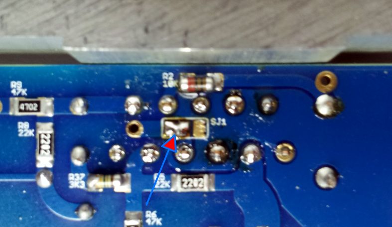

Mornin' Yes, I did it at the same time I soldered the LM3886s. Not sure which choice I made.
You choose the Rev C grounding...
Should I switch?
It depends... the FE grounding is the other and IMHO sounds better.
That jumper is there on Soongsc request to compare between the two gronding schemes.

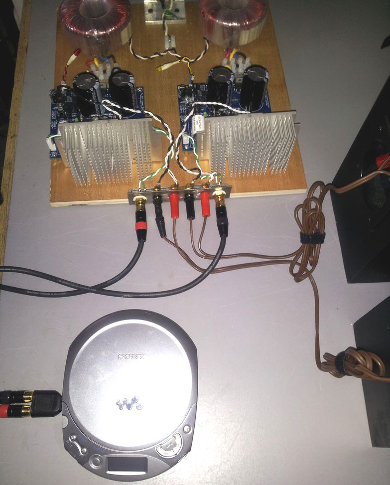

Dario, these amps sound gorgeous!
Even on these mini speakers and without all the upgrade components, I can tell this is going to be one beautiful sounding amp .
Thank you so much for all your effort and your perseverance. The build went smoother than I anticipated and even these beta PCBs are of a quality not often seen. Your support with the build has been supper.
I'll hook up to big speakers after a little safety burn-in.
To all those who are interested -- jump in, it's going to be a fun ride!!

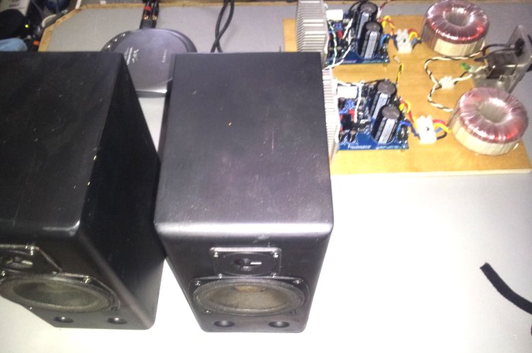

Something interesting - standing about four feet in front of those little speakers as placed in the picture above, there is at least a six foot wide stage with real depth and absolute clarity. Can't wait to hear the full setup.
