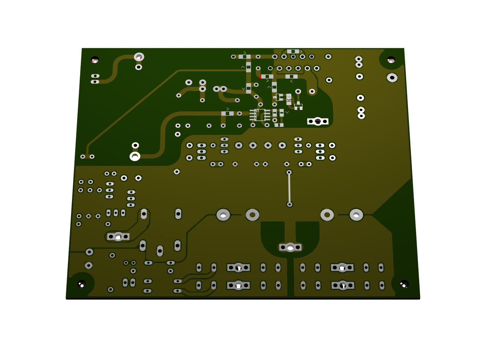

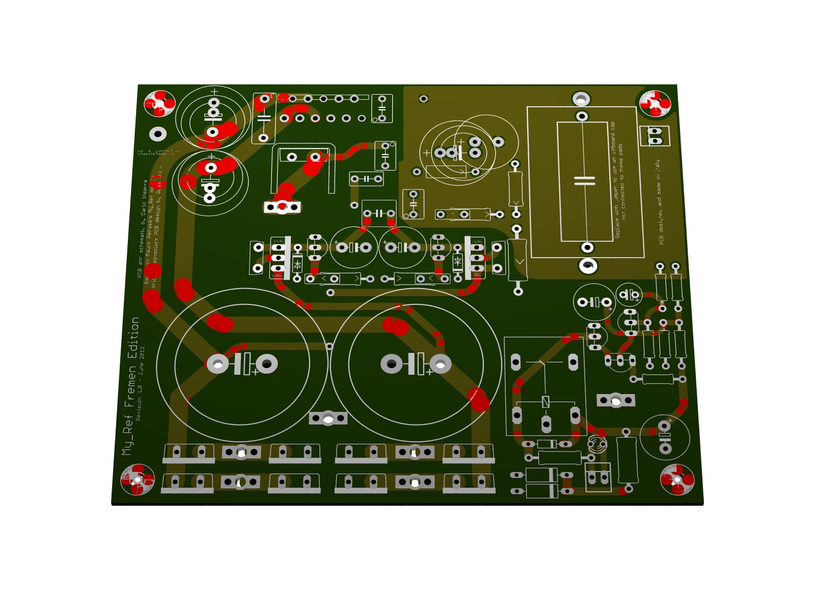

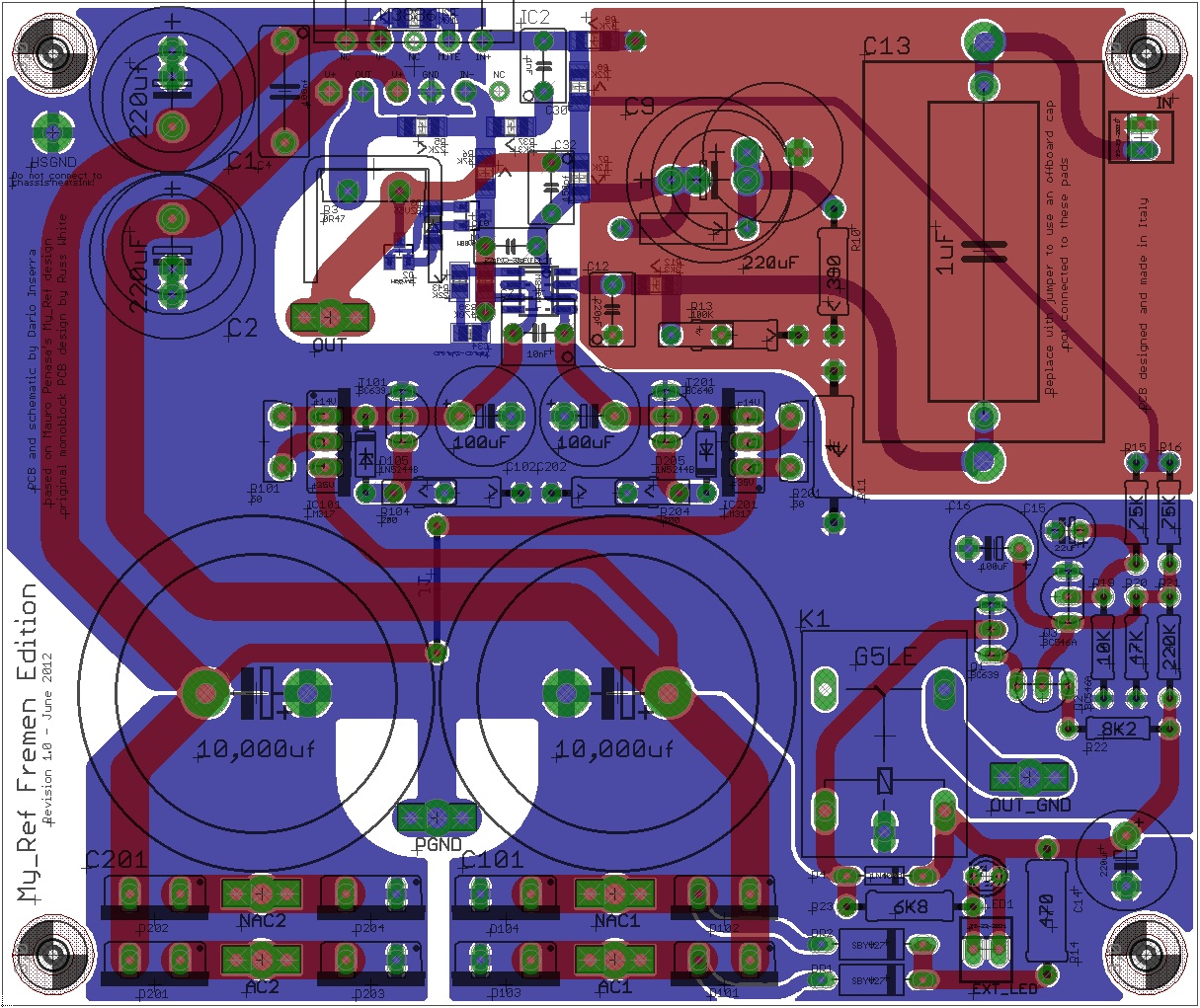

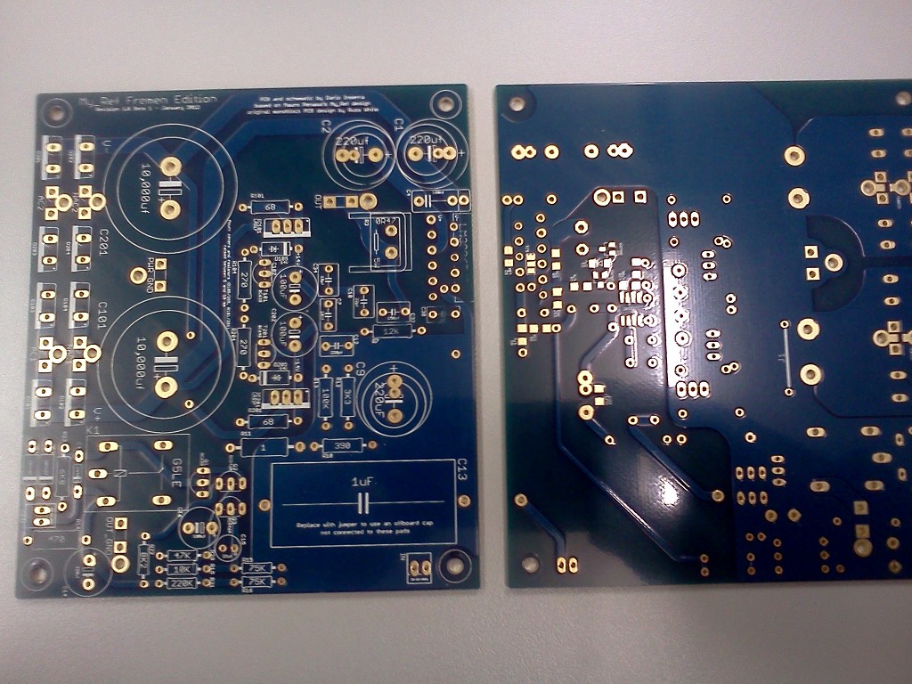

Today me, bmcbob and suburra tested the C9/R10 mod without reaching the full agreement on it.
One of the testers also had strange heating problems.
So the boards going to production will have, as default, the original C9/R10 arrangement but I've managed to make possible also the modded one at the price of omitting C21 (C9 optional bypass).
attachment.php
This is the last call for opinions, comments and suggestions.
Tomorrow I'll order the boards.
  • My_Ref_FE RC - Schematic.pdf
Dario,
Sounds like a great solution. Thank you.
Regarding C21, can you discuss what it's function was? why it was optional?
Also, would it make sense to add C21 by wiring point to point in parallel with C9?
None of questions are intended to change the board design. Just curiosity. And maybe some thing to try on a beta board while we wait for the RC boards to be manufactured.
I'm getting excited with the ordering of the boards.
You're welcome, Jac.
C9 is one of the most critical cap (soundwise) in this design.
Mauro himself suggested to try a bypass to improve C9 performance.
It was optional since with Black Gates bypassing is not recommended and also for other caps bypassing is a mixed bag.
For the my ref I've empirically found a best value of 22nF but as for every bypass you often improve some aspects and worsen others.
Maybe, it depends on the particular capacitor used.
Me too... 😉
This last hours before the order are frenetic, lot of tiny details to verify...

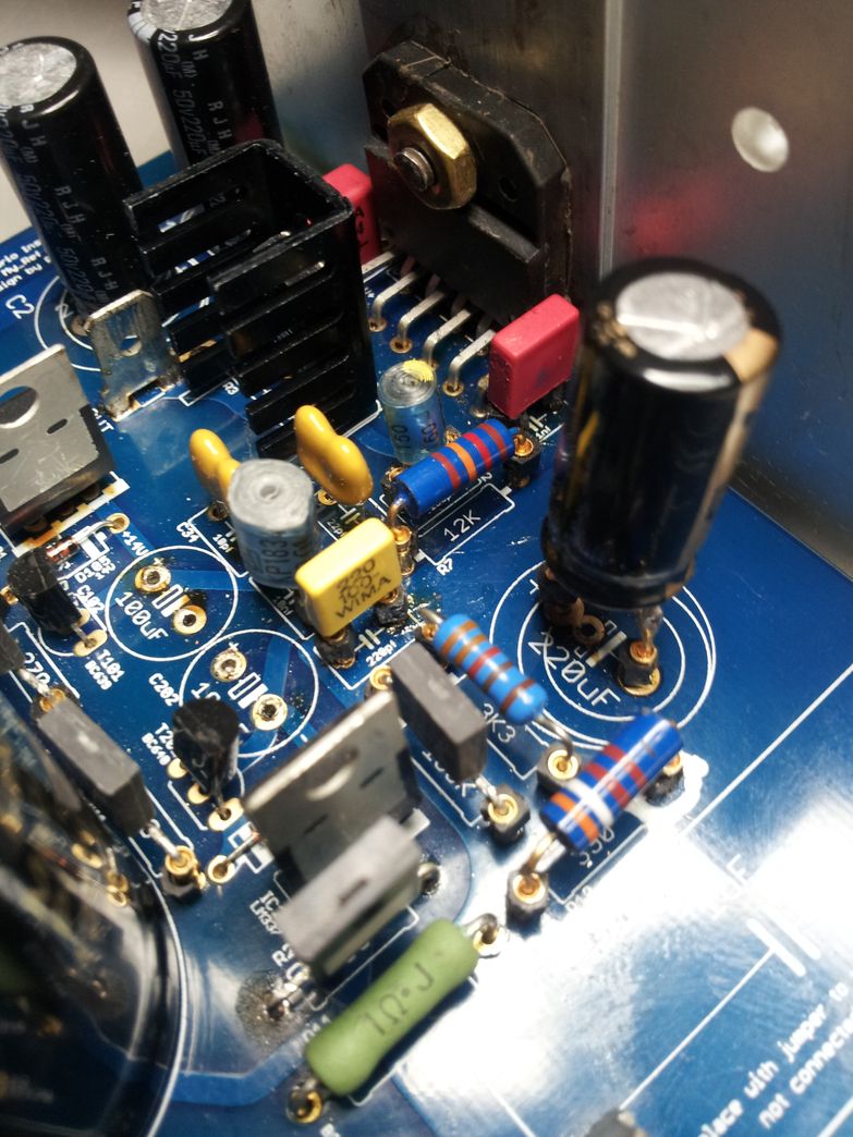

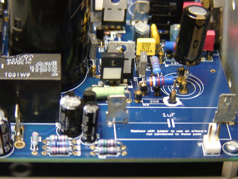

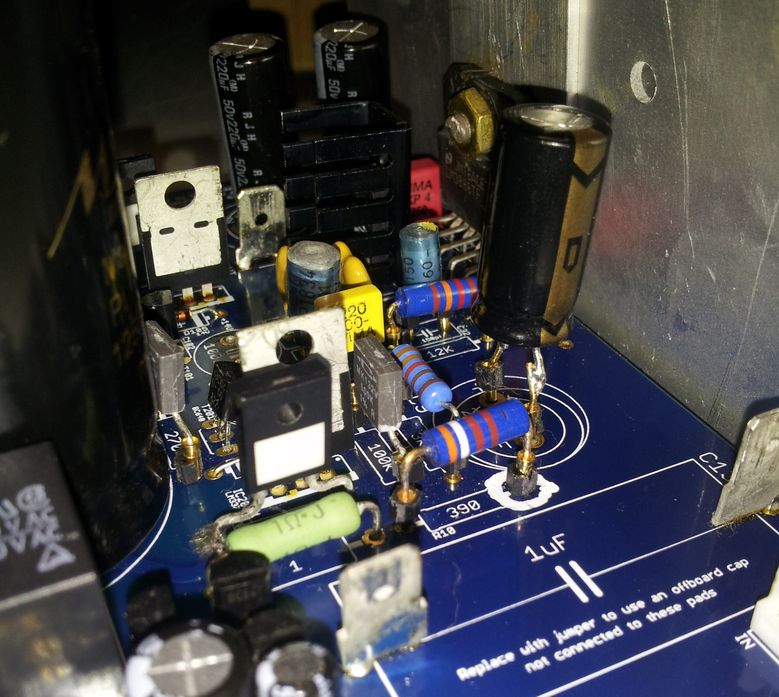

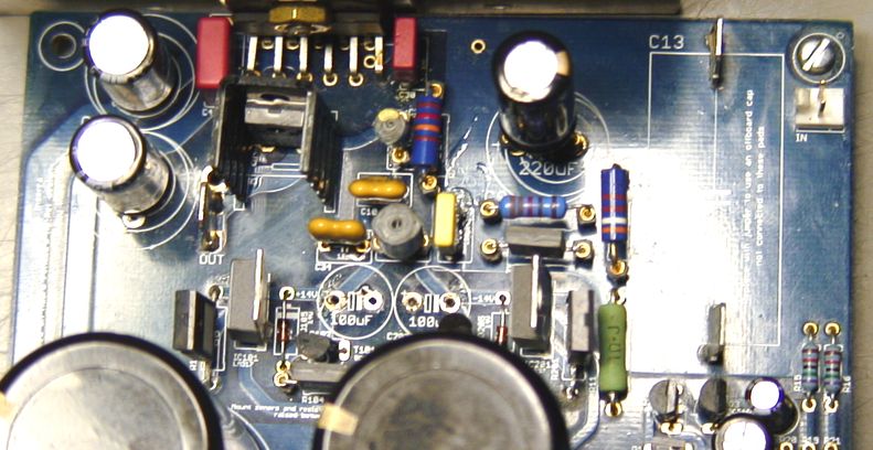

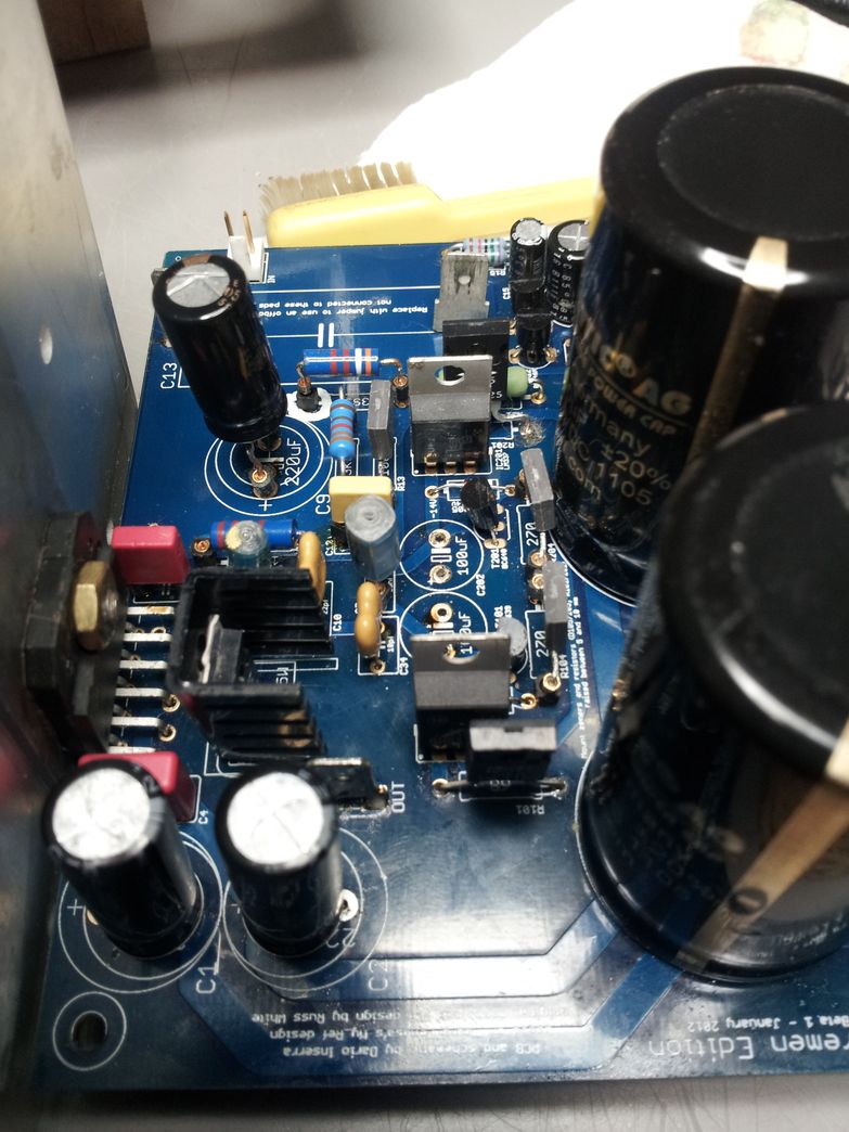

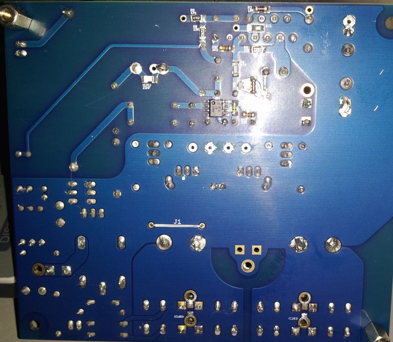

Here is the rest of the story.
I’m the odd man out with my test results. I had trimmed the leads on the Blackgates too short to reach the span of the sockets for R10. I did a jerry rig by extending them with some leftover Renkin wire. When I initially heard the sound of the new positioning, I was quite impressed. As I normally don’t trust what I hear till after a 30 t0 40 minute warm-up, I left the room and let the music play. Within two minutes I heard the thermal protection start to trigger.
I shut down the amps and got my IR temp gauge. The second try produced triggers on one amp at ~ 72-73, while the other gets up to 81C or more. There shouldn’t be that much of a spread between the two. Both amps were triggering even with the difference in temps. I then let the amp cool to room temps and tried again – this time watching the temp rise while listening. The sound could be heard to deteriorate as the temps went up, and again both amps started to trigger.
I then reset the positioning to the standard/original configuration. Everything cleared up and the temps stabilized. I could play several tracks with no problem.
Reversed the placement again and the heating problem reappeared. The sound was never as good as the first time I tested the new positioning and the sound was truly awful. The reason I didn’t make it through a single track though, was the triggering not the sound quality. What I could hear was thin, scratchy, and loaded with distortion.
Back to the original and they played with perfect operation for the next four hours.
Dario’s dual placement option is a good solution, but we really need more than the two existing builds in order to drill down on the problem. Also, if anyone has the simulation software to test the alternatives, that would be very helpful.
I should also mention that I installed the Caddocks as per the BOM at R13 and the results were stunning. That Caddock really made a big improvement. The sound is sweeter/warmer and the clarity seems to be better. The stage sounds more real and the cymbals sound less metallic and have a thicker character. That’s a really significant position.
Here are some photos of how things stand presently. If you see something - say something.:magnify:

C9 is an electrolytic capacitor, basically these operate more linearly when there is a DC bias across them. C21 is an option to improve linearity because in this circuit it seems that C9 does not have DC across it.
