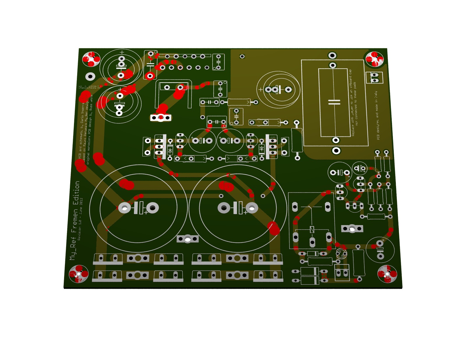

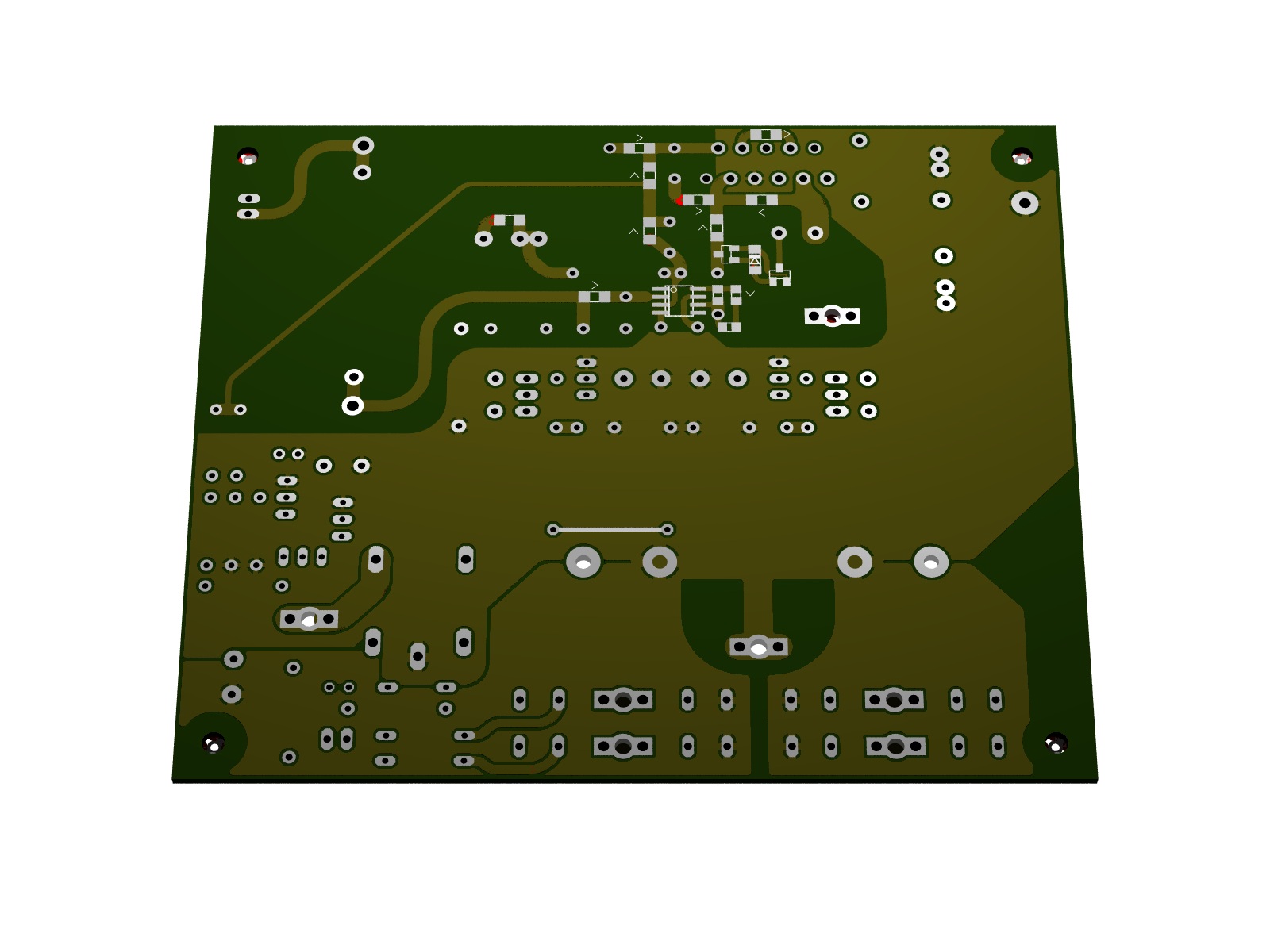

We have a last minute new partecipant: romvise (Italy)
Ready for production?

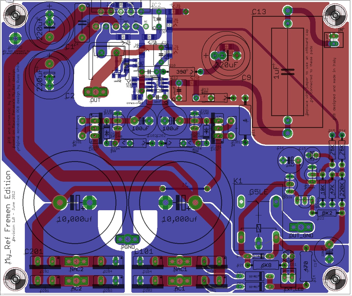

I've quite finished the optimization and refinement of the PCB:
This layout includes the C9/R10 mod (I'll try it Saturday/Sunday).
Any comment?
Any comment?
The small arrowheads on the bottom correspond to polarity by reading the lettering from left to right - correct?
Exactly.
I've yet to verify howland pump resistors orientation.
The PCB is also optimized on most pads with round corners, smooth transitions and some teardrops according to Metal's suggestions.
I've also received from Suburra confirmations on most polarities and BOM choices.
The Google folder has been updated with all relevant files and BOM which includes the modified C10 (from SMD to TH).
Latest PCB layout.

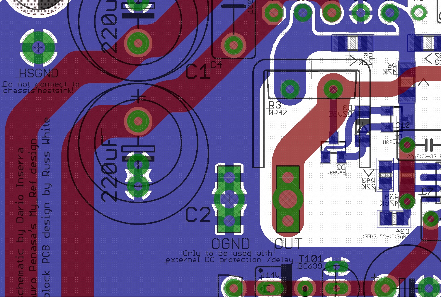

KSTR asks whether the speaker cabling loop area has an effect on the sound quality.
I will guess a "yes" answer to that.
Look at the OUT terminal. It has a lot of space around it and it has a Ground Plane right next to it.
Move the OUT terminal to the right to use that spare space to the right.
Fill the now empty space to the left with your extended ground plane.
Solder a Speaker Ground Terminal (Speaker Return) in that new ground plane close to the OUT terminal.
Now listen to the two versions. One using the original Speaker Ground Terminal on the relay section of the PCB and this new version with the OUT and Return next to each other.
If the builders agree that the Speaker Return sounds better than the Speaker Ground Terminal you can look at moving the relay to the Speaker Return area.

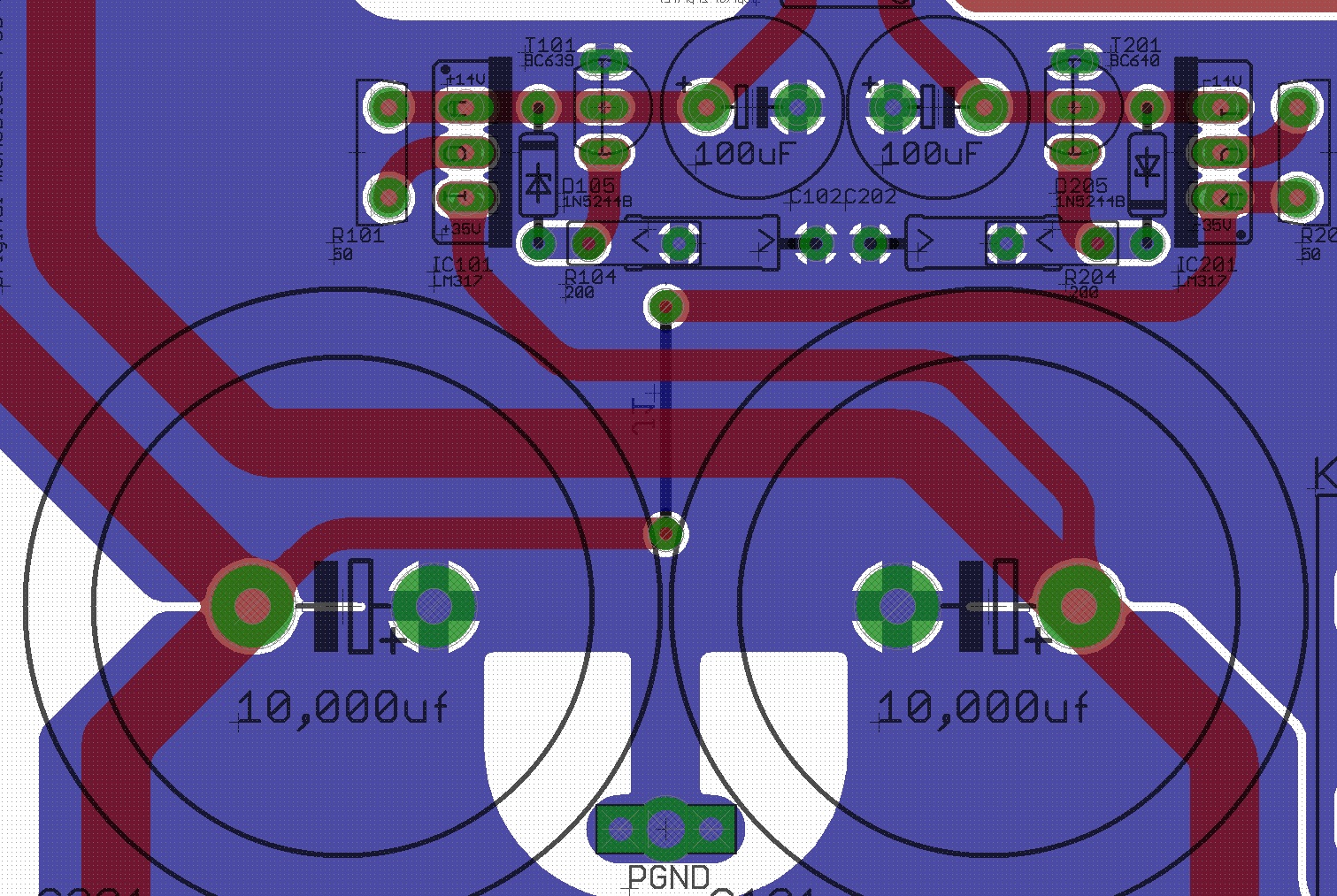

Jac

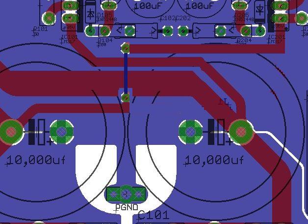

It looks like a jumper is under C101. If so, it really should be moved, maybe like this:
It's pretty easy moving it:
But I would like to understand why you think it's better to move it, because it's on the ground return path?
Can you elaborate a bit?
Thanks in advance
I guess it's possible...
Something like that, right?
It's nice idea but it could be a bit misleading... in practice it's a DC protection bypass...
Doing that move would imply that the output trace going to the DC protection circuitry would necesarily cross PS traces, is it a good idea?
None of the My_Ref PCBs, including the MY_Evo, do that.
if I am looking at a surface mount resistor and the label says 220, the arrow on the board points from the 2 toward the 0. Do I have it correct?
Exactly
Compare the new Return location to the old Ground location, FIRST.
Then decide if the relay needs to be moved !!!!!
If it turns out that KSTR's concern is well founded, the relay can be located any where on the PCB, or even off the PCB and you just run a pair of wires/traces from the detect and trigger circuit to the new relay location. What else are you thinking about? I can't imagine.
Compare the new Return location to the old Ground location FIRST.
I do agree that having speakers ground return in this new position would probably be both neater and in general better.
Nevertheless the beta PCBs sound great.
The only viable solution, IMHO, would be the external DC protection, we talked about it also in design phase.
By now it's a bit to late, probably we should wait Klaus'tests to verify if it's really a problem or not before doing such a radical layout change.
Release Candidate boards will ship with the classic DC protection on board.
We will approach again the possible problem in a future 'Fremen Edition II' but, maybe, I'll introduce a new approach to the DC protection based on MOSFETS instead of relays.
I'll get back on my soapbox again buy saying thanks to all who have contributed new and valid ideas to enhance the performance of the Fremen Edition. A subsequent version looks very promising indeed.
IMHO, let me suggest that getting this BOM and PCB into the hands and systems of as many builders as possible now, will only give more validity and agreement on future changes. There is always that ever present "why should I do this when a better one might appear?". That's a personal choice, but let me suggest nothing will replace hands-on experience and field testing for zeroing in on significant improvements. Six to eight months (or more) of the kind of interactions that have occurred in the last several weeks sounds like a very exciting prospect to me.
It's a mechanical issue, not related to the electrical layout. The version with the jumper under C101 requires that in assembly the jumper must be installed before C101. The jumper wire must be trimmed flush with the top side of the board so the wire does not touch C101. Then the area around the jumper vias on the top side of the board needs to be cleaned with alcohol.
All this can be avoided by just moving the jumper. Then solder flux will not be trapped under C101 and the jumper cannot poke a hole in the bottom of C101. It's good practice to avoid placing vias under components, especially capacitors.
Thanks, now it's clear
