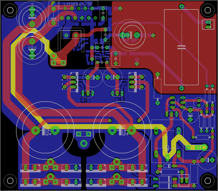

As for speaker return current minimized loop area, see pic for the strategy (which is simple : keep send and return lines together). This is done by wiring at the bottom side of the PCB, no PCB change is necessary. Now it is drawn as a dead short, of course you must tee off the speaker send and return -- as a twisted pair -- at some point (but it does not matter where).
There is something non-perfect there, still : the run allong asymetric lengths of V+ and V- lines, as well as the too big loop area of the GND plane vs supplies itself.
Exact position would have to be found experimentally**) by injecting a magnetic field then moving the wire until lowest output is achieved.
But to fix this on the PCB, it would be a major workaround, a complete rewrapping of signal and power paths... resulting in a short but wide PCB where power/relay stuff is left of the LM's and signal is right of them, strictly adhering to the star GND principle as well....
This sort of things can be addressed only using a quite bigger board, I fear.
Limits given I don't feel it's a bad layout, is it?
**) speaking of which, I'm OK again and will continue working on the PCB tomorrow....

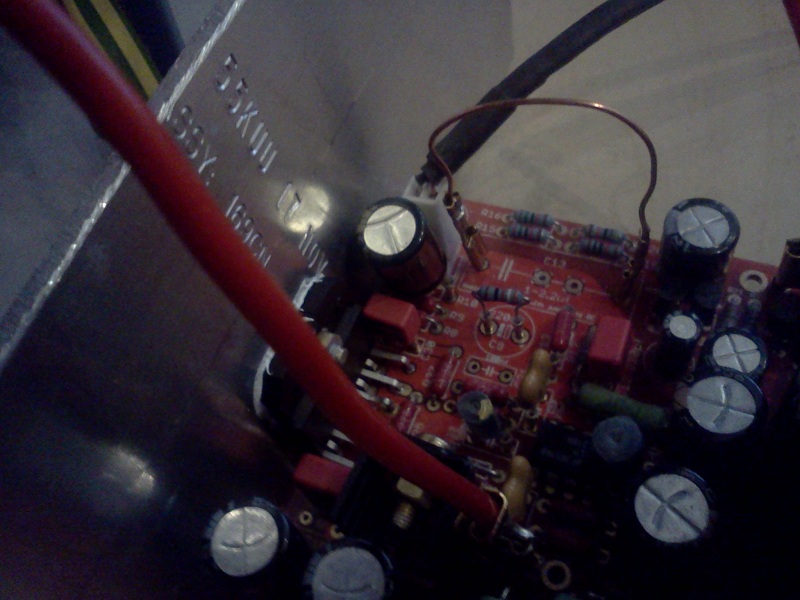

I've started to test the C9/R10 mod and for sure it sound different.
With the position reversed (C9 to ground) there seem to be a more contrasted, direct sound with wider and deeper soundstage and tighter bass.
The classic arrangement seems more 'soft', maybe confused.
So far I would say Klaus'mod is effective in improving sound but I'll decide after listening again tomorrow... I don't want another ceramics debacle... 😉
That's interesting, as there does not seem to be a technical reason for the sound change other that different interference (well, self interference maybe). You used the same identical two parts and just temporarily resoldered them with swapped positions?
Remember it's series connected parts, it's a black box with two connections only, no way for the current to change or "escape" other than by interference of some sort (which, OTOH, would have to be gross to be that effective).
I would think it could be same total area or even smaller, there is quite some unused area on the PCB right now in the PSU section.
No, it is not a bad layout, no need for headaches here. But it might not be the best possible (with the definition of "best" being a variable as every designer has his own preferences -- it's more about best compromises, in the end).
I'm using sockets, the very same reistors and identical, but two different pair of Panasonic FM.
attachment.php
Tomorrow I'll try with different caps and I'll use the same pair.
Maybe in the next days you can draw a simple schema, in this moment I can't figure how you would do it.
I'm sure it's not the best possible layout! 😀
In fact it's my first layout at all... and I'm not a professional too 😉

BTW, did you give the 220uF caps some re-forming time (1hr at rated voltage) before usage? If not, that could explain some of the differences you heard.
Both pairs were brand new with same date code.
Tomorrow tests with the same pair will resolve this doubt. 😉
