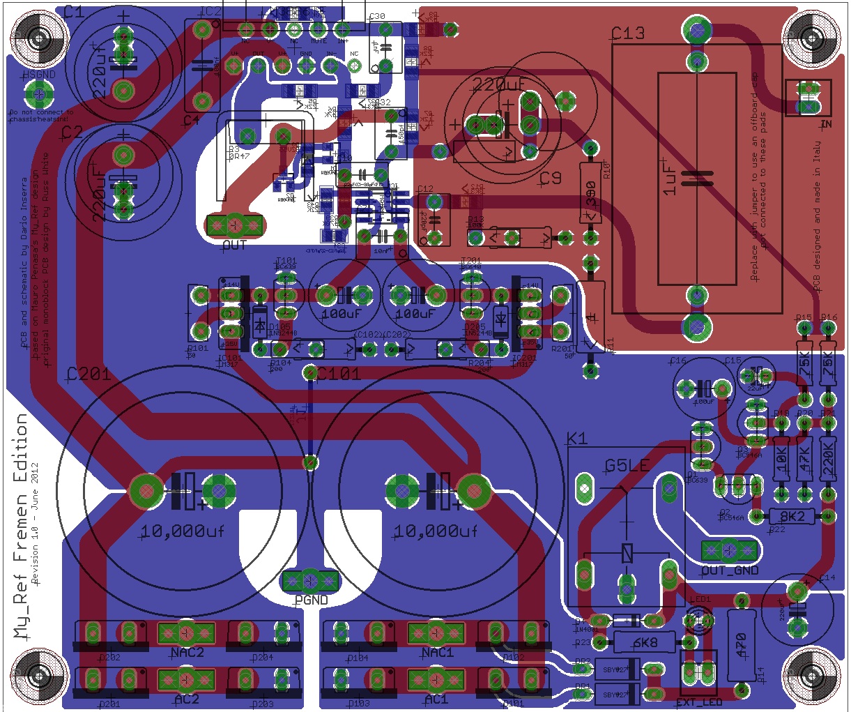

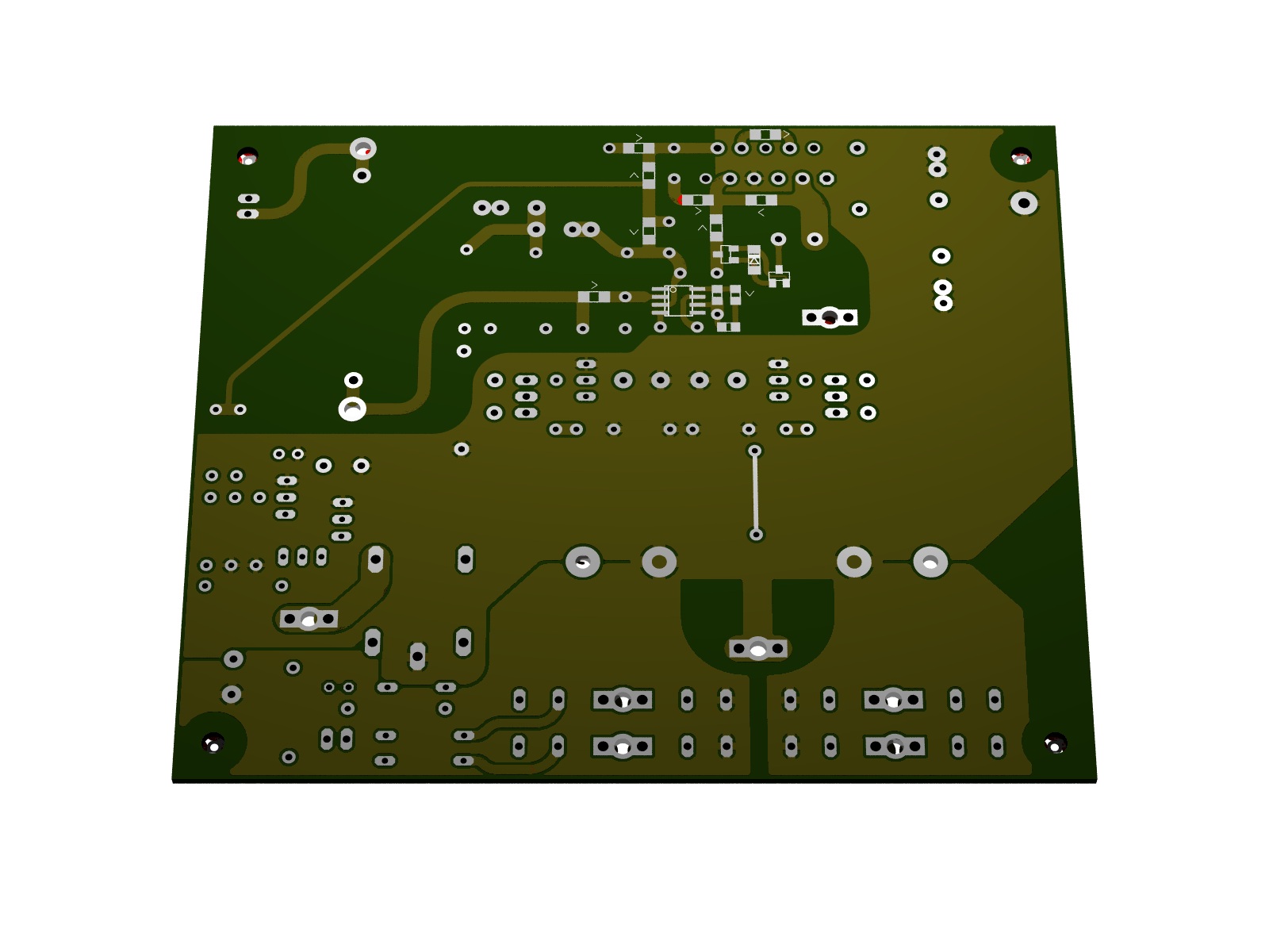

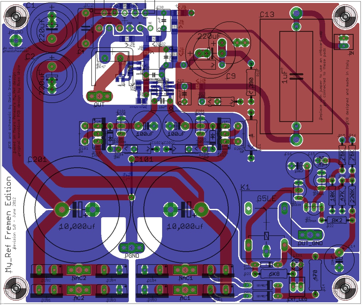

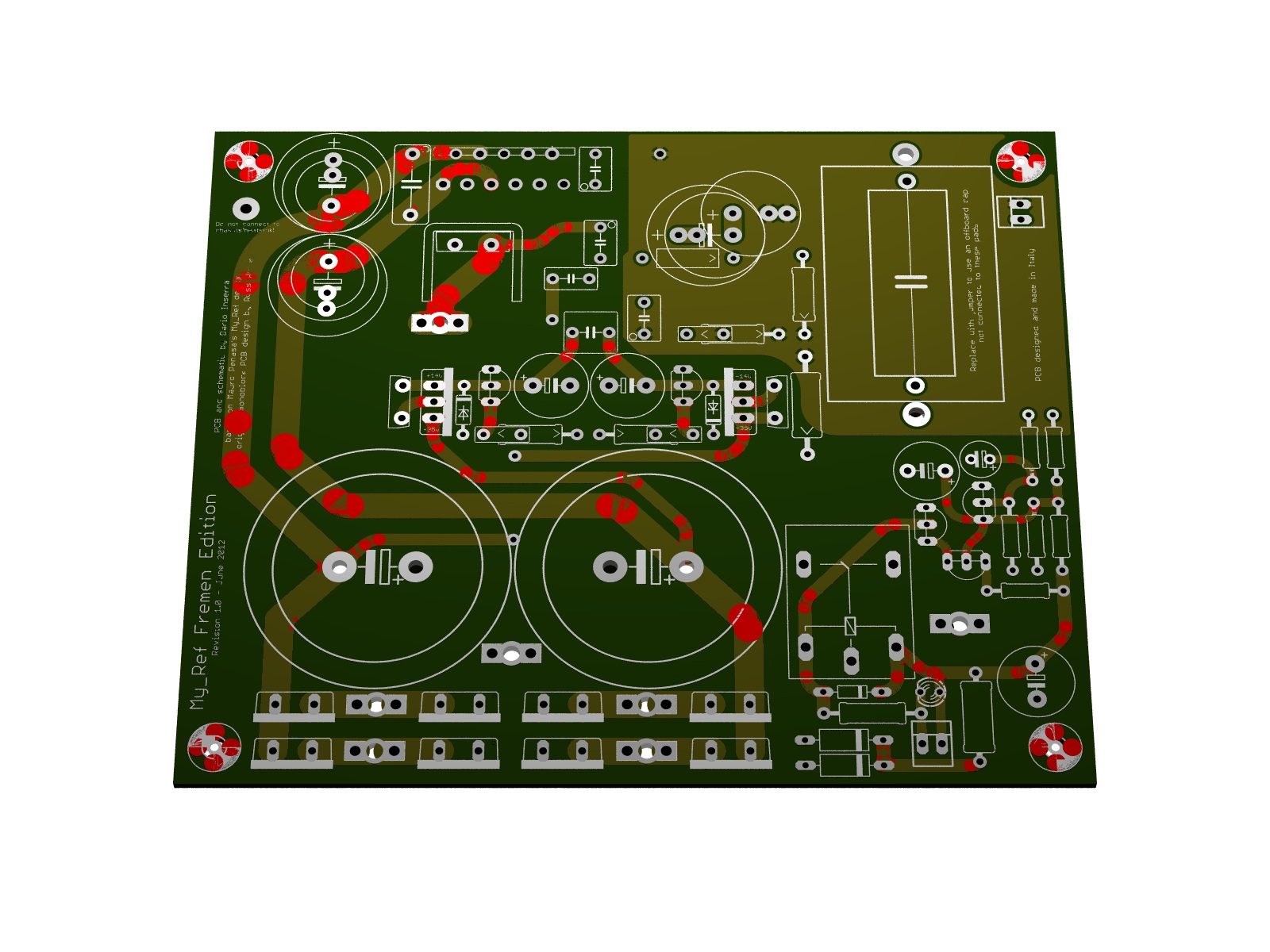

Final boards
After several hours (a real tour de force) of tiny details fixing and checking the gerbers I present you all the final boards:
attachment.php
attachment.php
attachment.php
I'll have a final check after one hour or two of relax and hopefully I'll order boards before midnight (local time).
I've uploaded all files (including gerbers) on the RC Google folder, if someone would do a double check in this two hours any help is welcome. 😉
I'm grateful to Bmcbob, Suburra and his batfriend for testing and to Metal for help in optimizing the PCB. 🙂
Thumbs Up Mr. Inserra.
Thanks 🙂

Great stuff, Dario. Now tell the truth, wasn't there the least bit of temptation to go forward with the C9/R10 swap to the new positions now that Bob has come along?
Thanks Jac 🙂
To tell the truth, no.
I think it's nice to have the option so all builders can try both configs for an extended time.
If a general agreement will be reached RTM boards will have only one of the two configs for layout cleanliness.

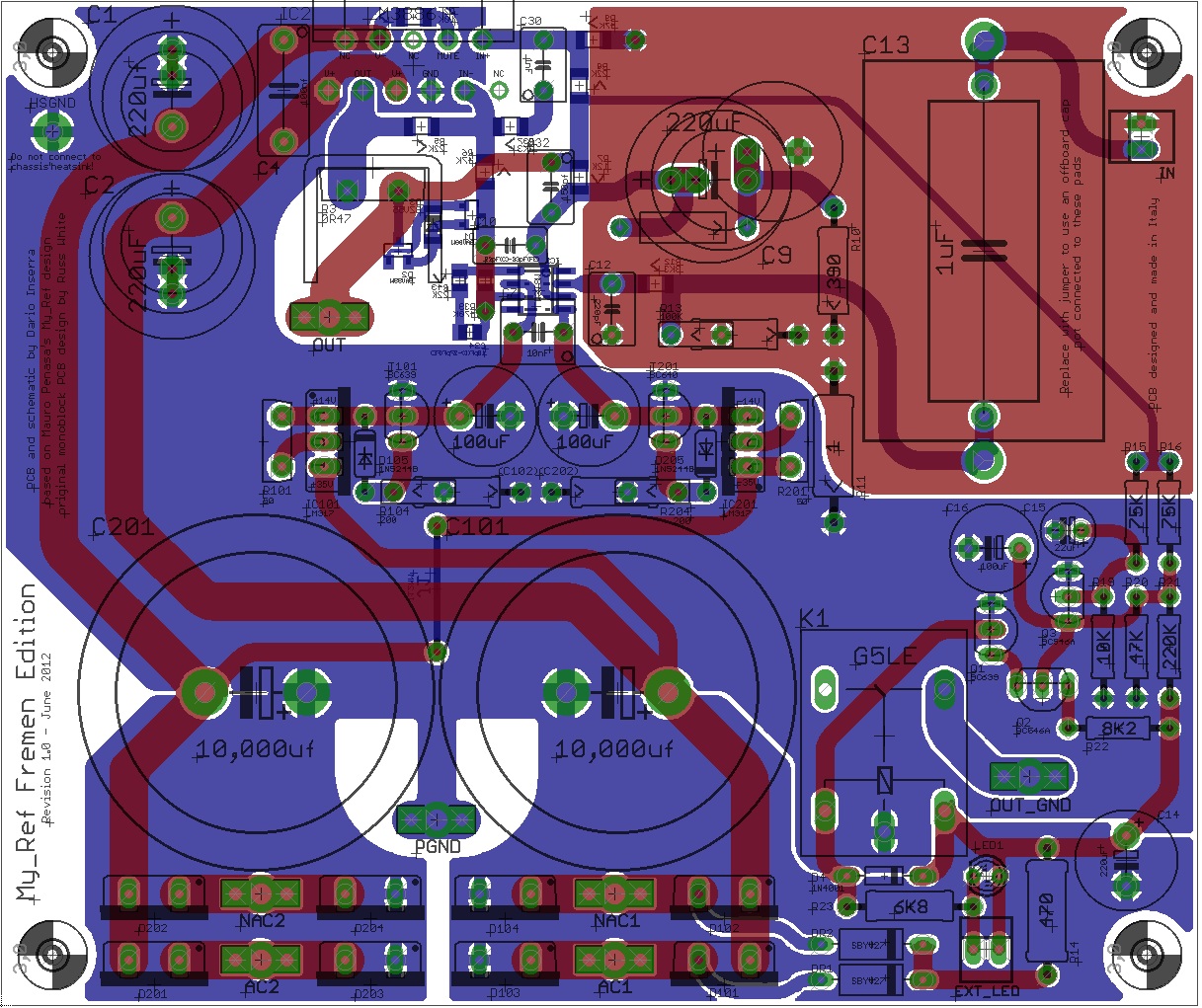

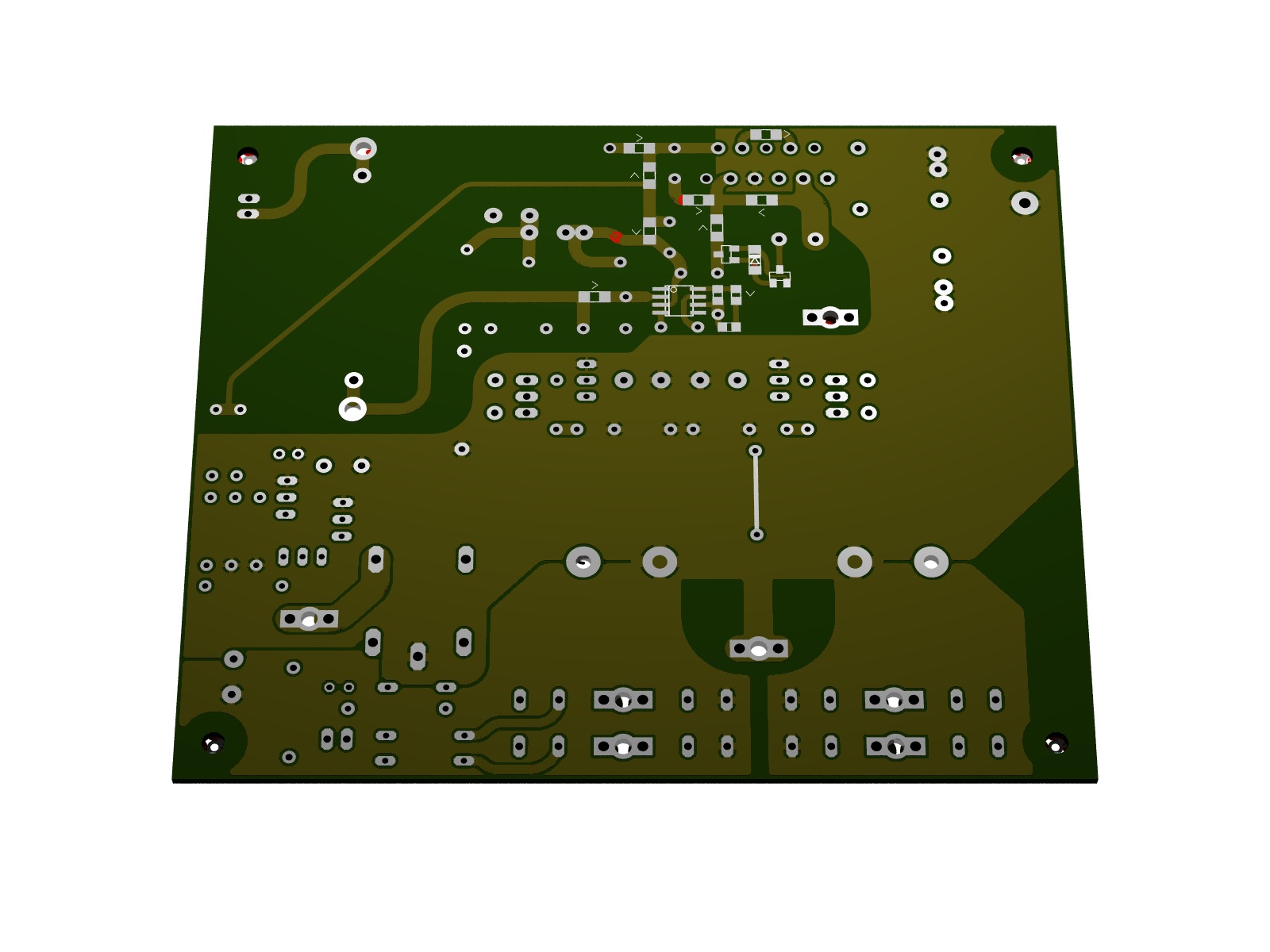

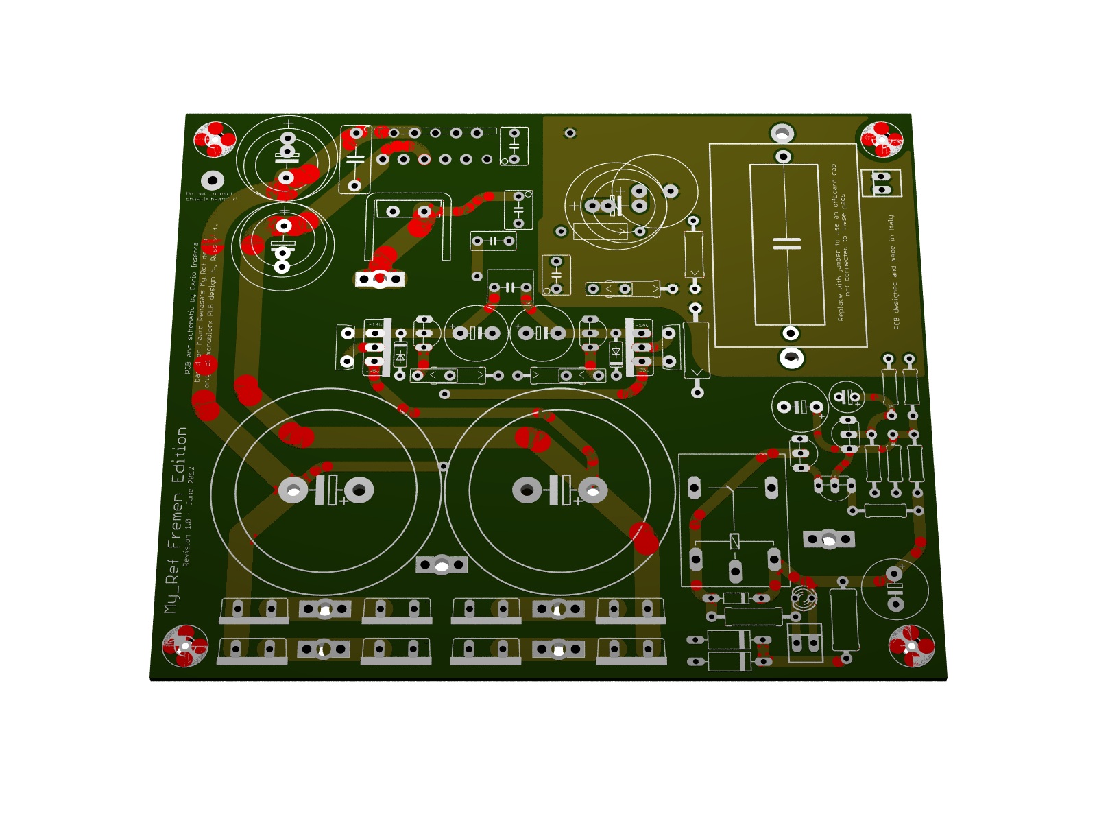

Sorry guys, 2:00AM here and I'm too tired to make the order, it was a LONG day and I don't want to make errors.
All is ready, including gerbers, all uploaded to the google folder.
If you get that R10/C9 swap in there, I'd like to get a set of boards too.
Is the alternate ground selection in the new board?
Hi George,
YES the PCB can accomodate both C9/R10 configurations but NO the ground selection switch is gone, it was part of beta boards and since the GND config was better is gone.
Let me know if you still want boards via PM.

Thanks for adding the mouser import tool column to the BOM. It makes the copy and paste process really easy. I am going to process my order later today. Does anyone recommend ordering anything else from mouser that is not on the BOM other than chipquick?
You're welcome. 🙂
While it should be all OK I've yet to do the final check.
I would wait a couple of day more 😉
Apart the Chip Quik kit (Mouser 910-SMD1NL) an interesting article to order, if you want to experiment, is the SIL sockets strip (Mouser 506-510-AG90D).

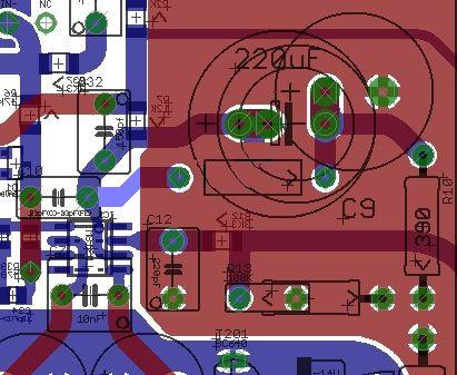

Also, regarding C9, I recall the lead spacing is 5 mm. What is the diameter of the pad on the board? Is that a via just left from the first C9 pad?
The reason for all these questions is that I'm thinking about trying something unusual for C9 on one of my builds. Mouser has a Niobium Oxide cap, 220 uF, 6.3V that I think I can find a way to fit. The specs are interesting, although I have no idea of how it will sound. Just out of curiousity, I'm looking for the next option when Black Gates are gone.
