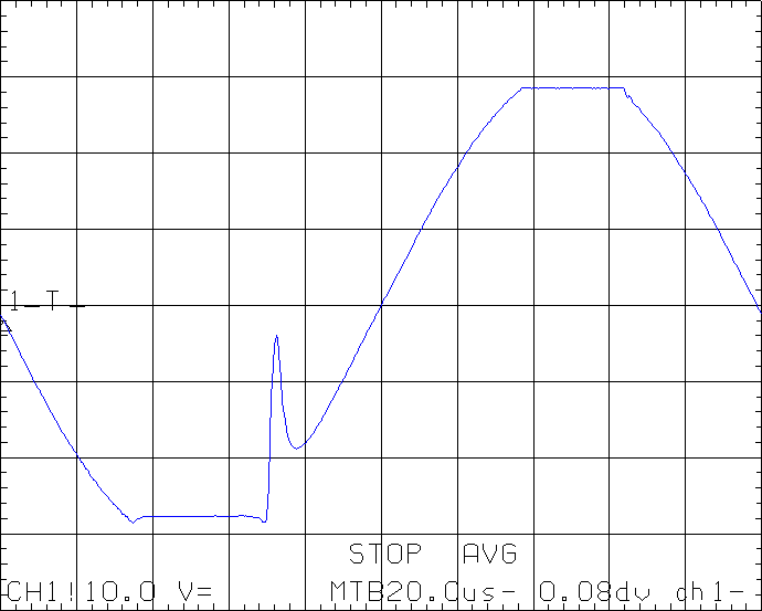

The dimensioning of the exact Zener value is affected by the following:The limiter, as I've later discovered, is identical to Penasa's My_Evo one.
The only goal is to avoid a destructive behaviour.
Since the LM318 is supplied with 14V rails shouldn't be the limiter fixed at 28V?![]()
a) the difference between rail voltage and Zener voltage. With unloaded amp, I found a safe difference of about 6V (33V rails and 27V Zener).
b) the amount of load current present. This will drop the rails a bit and will lower the margin. Further, a positive output current will make the LM318's output go negative and with a resistive load the output voltage will be positive, therefore the effective clamping level is reduced, the higher the current the more so. Since the dropout voltage of the LM3886 will also decrease with load current, this works in favor for us. With a purely reactive load the current will be zero when the output level peaks, so the clipping threshold will higher.
See following 'scope shots I made today, amp unloaded, 5kHz test frequency (for higher visibility). 10 Volts per division vertical scaling.
With slightly too low rail voltage (30V) :
The glitch on the recovery from negative clipping is very evidend. When going deeper into clipping, the glitch disappears and is replaced by severe rail sticking followed by a sharp transition back to the sine, sounding equally distorted as the glitch. With 4R load behaviour is very similar.

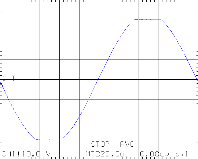

With 33V rail voltage :
Recovery is clean, only some small amount of rail sticking is seen on the negative recovery. Also, deeper clipping showed equally nice recovery.
The current through the Zener is limited by the LM318's short circuit current of 20mA. Because the Zener and the bridge are in parallel to C10+C32, any nonlinear capacitance will not have big effect. The bridge is effectively connected between two outputs.

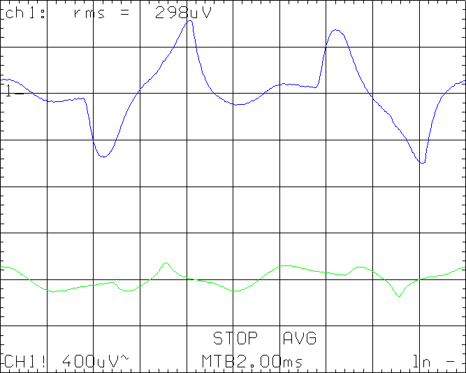

Finally, the ripple at the +14V line, with unloaded amp (bottom) and with 16 Watts (into 4R, 5kHz), 4700uF rail caps, reference against PGND :
(bandpass filtered from 10Hz to 300Hz to help the averaging, which also "killed" the 5kHz).
Unloaded, the ripple is a bit above 100uV peak, and loaded the peaks are 0.6mV. It is not perfectly clear wether it is dominated by the regulator ciruit itself or by I*R drops around the PGND node, but anyway is is quite low, the LM318 will be quite happy with that amount of ripple. Noise at the 14V lines will be dominating hum, it seems.
So, if I've undestood correctly with 33VDC rails all seem to work as expected.
We could say that also with the 28VAC secondaries suggested for 4 Ohm loads the 27V zener is adequate?
