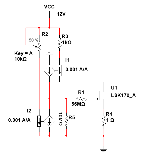

If I've drawn this correctly:
Looks right, just double check the polarity of the feedback and don't forget the cap that set's the dominant pole across R5. I think as drawn if the FET has too much Id the gate is raised in voltage which is backwards. Of course standard notation is backwards in the first place so we have a double negative. :)
I think so too, as drawn it's positive feedback.
It also doesn't model the fast-light, slow-quench asymmetry of the photovoltaic magic, but perhaps that's insignificant when C6 is added (usecs versus seconds).
